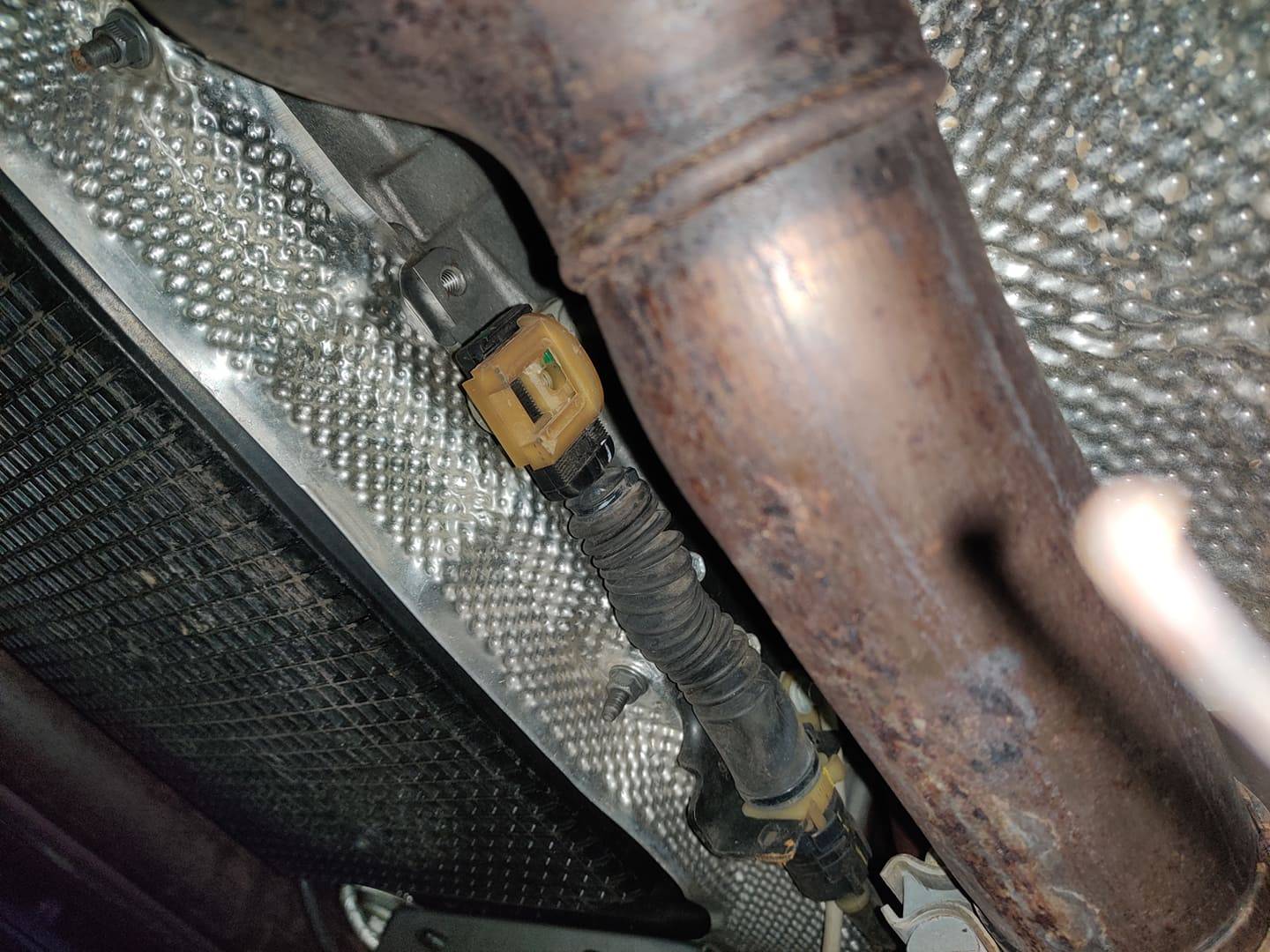

Hi i took the car out for a quick spin, come home and put gear lever in P but doesnt engage, asked a friend and he said he's had a similar problem earlier and told me to check the shifter cable clip beneath the car. I took a pic and sure enough I see the clip is broken.
My question is; Does anyone know where to buy a quality clip instead of this plastic piece of crap? Perhaps made of metal...
I only found this but its still made of plastic https://www.bushingfix.com/ford-mustang-shift-cable-bushing-repair-kit/
Also, I noticed this odd open hole right next to the linkage? Anyone know what it is cause it doesnt look right to me

That should be covered under warranty if you're still within the 3/36 or have an ESP. It *might* be covered under Powertrain since the linkage IS part of the transmission operation... If possible schedule a service appt. and see what they say when looking at it.
My guess is, as close proximity as the exhaust is, the heat coming off the exhaust is making that plastic part brittle and it will keep breaking.... via deterioration.
What does an unbroken part look like??
This is definitely a "new" finding with the 10R80, as I have not heard or seen this issue posted (yet), until now.

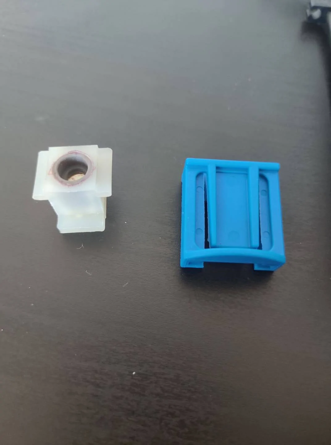

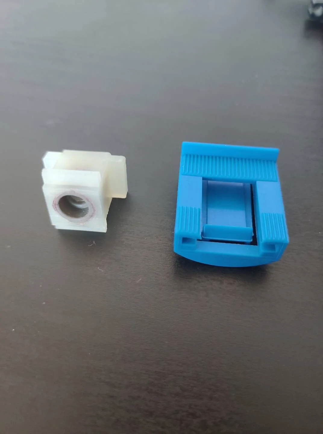

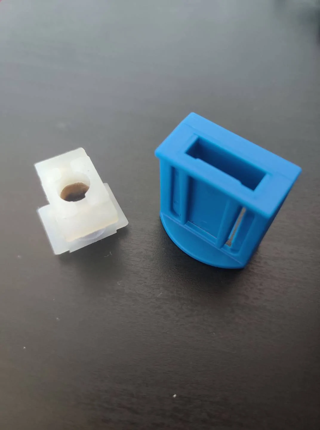

Yes I did get the part installed, unfortunately I completely forgot about this thread and taking pictures of the finished product.
However, I bought 2 of the clips from bushingfix.com, so I have some pictures here of the product, notice it's blue compared to the OEM Ford tan.

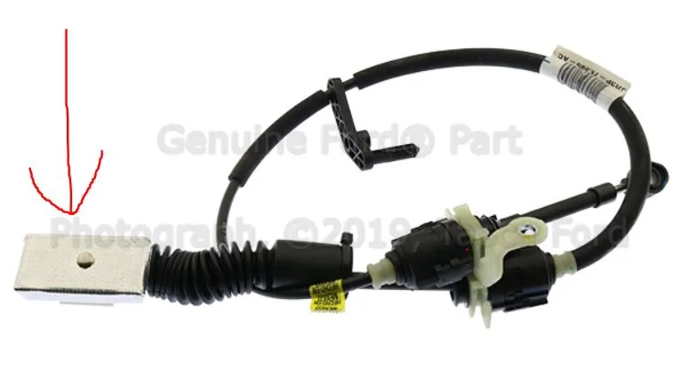

One more thing, I believe the very reason I experienced this problem is because my car had somehow lost the heatshield protection cover that goes over the clip. You can see on the very first picture that the OEM tan clip is fully exposed and it isn't supposed to be like that. So I bought a new transmission cable as well and took the cover and installed it as well, unfortunately cant buy the silver cover stand alone.
