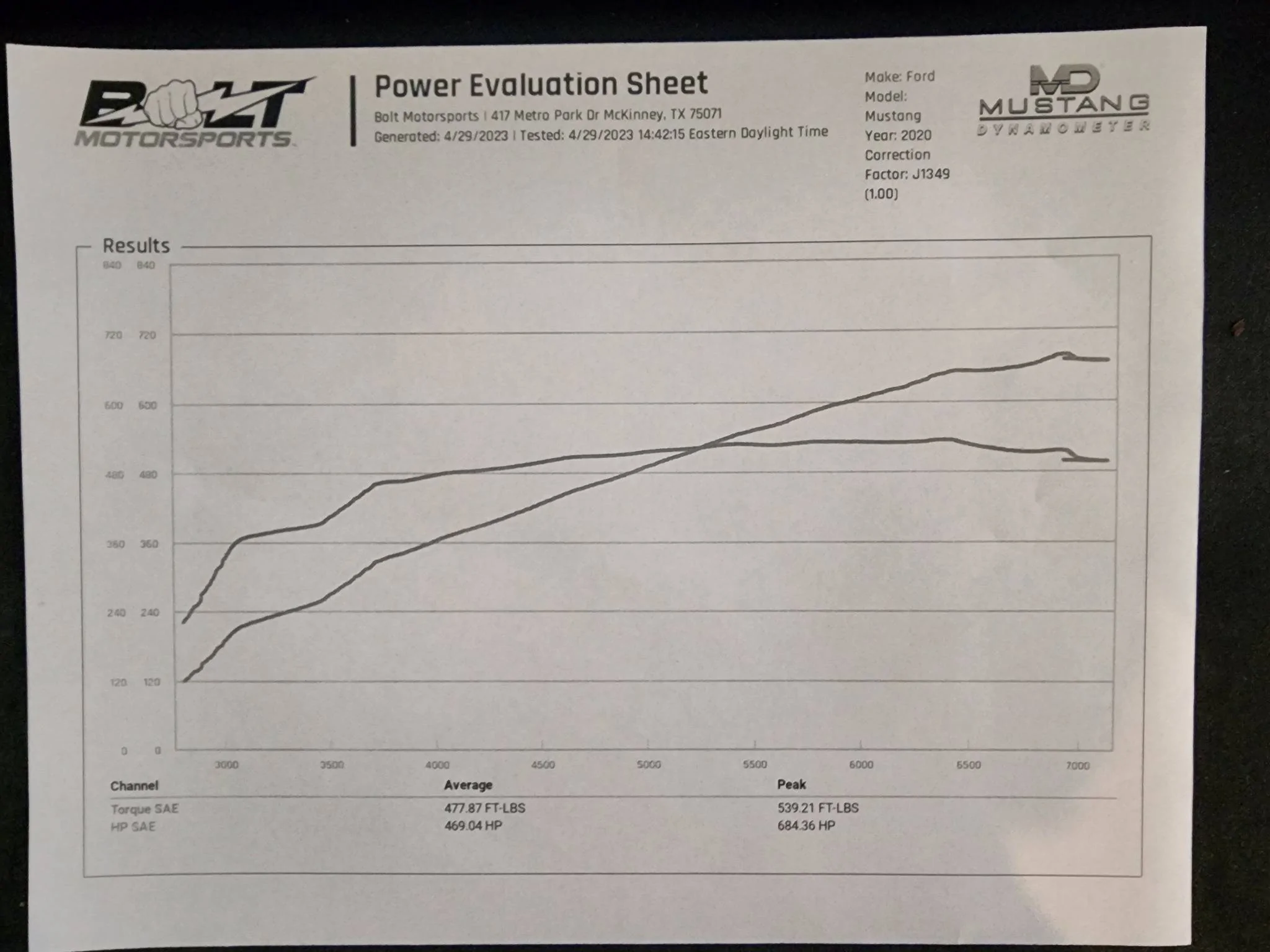

Mine was dyno'd in 7th gear and carried out close to 7000 RPMs before they started seeing some knock and let out (93 without octane booster). What could be the difference here?
The coefficient of rolling resistance’s speed effect is highly dependent on the tire design and how much damping it has inherent to it. Lower damping will cause less negative effect at high speeds.
