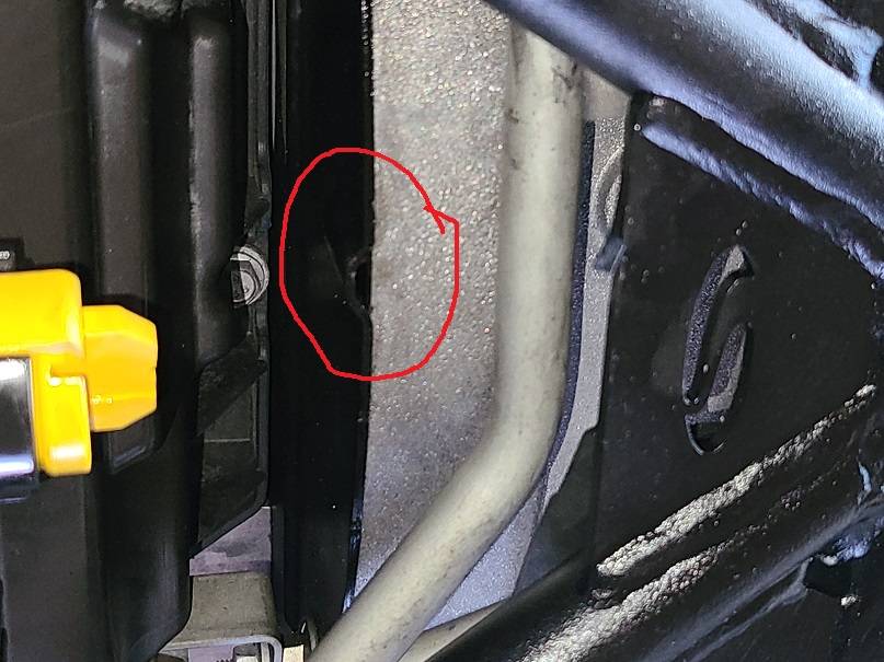

My car has been leaving small amounts of transmission fluid on the garage floor randomly after jacking it up and letting it down, and sometimes when it just sits overnight. I cant see where the drip is coming from but its near where the oil plug is. I happen to also have an oil leak but there are 2 different fluids one is oil one is red and I think its transmission fluid. Kind of looks like it is coming out of the front area of the transmission, the fluid seems pretty clean, could this be a torque converter leak? Anyone else have a transmission leak on 10r80 that they figured out and got fixed? The area I circled had a bit of the reddish fluid on it
Also, the steeda K brace touches those metal transmission lines, but it hasnt affected the transmission in any way and I dont think the metal pipes are where the leak is coming from. Still though, since its metal on metal I will be removing the K brace I consider it incompatible with 10r80 cars I suppose.

It could be Torque converter related.
Usually if there is any fluid seepage between the trans/spacer plate/engine - it's 99% of the time engine oil from the rear main seal.
Could it still be the RMS but trans fluid instead of engine oil - probably not likely.
Definitely make an appointment, because that should be covered under warranty (either the new car 3/36 if still applicable or if not, the 5/60 Powertrain).

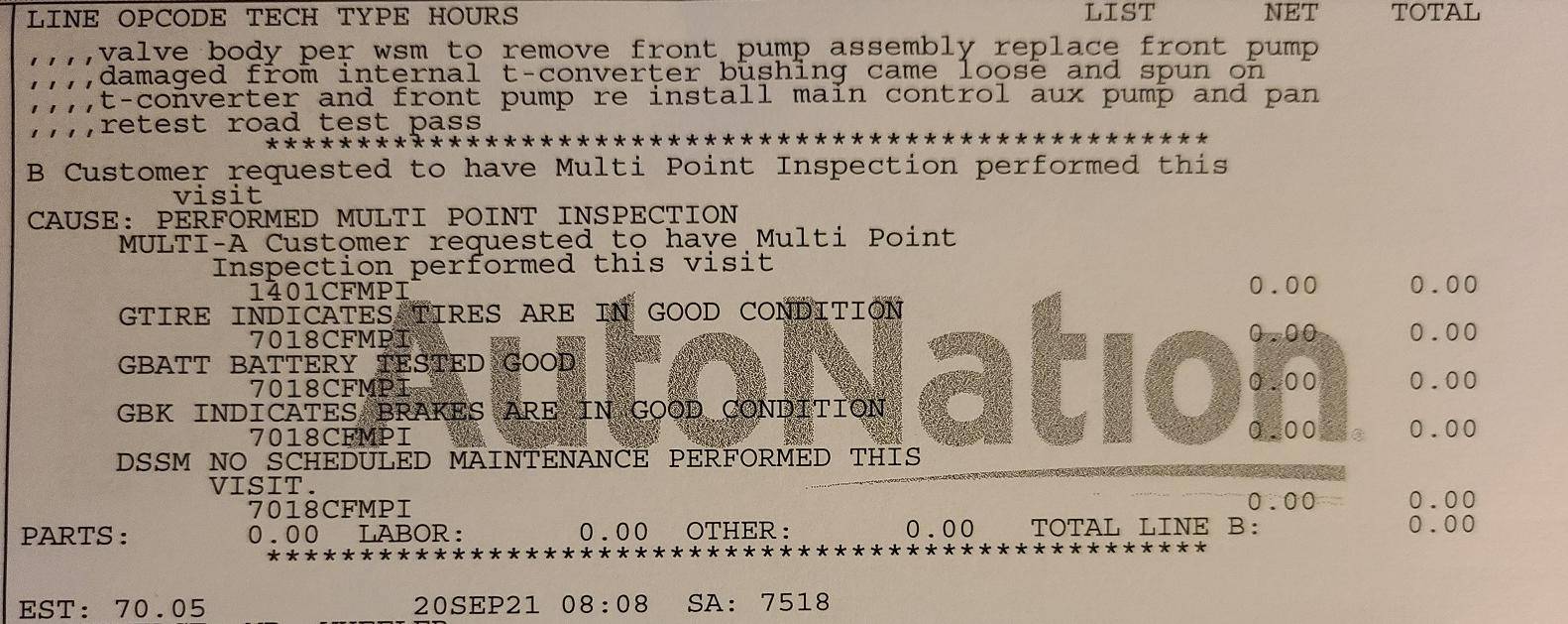

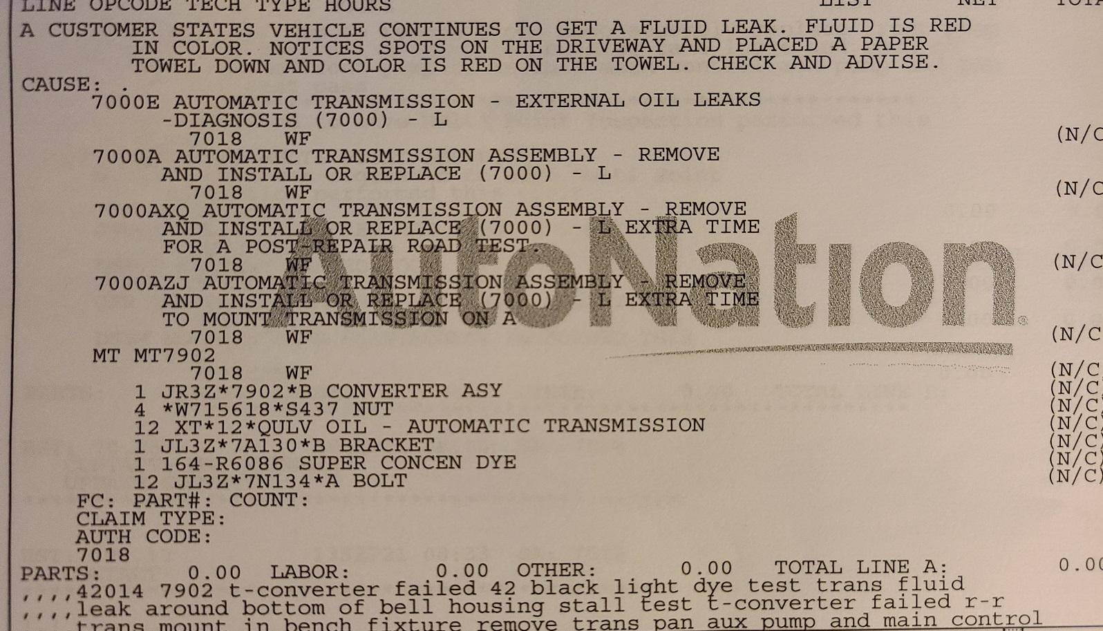

Here is what ford said about my 10r80 leak
"The failure was the bushing out of the torque converter came loose and found its way into the pump."
Going to pick the car up today I think ill let you guys know if it worked. I think they just replaced the bushing and any seals related to this leak.
The failure may have occured when I attempted a 2nd gear launch on the street. Converter flashed and I blew the tires off through 2nd, 3rd, 4th and 5th and maybe some of 6th gear ending at like 100+ mph with a 1/8th+ mile cloud of smoke, didnt really seem like much force going through the trans etc since the tires just spun though. Or it may have happened when I got some wheel hop or tire-on-wheel slippage at the top of 3rd on a sticky new road surface, I really dont know. There were no symptoms other than leaking fluid and I dont think the trans ever got above 220.
