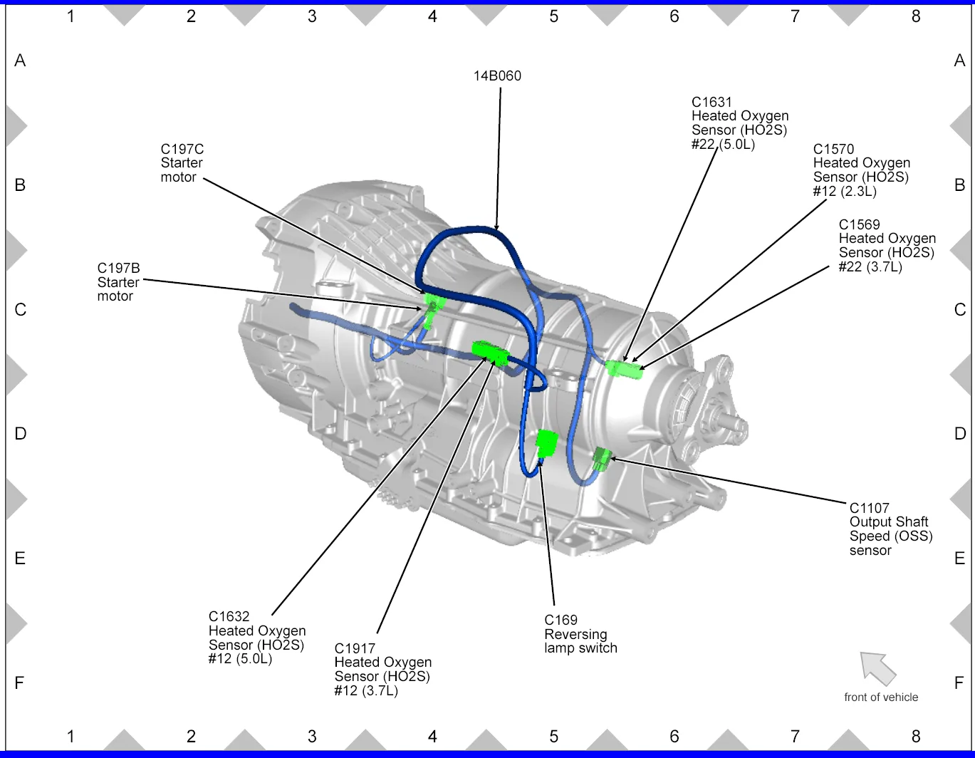

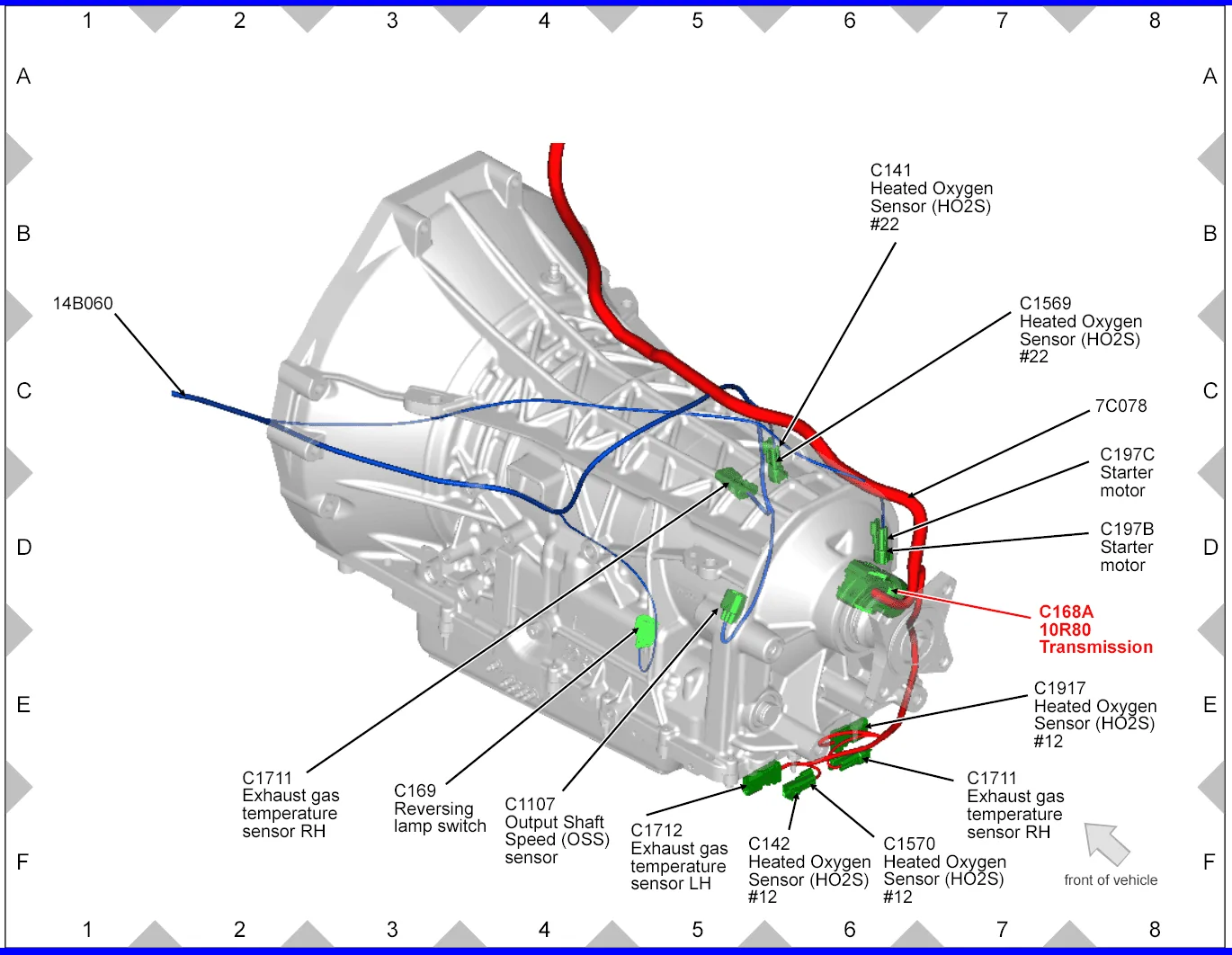

Connector overview.
6R80 top
10R80 below

The bell housings are different and 1 trans looks longer then the other..
Different angles and the bell housing is due to the fact that the overview of the 6R80 is from a V6 variant where as the 10R80 is a 5.0. There are no bell housing differences between the 10r80 and 6r80 5.0.
