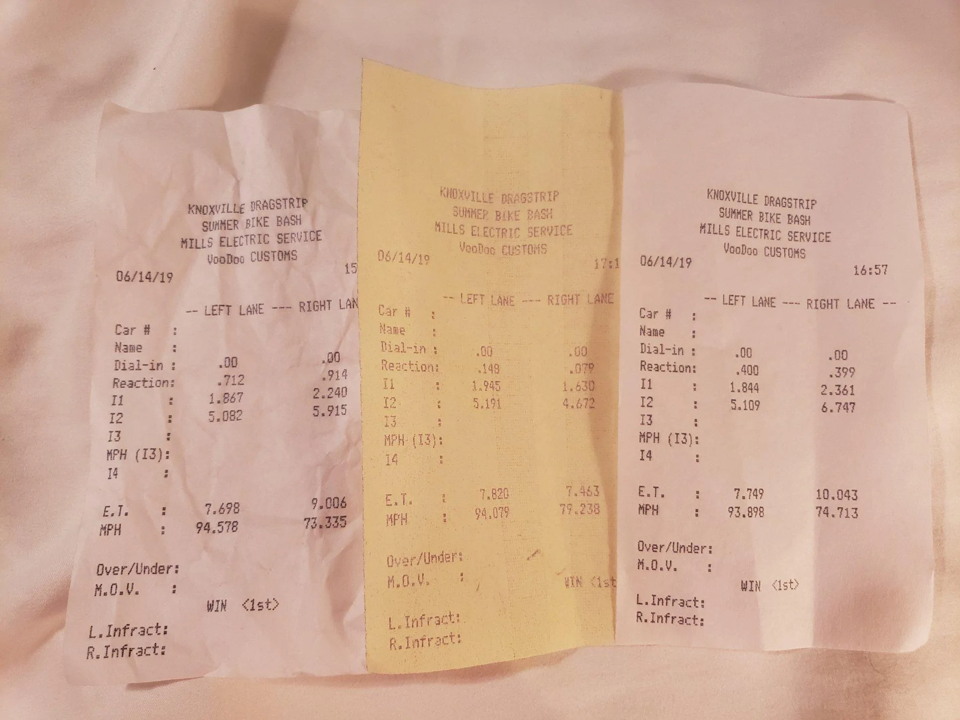

Just another "I went to the track" thread. Nothing real spectacular but maybe some advice would be nice. Kinda disappointed really. Time slip attached (Left lane) but best run was a 7.69 @ 94.57. DA was around 2200. Mod's are Kooks LT's, magnaflow Tru-x and Lund E85R tune, BMR cradle lockouts, 3.55's, M/T E/T Street SS 305/40/17. Traction control off, in Drive. Once I was up on the converter, I tried the E-brake trick and it worked ok the first time(best time) but the next time i got slightly more aggressive and blew the tires off. Never had a better pass than the first one. I dont know if I just didn't warm the tires up enough or poor track prep or both but I would have thought that I would be able to hook whatever I had with those. I was running 24psi and I did not try dropping pressure but probably should have.
I'm considering dropping to a 275/45/17 as that gets me under 26" where as I am almost at 28 right now. (And this change isn't to address traction but ET...assuming I get the traction issue worked out.) Thoughts?

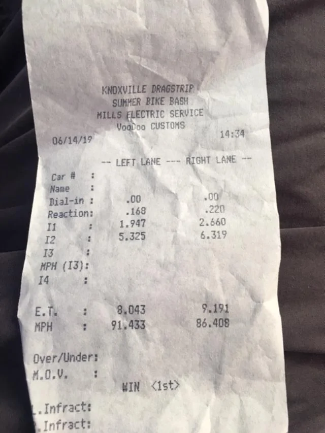

Your 60 ft is poo . I have run 7.20's at that track at 94 mph . You need to get the 60ft down 1.50. I had my bone stock 2019 Mustang Gt there and ran 8.04 @ 91.40 so your tune might be off . Have you weighed your car?

2019 Mustang , 1983 Mustang , 2004 mach 1 , 1992 Vanilla ice edition GT
Base model Gt 235 all season tires.
Hey, thanks for the reply! Pretty sure I saw you there Friday night. I popped in kinda late and had family obligations so I just didn't have alot of time to play around. Again, I think your exactly right. I just couldn't get the power down out of the hole. I think its mostly due to running air pressure to high and inconsistent burnout. (and a poor driver). I didn't charge my air tank with enough air to refill the tires appropriately to make the drive home on the M/T's so I went way too conservative on how much air I let out when I got there. No, I haven't weighed it...the question is, have I weighed myself...:crackup: As far as being down on power, I sent 3 logs to Jon Jr. and he said everything looked good (except for the fact that the 60 was trash). I reviewed the logs myself and I was getting 29-31 degrees so it wasn't pulling anything from TC or false knock. Like you and the others have said, I really need to get those 60's down.
