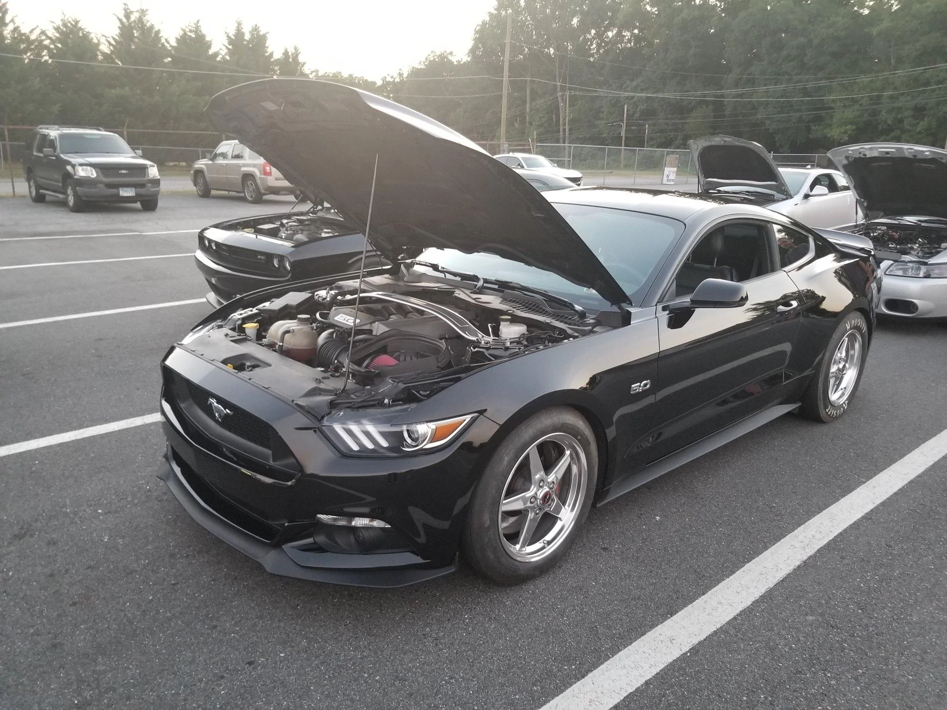

Indy 500's are incredible! They are the closest thing to a drag radial without being a drag radial. I have a set on my car now and they are absolutely awesome! Just having them will get you in the 12's no problem! When my car was NA with my pp2 tune they would hook up even in 1st gear on the street. Even with my current FI set up I was shocked with how good they hold traction rolling into it in 2nd gear, 1st is useless and so is 2nd if I don't roll into it. Doing the steeda stop the hop or BMR's kelly cocktail will take care of that wheel hop problems. Honestly though the best mod you can do for a manual is a set of bias ply slicks! With just a pp2 tune, slicks and skinnies I ran a 12.01 @ 115 mph! After upgrading the axles and irs I felt confident leaving harder and got a 11.86 out of her. I'm curious to see how my new set up performs but I have a feeling I'll be doing another round of mods because the edelbrock tune is really consivitive. Sorry for the long post but thought you might be interested since you basically have the same car as me. Good luck and have some fun banging them gears!

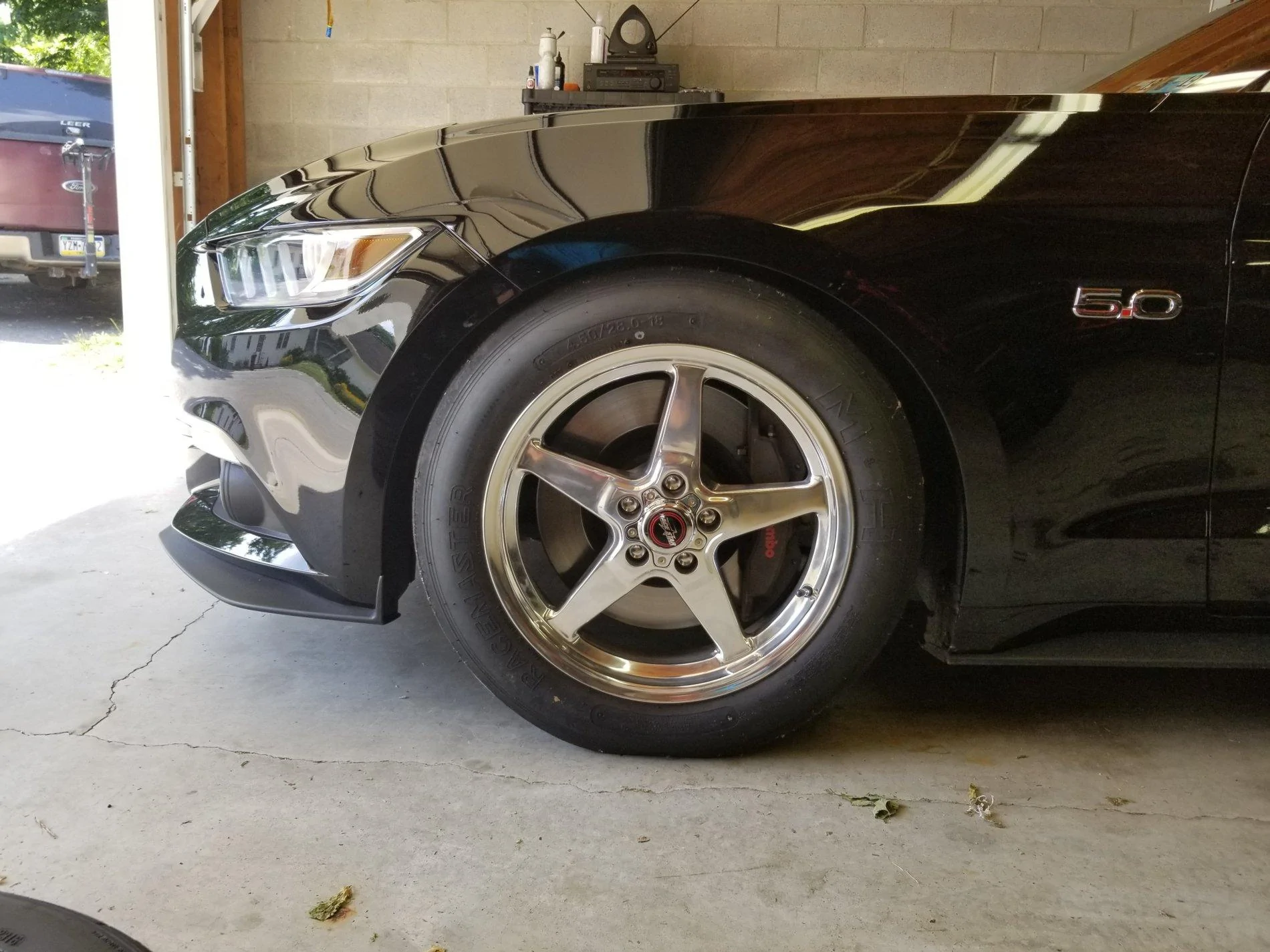

Which bias ply did you run? what size tires/drag wheel setup.

I have race star wheels with M&H 4.5/28-18 up front and Hoosier 28/10-17 in the rear. I think I'm going to try MT street r bias ply since there DOT and supposedly hook better and have less sway.
