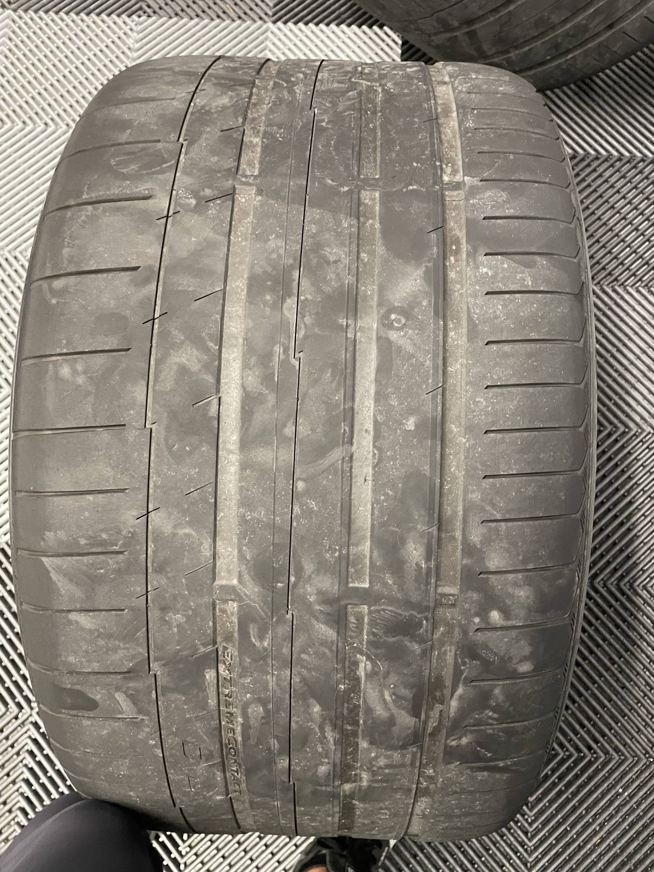

Adjustable camber arms are a life saver on this car. I literally got my SPC arms installed this weekend and doing the alignment now. Having said that, negative camber is not an enemy of the tire. If you're getting extensive inside wear, you need to check the toe. And keep in mind, one influences the other on the rear; in other words, cranking out a chunk of camber will change the toe. I'll post a picture of my tires off the rear with 18,000 miles and -1.2° camber, and you could not have a more flatter, even wear.

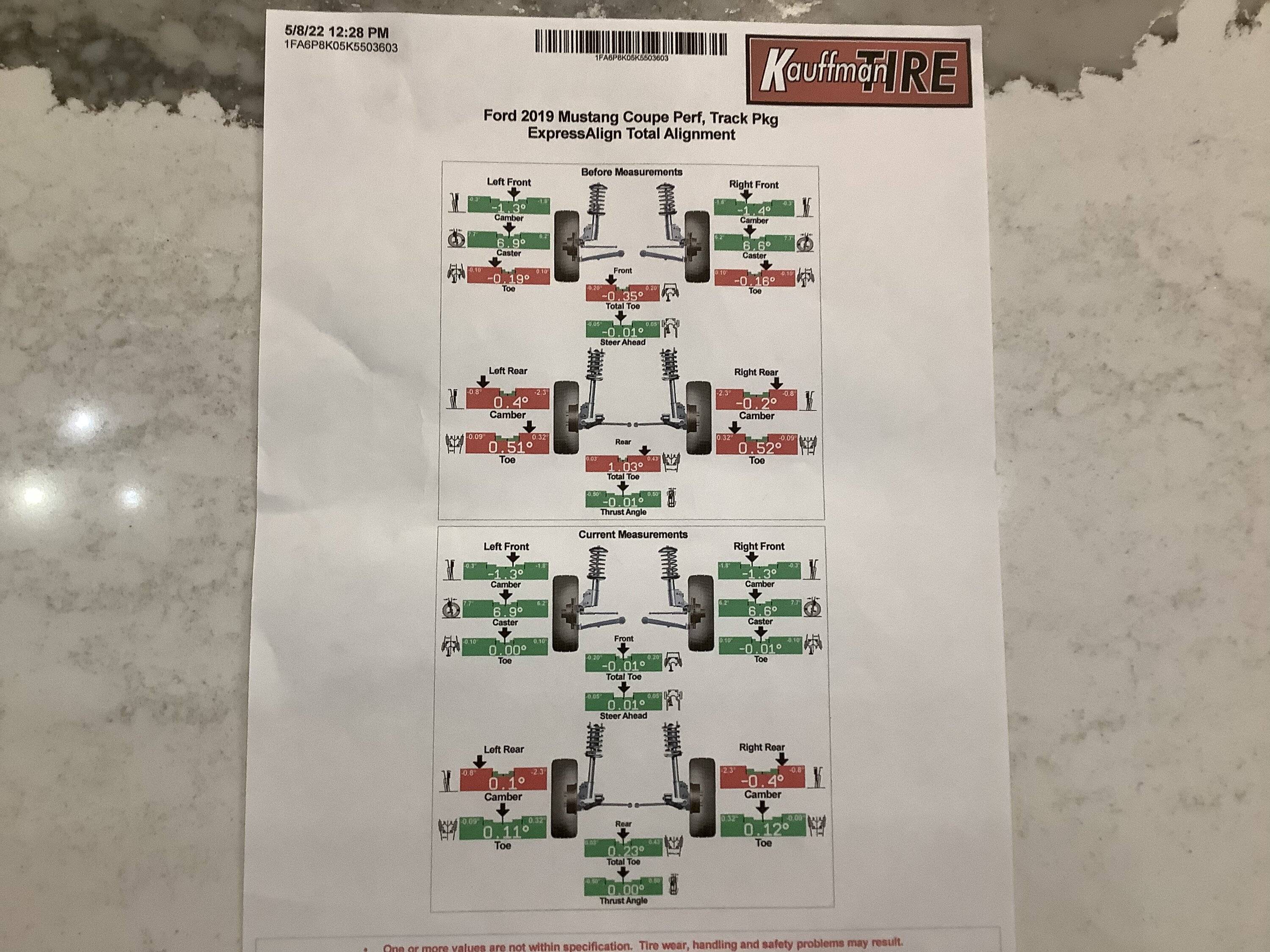

Here’s my alignment sheet after I installed the Steeda adj. camber arms, toe links and BMR camber lockout kit. This was as good as the alignment shop said they could get the camber. I’ll accept this at the cost of assuring that I won’t have any slip on the camber setting with the camber lockout kit in place. Note: The before settings were from my own attempt to perform a string alignment on it. This was very tedious and I felt like I was out of my wheelhouse, so I decided to take it in for an alignment.
I would have gone with the Steeda camber adj. kit, but didn’t want to risk the possibility of slippage and lose the settings.
Can you expand on this? Are you talking about F or R? For the front, I'm assuming it's stock? Which means no adjustment anyways. If they told you that's as good as they could get it, they're blowing smoke since it's not adjustable anyways.
For the rear, did you request almost 0° on the camber? If not, I'd want them to elaborate. I'd be hard pressed to believe you paid good money for Steeda arms and this is all you can get. I would not be happy nor accepting of those numbers (unless like I said, that's what you wanted).
Props for doing your own. I am on that journey as we speak. You are right, it is tedious, but I'm enjoying it.

I’m talking about R. Yes, I did want the rear set up for straight line work over handling, as I don’t drive the car like that. However, I believe that the limiting factory here was pairing the Steeda camber arms with the BMR lockout kit.
I could have achieved a perfect dial-in on the suspension had I not used the BMR lockout, but I didn’t want to risk slippage and lose the settings. You only get negative or positive camber with those, so that’s what limited the technician from achieving a perfect dial-in.
Good thing is, if I ever change my mind and decide to take advantage of the car’s handling capabilities, I can just remove the BMR lockouts and have full adjustability with the Steeda arms.
