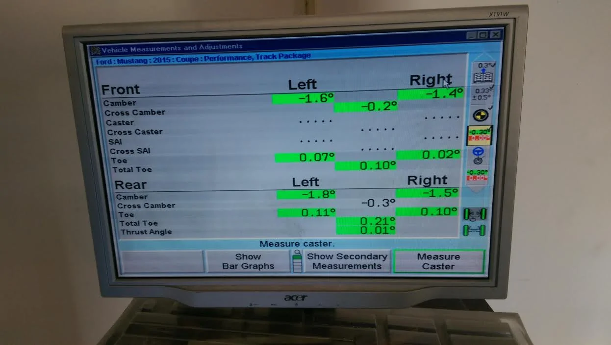

You bet. Here are my #'s after being lowered on Steeda progressive springs with the stock GTPP wheels and tires.
You said after, are those numbers also after an alignment or just getting the alignment verified? I ask because I don't see any before numbers.
