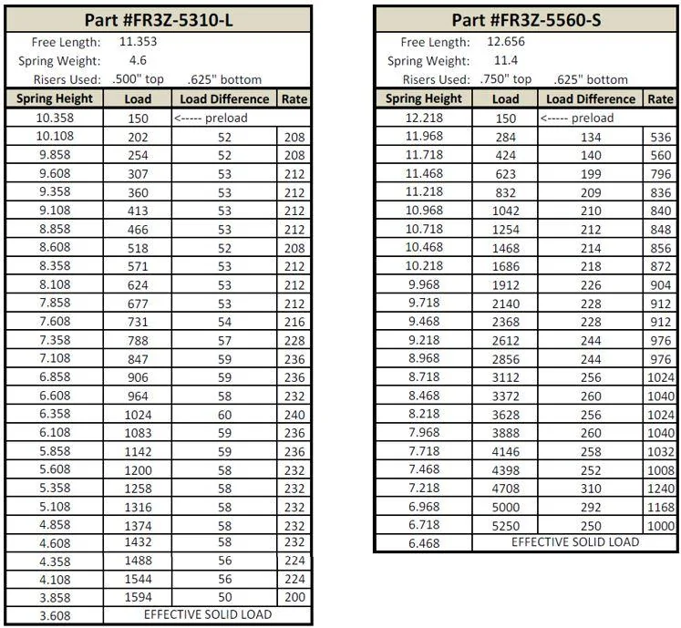

Front approx 245 to 250 lbs/in
Rear approx 410 initial 696 mid transition 913 final rate lbs/in

Can you please do the gt350 frpp test rate.

I am talking about the Ford Performance: M-5300-W.
Thank you

[MENTION=25806]SteedaTech[/MENTION]
Do you have the rates for the M-5300-W?

Any chance that we could see the detailed data for the M5300Ys?
According to our data source,
245 lbs/in front rear 411lbs/in initial 740 lbs/in curb 918lbs/in final rate
They are pretty close to each other as far as rates. The Y spring is more of a progressive in the rear and the W is more of a dual rate.
Which Ford has done a great job with the rear rates in my opinion. We have found anything over a 900lbs/in initial or linear rate in the rear makes the vehicle bounce,unpredictable and nervous at high speed cornering and braking in a road race application. That's why our dual rate springs are so popular with the HPDE guys that are serious.
On another note, We won the SCCA Majors opening at Homestead in 2017 with the Steeda Dual Rate Comp Springs.
Furthermore,our Dual rate comp springs paired with our Pro-Action adjustable dampers provide a fantastic ride quality for the street compared to other alternatives.
