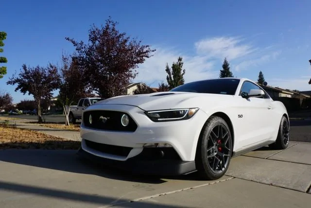

decided to make a post build thread of my N/A 505+hp 2015 mustang GT, here is some very quick history - bought the car back in 2015 at the dealership in Korea while I was stationed at Osan AB - 2015 mustang GT Premium in Oxford white with the "redline" interior only other option was the 3.55 gears. the car is now FBO and was recently dynotuned putting down 440 whp/400wtq. the most interesting thing about the car is obviously the grille (link on that build in sig) also follow the build on IG @cheval_le_blanc thanks for stopping by.

Custom Foglight grille (14 GT grille + 15 50th anniversary grille)

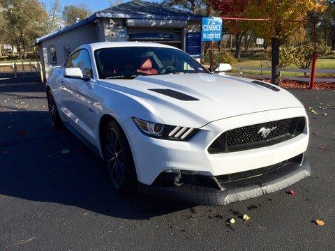

first day picking her up

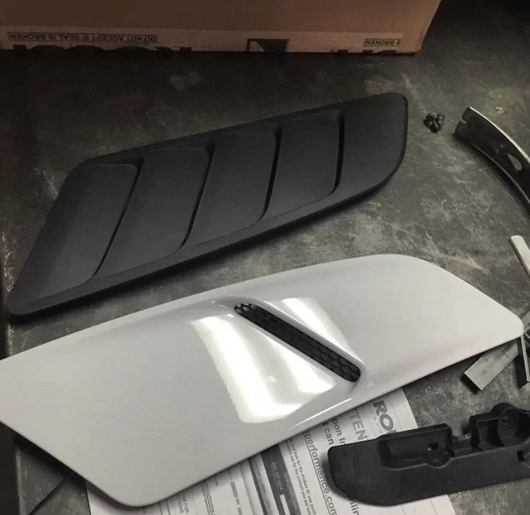

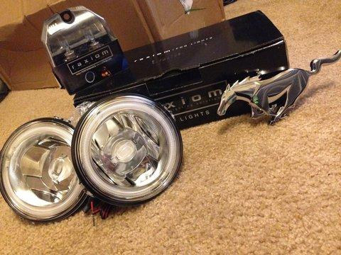

literally had these before the car and was officially my first mod...that i dont have anymore (replaced with gloss black vents with blinkers from the 2016)

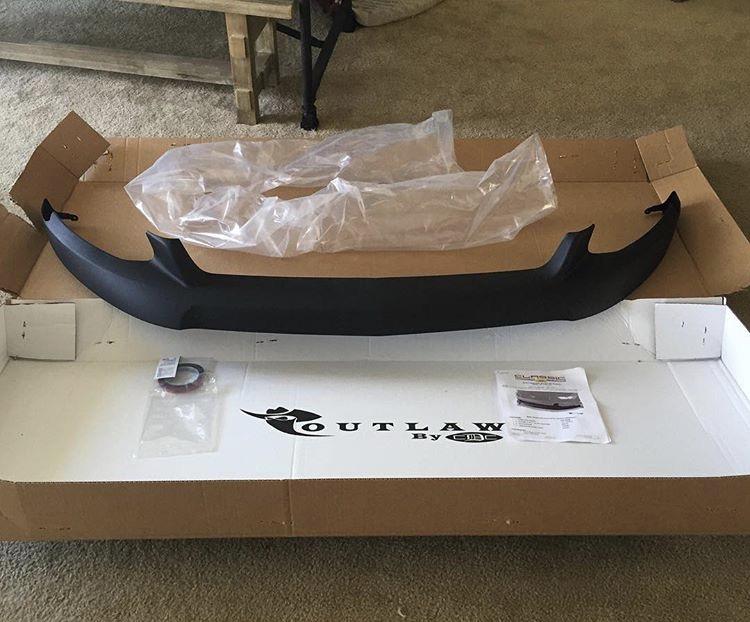

Next up was the CDC Outlaw spoiler which again been replced with the RTR chin.

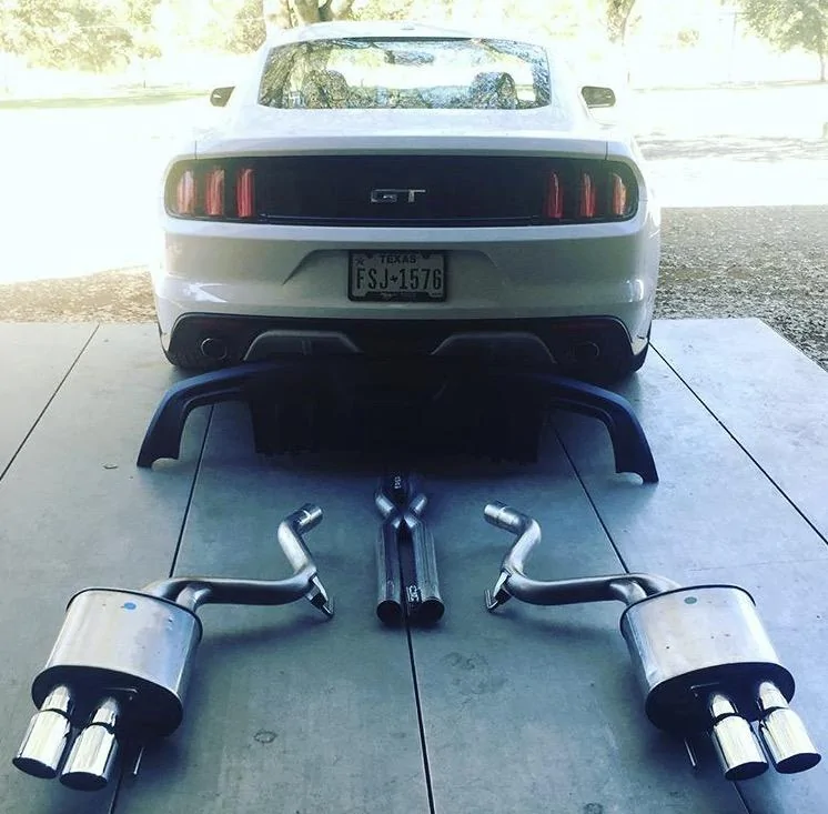

Next up exhaust! ordered up the ROUSH quad tip with the rear valence (passive) didnt get the active kit until recently.

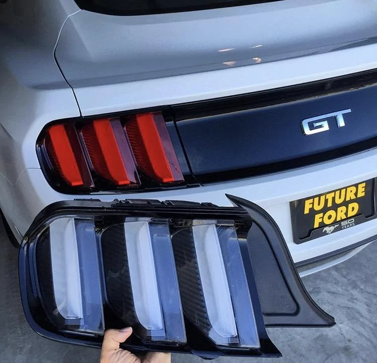

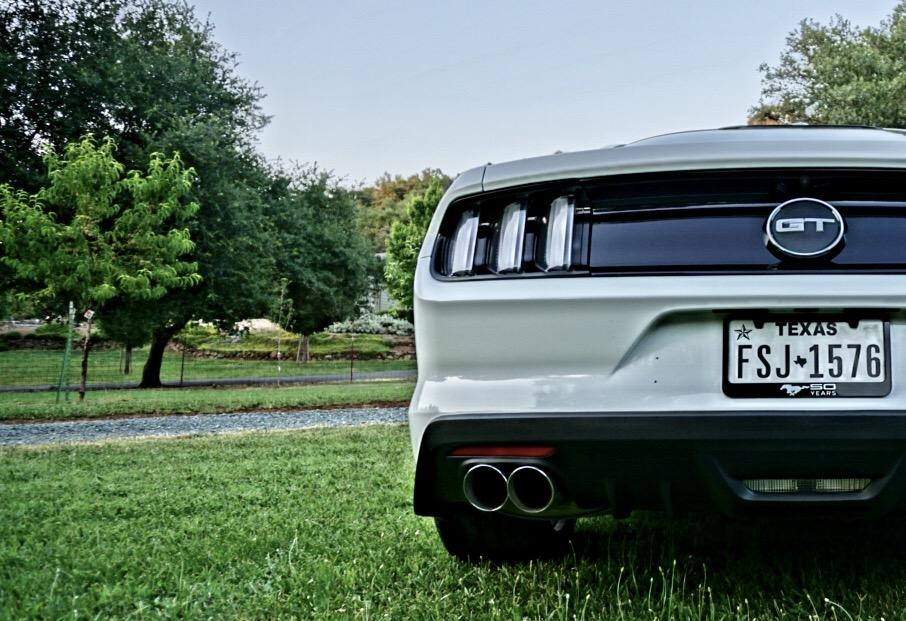

Euro tails and the Euro decklid was ordered as soon as i could find them in 2016 which was hard to do (ended up buying them from a dealership in poland)

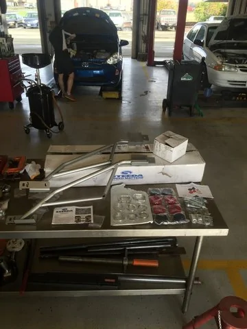

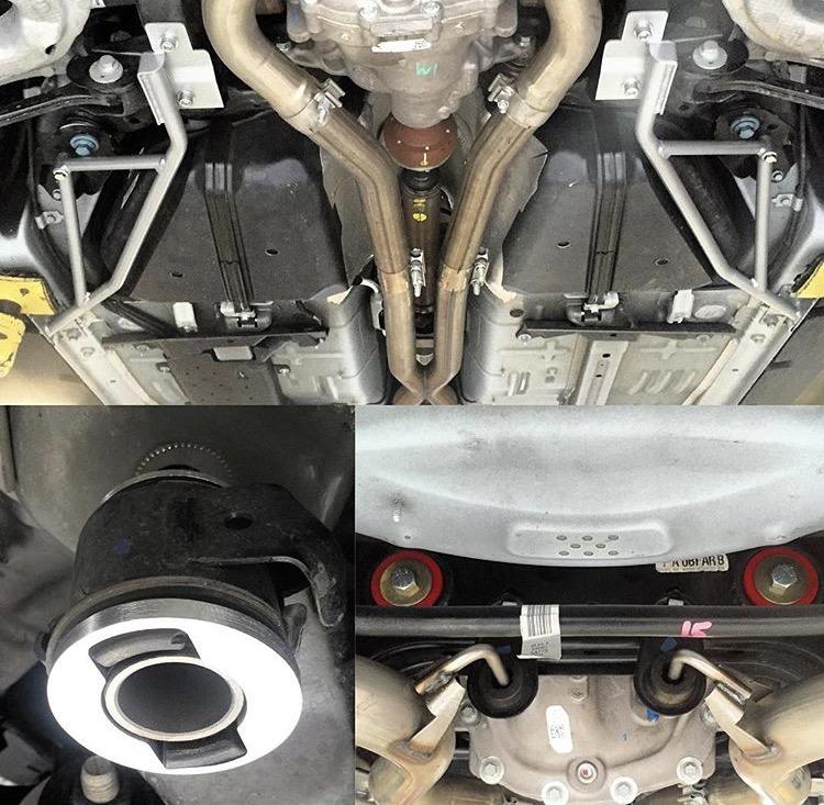

next on my list was to 'stop that hop' so a few Steeda suspension components was ordered

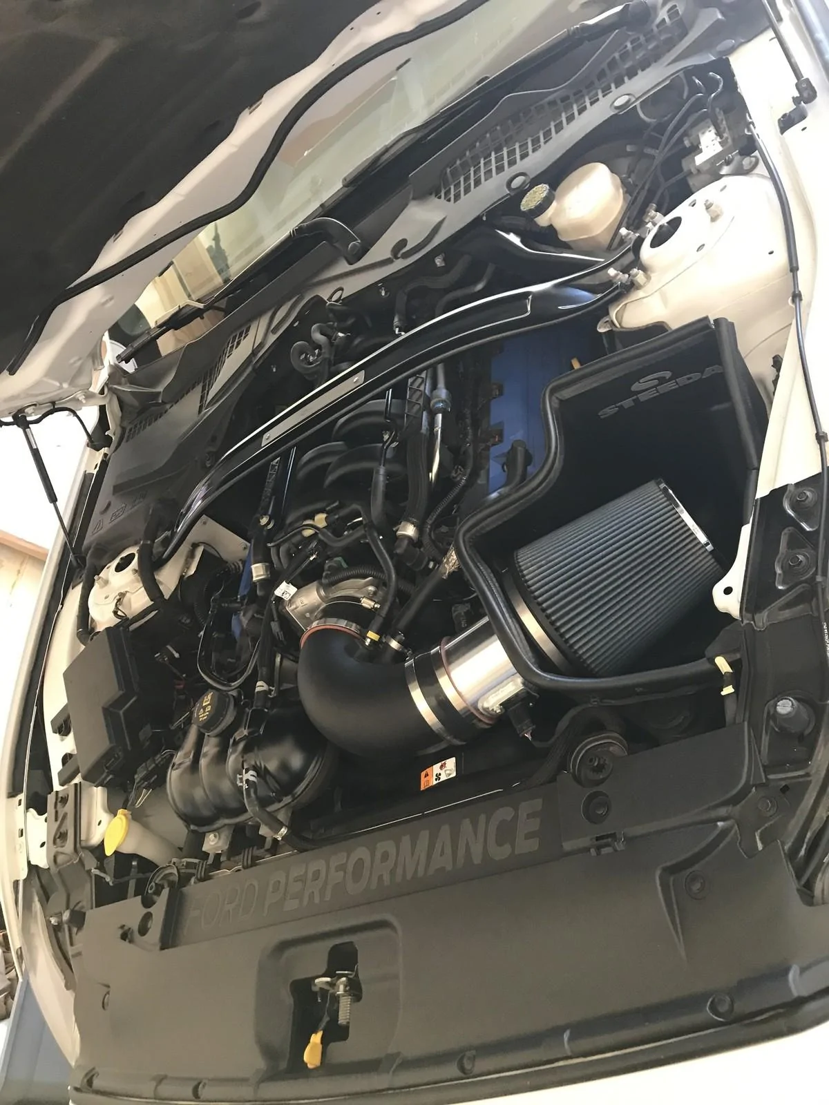

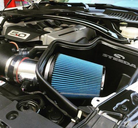

the Steeda CAI was the first engine performance mod ordered and I ended up running this setup with the insert and stock tune for almost 2 years until recently

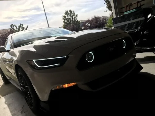

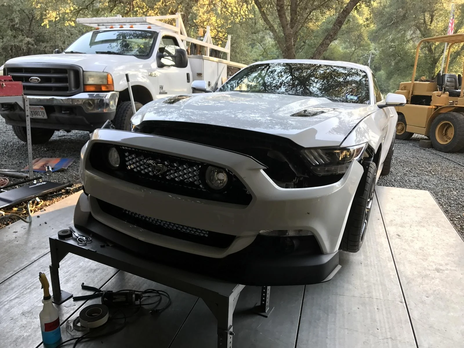

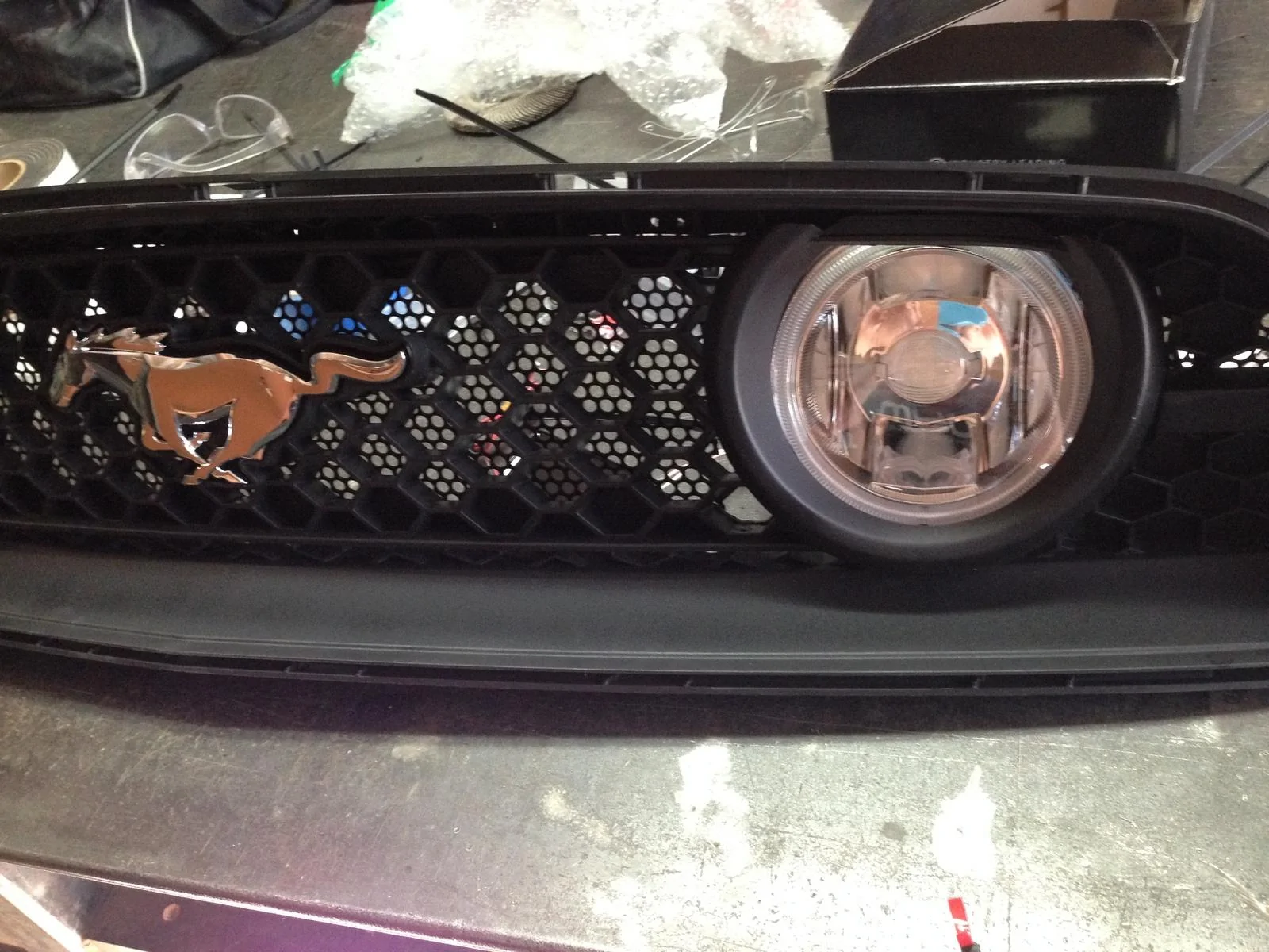

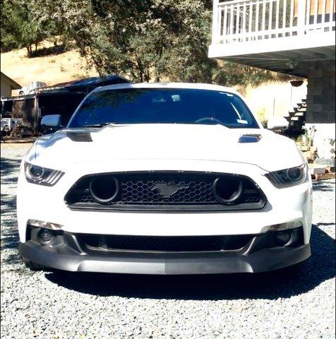

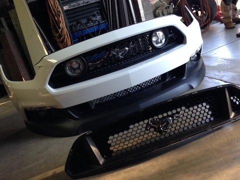

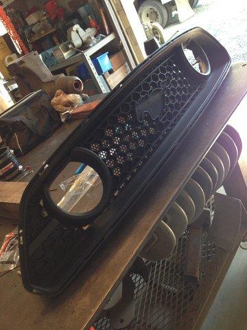

NOOOW the grille project. this sucker took about 6 months total to be completing including figuring out how the hell I was going to do it. the full build thread is in my sig so i'm going to be brief and say I basically spliced a GT grille from the 2014 GT into the 2015 50th anniversary grille

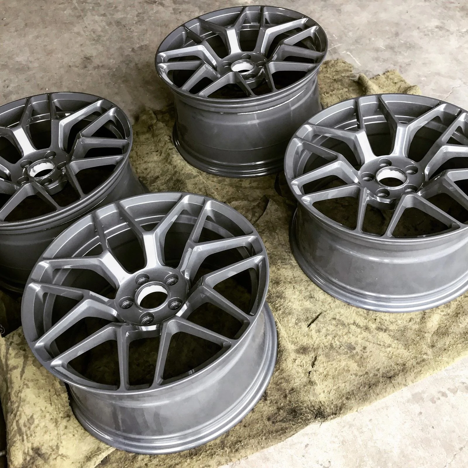

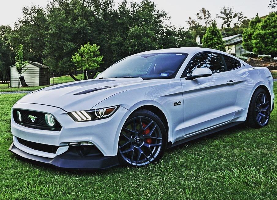

after this was wrapped up the RTR tech 7 wheels with mickey thompson street comps was ordered. they came in gloss black and scuffed from shipping sooo i got a partial refund and used that to get the rims custom powdercoated to a 'steel pearlescent grey'

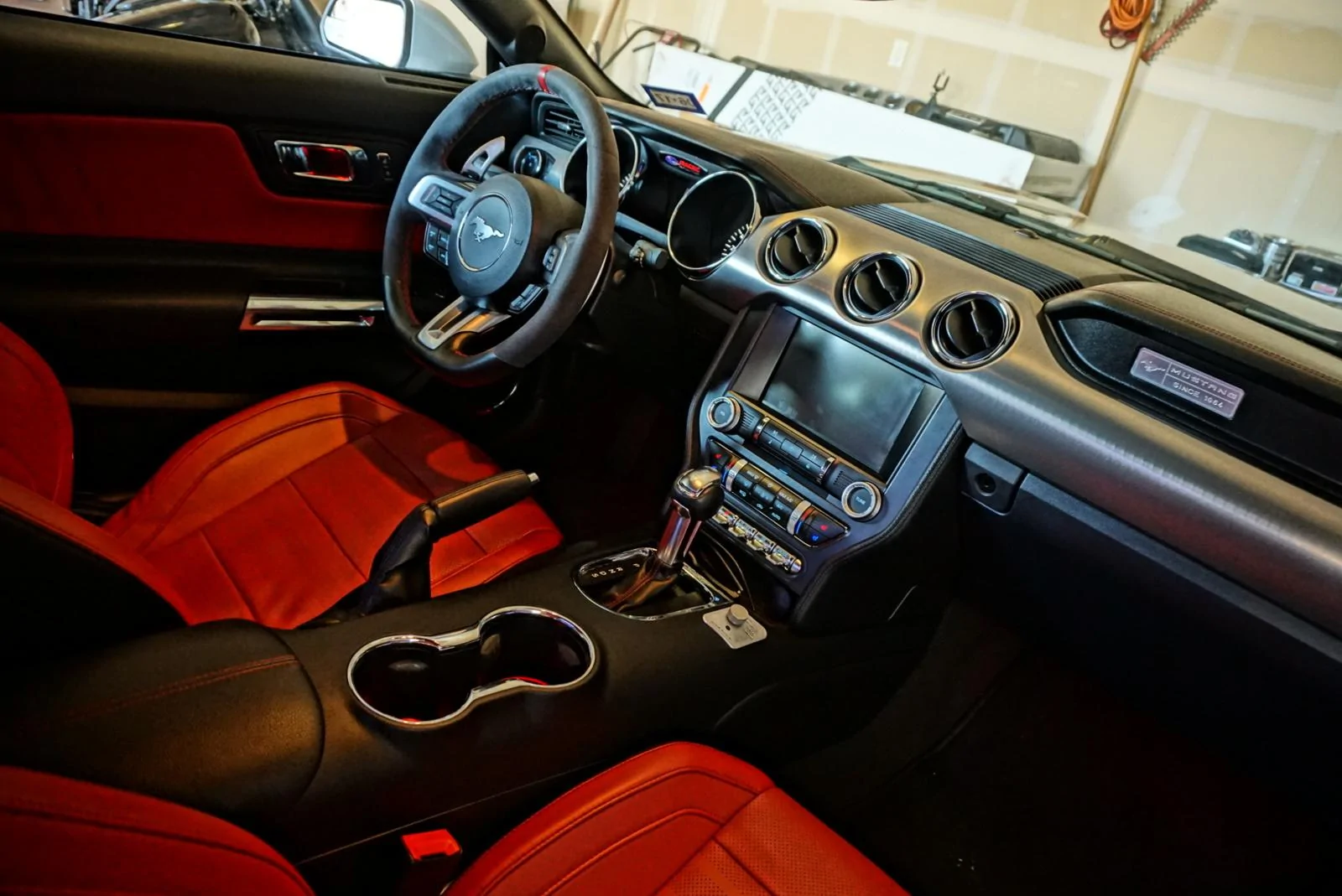

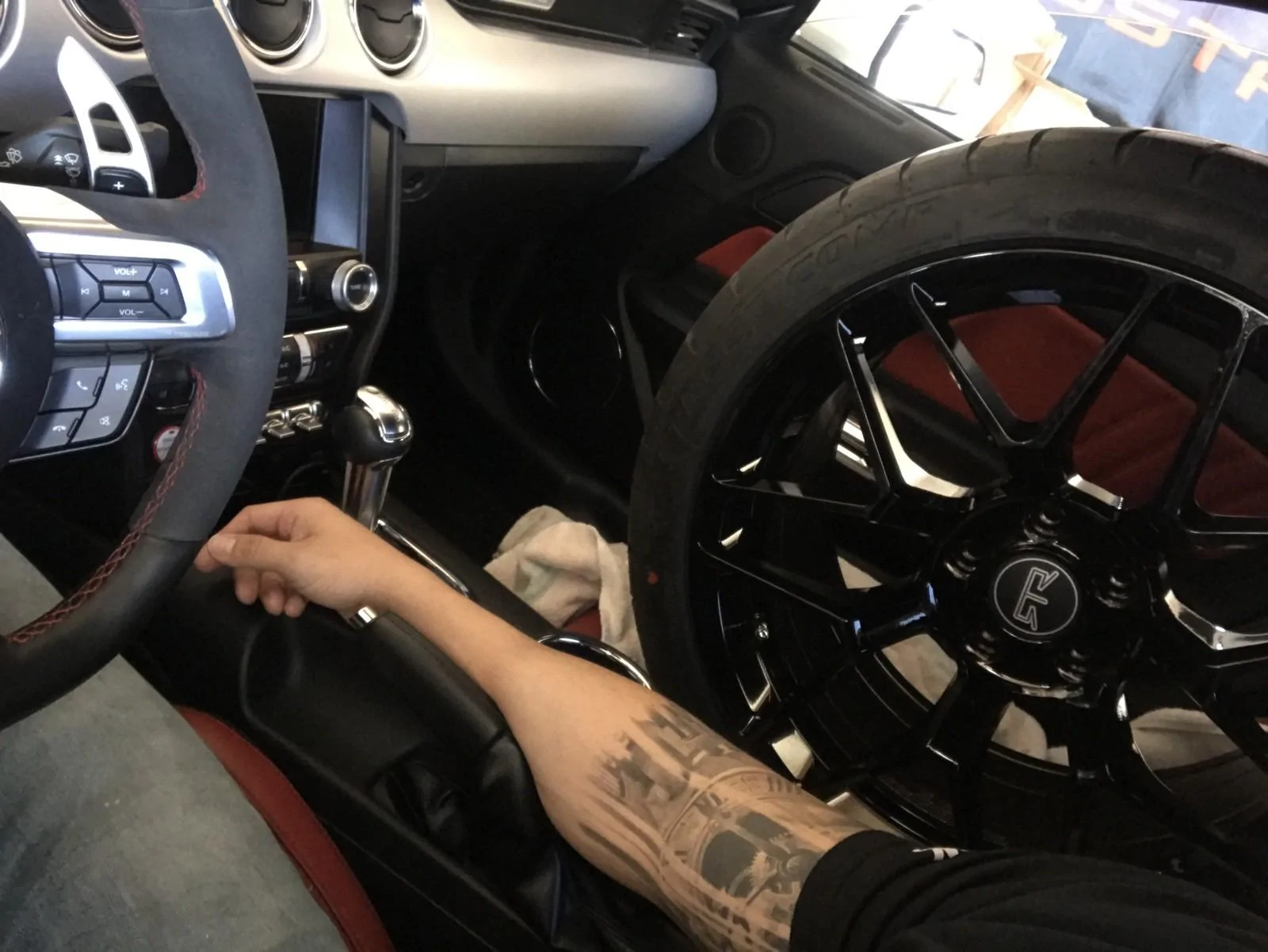

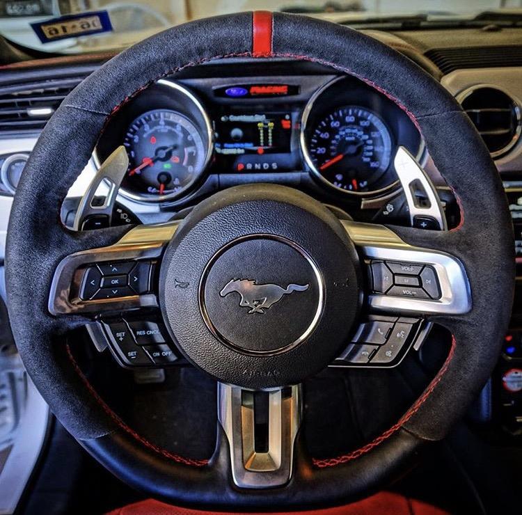

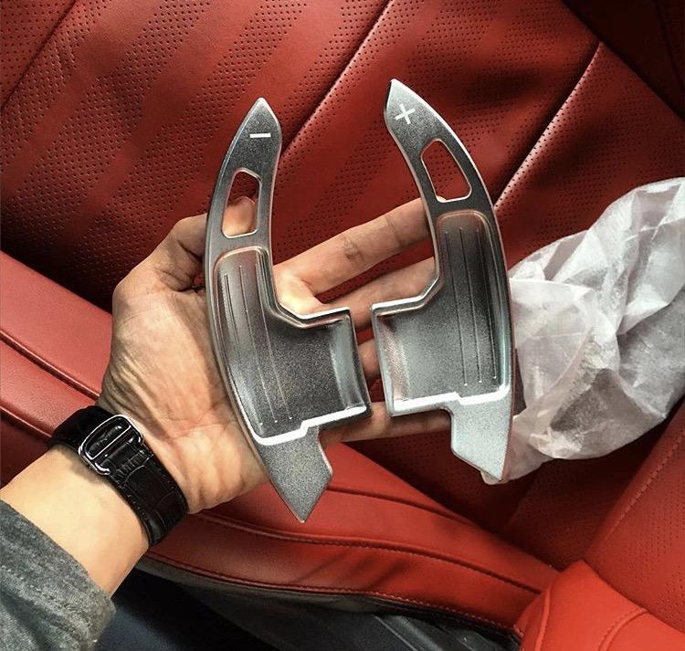

I then moved to the interior and outfitted it with the GT350 steering wheel and aluminum paddle shifter extensions

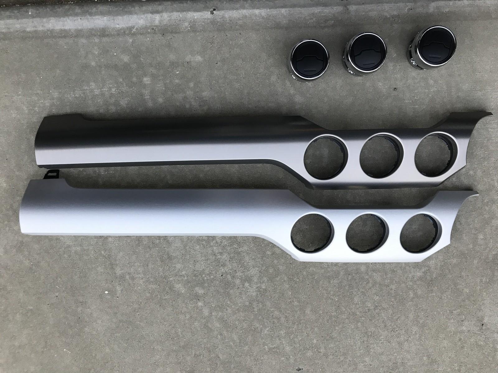

the last interior addition was the 'axel spin' dash trim from the 50th anniversary models

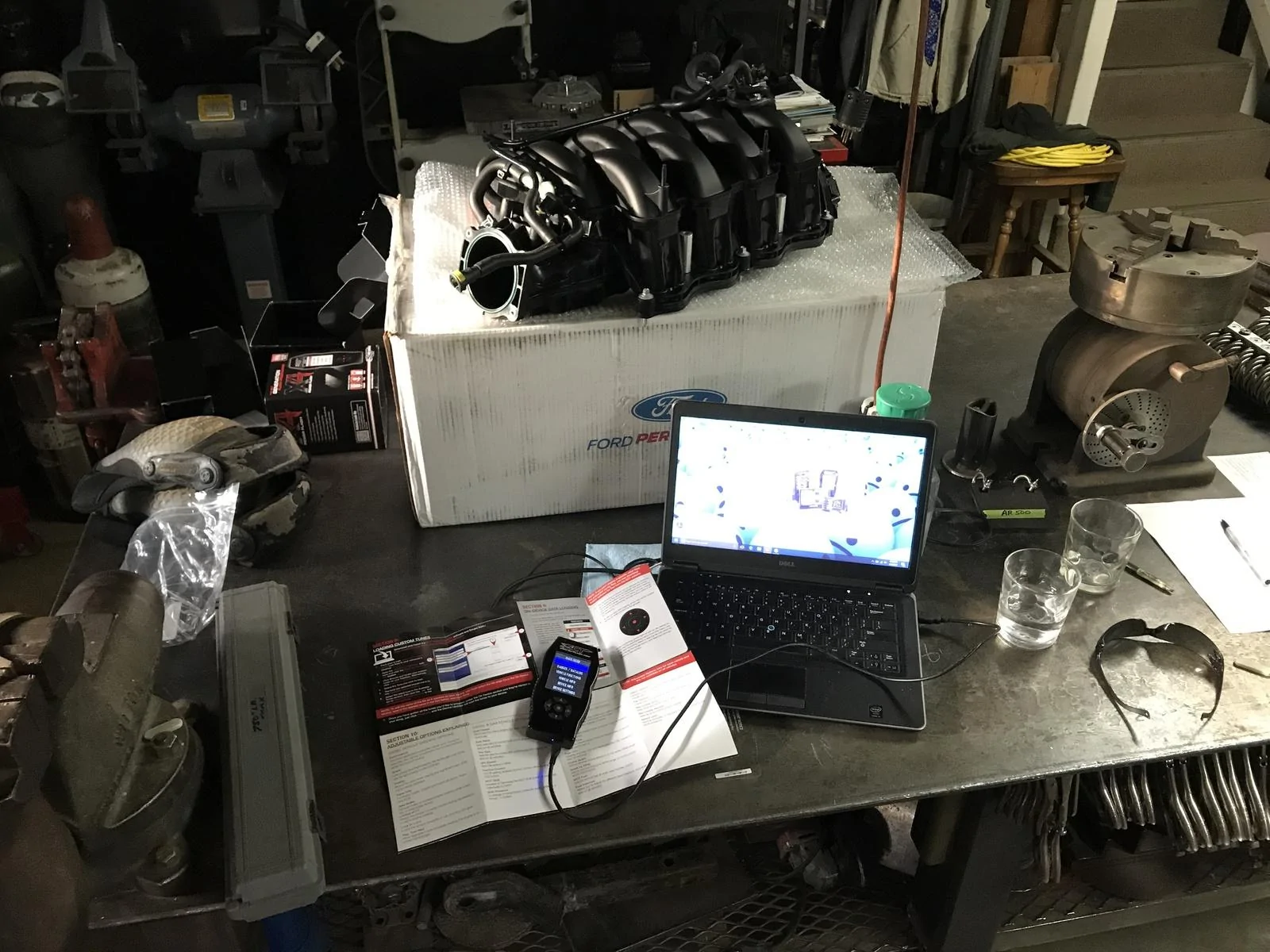

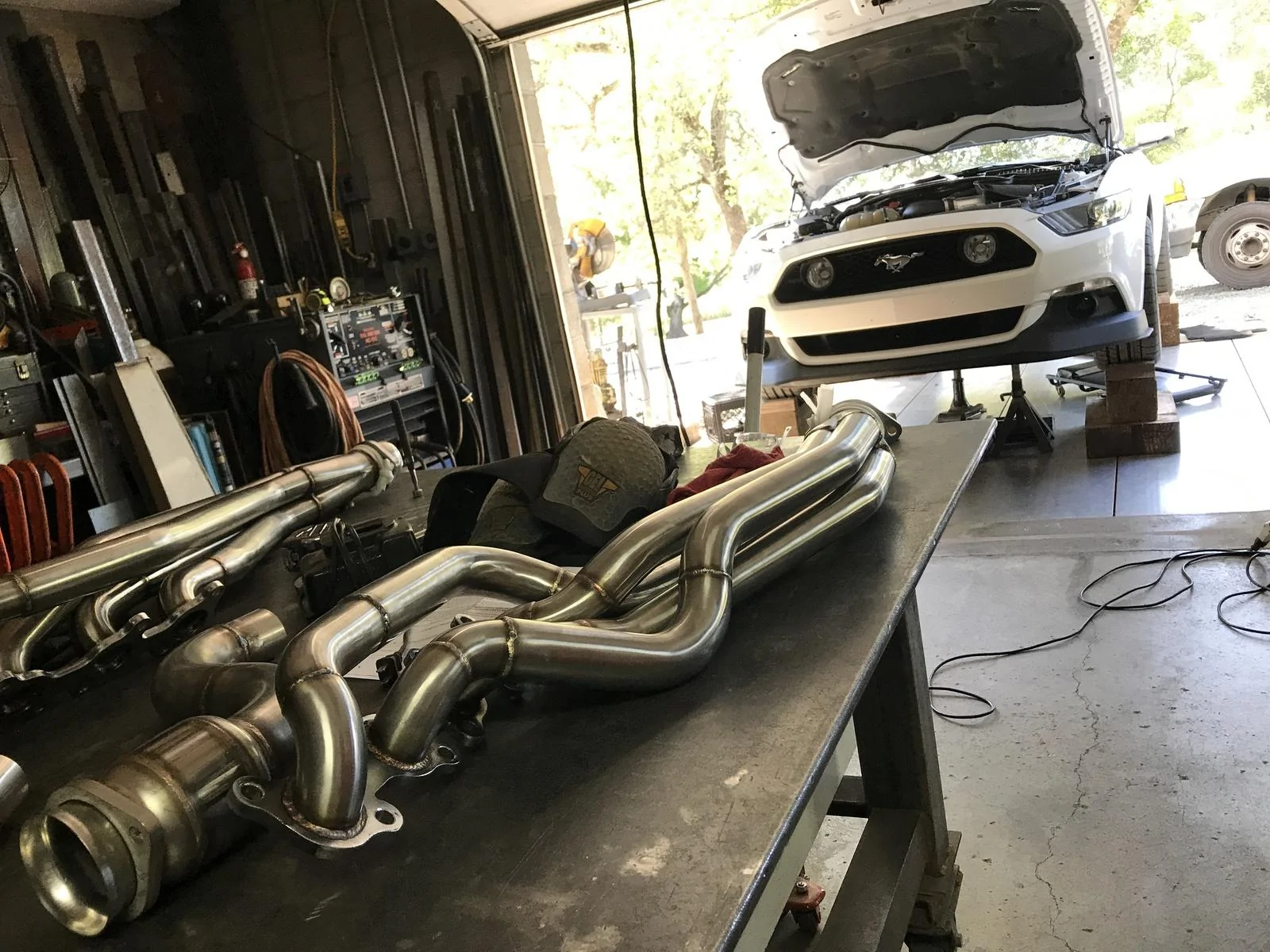

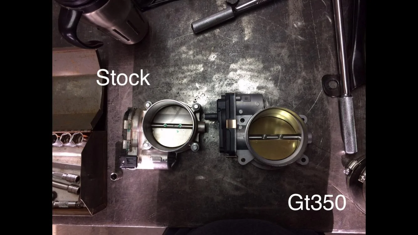

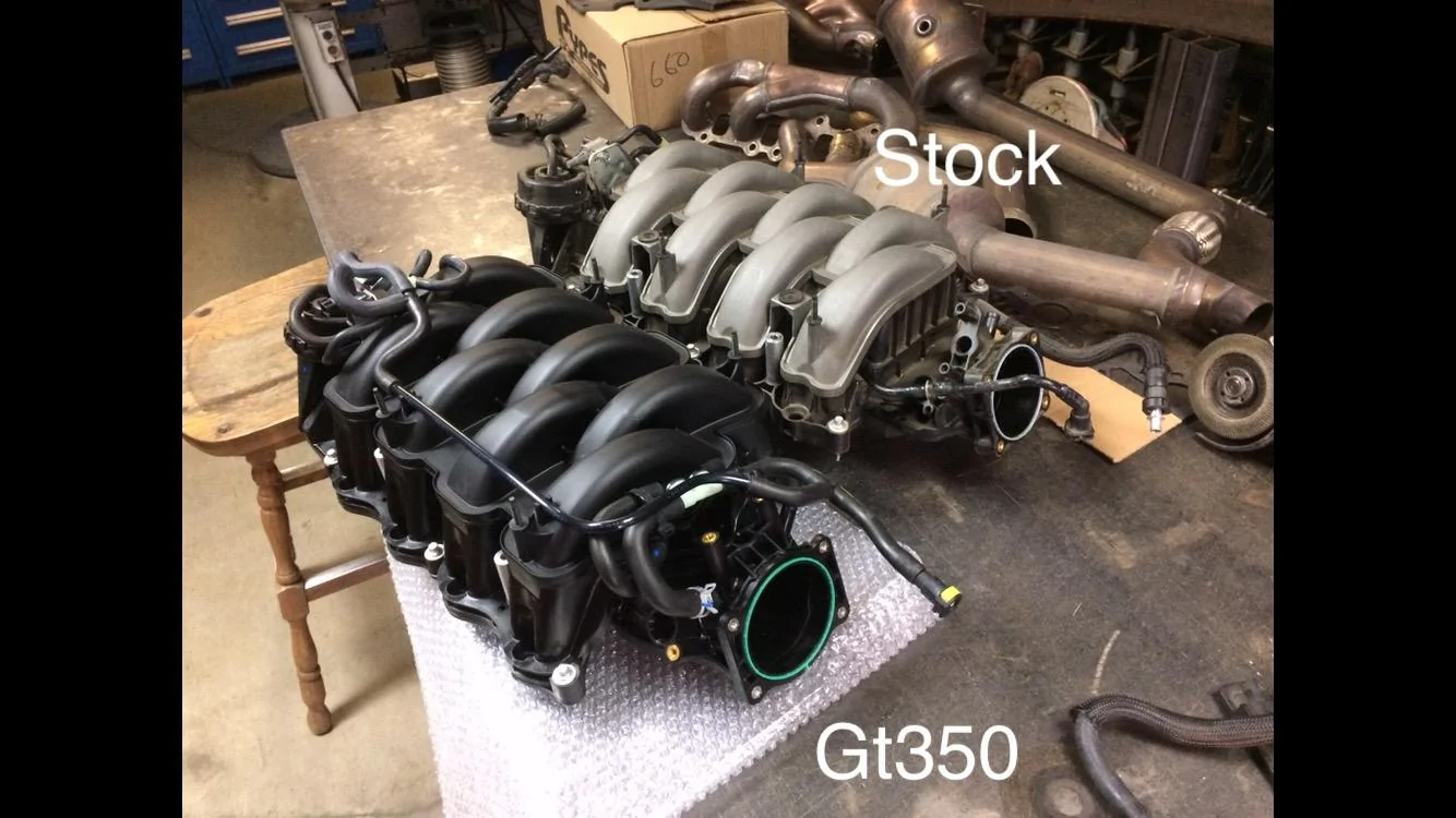

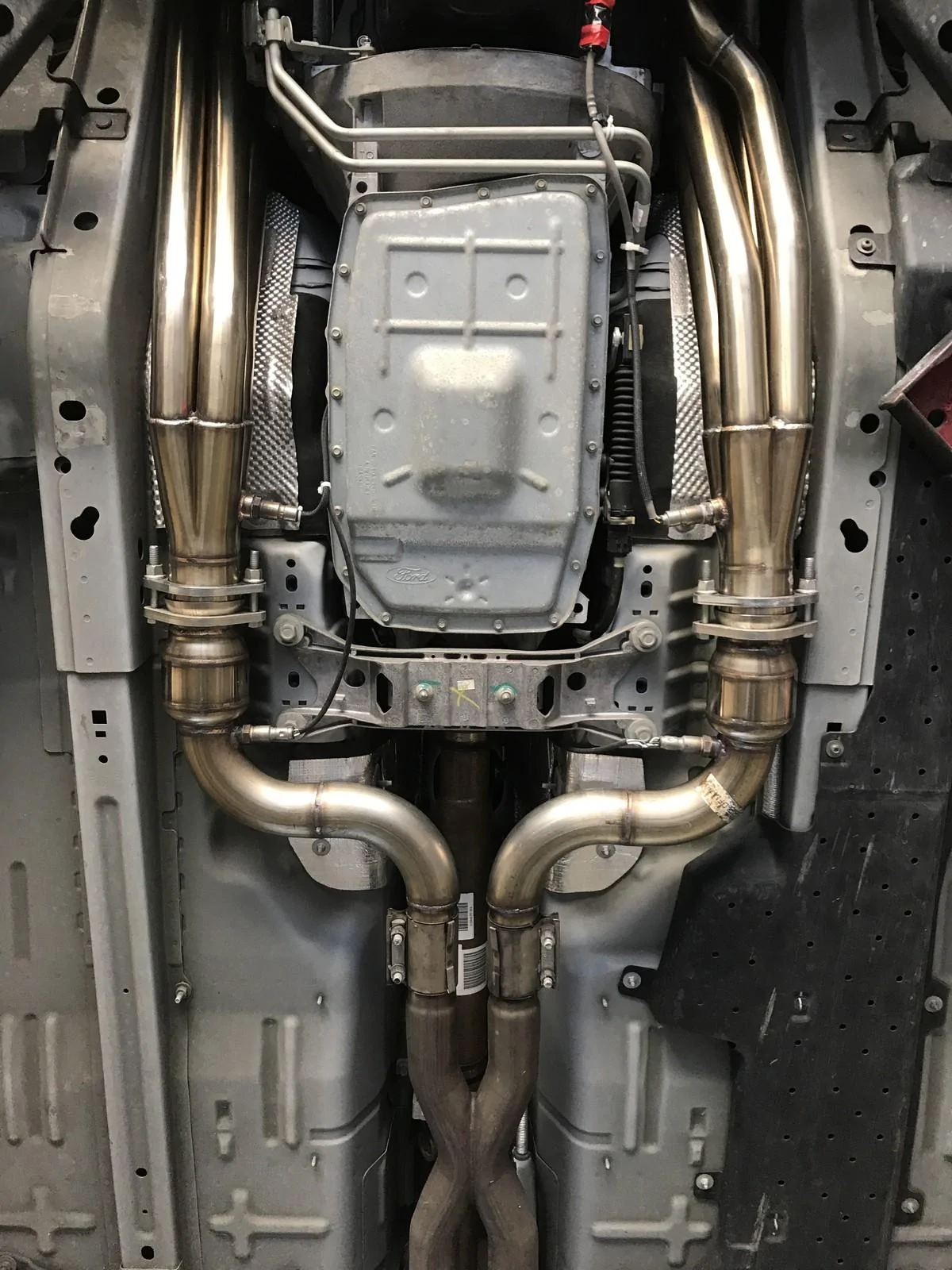

Here comes the POWER. GT350s intake and throttle body was installed with Pypes longtube catted headers.

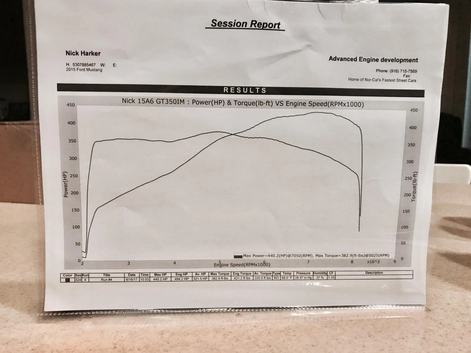

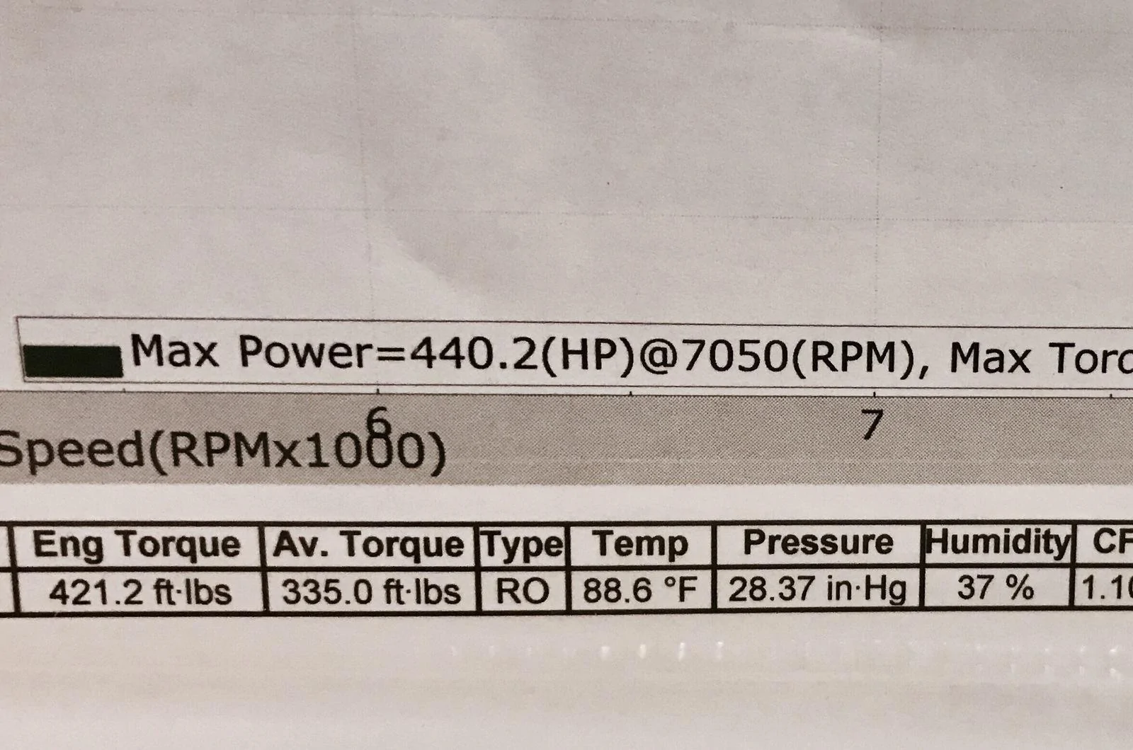

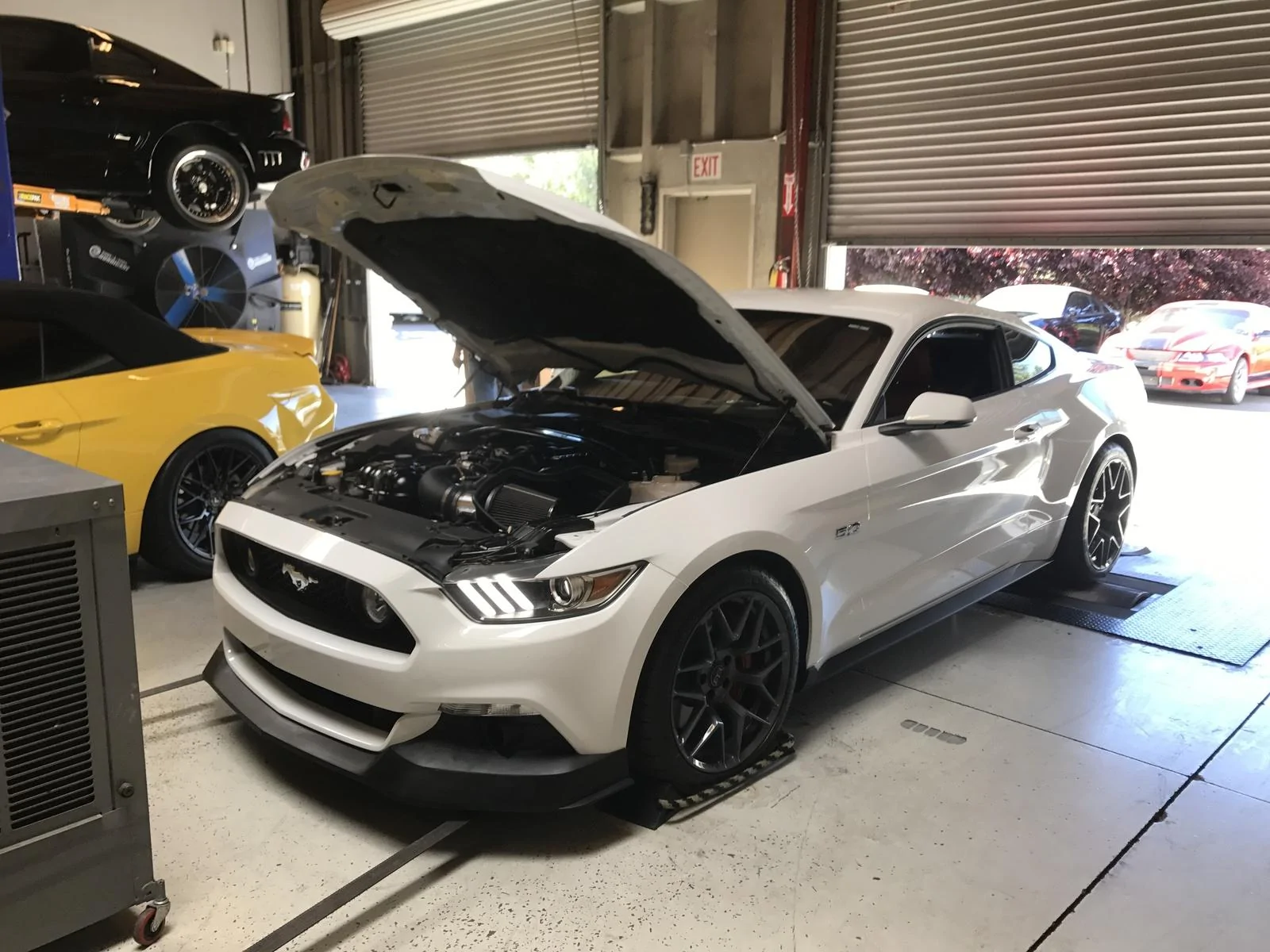

The car was dynotuned last month and it put down 440whp/400wtq adding either 15% to 18% drivetrain loss (auto here so i leaned to 18%) the 5.0 is cranking out 520hp! :headbang:

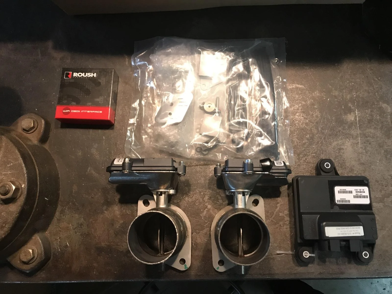

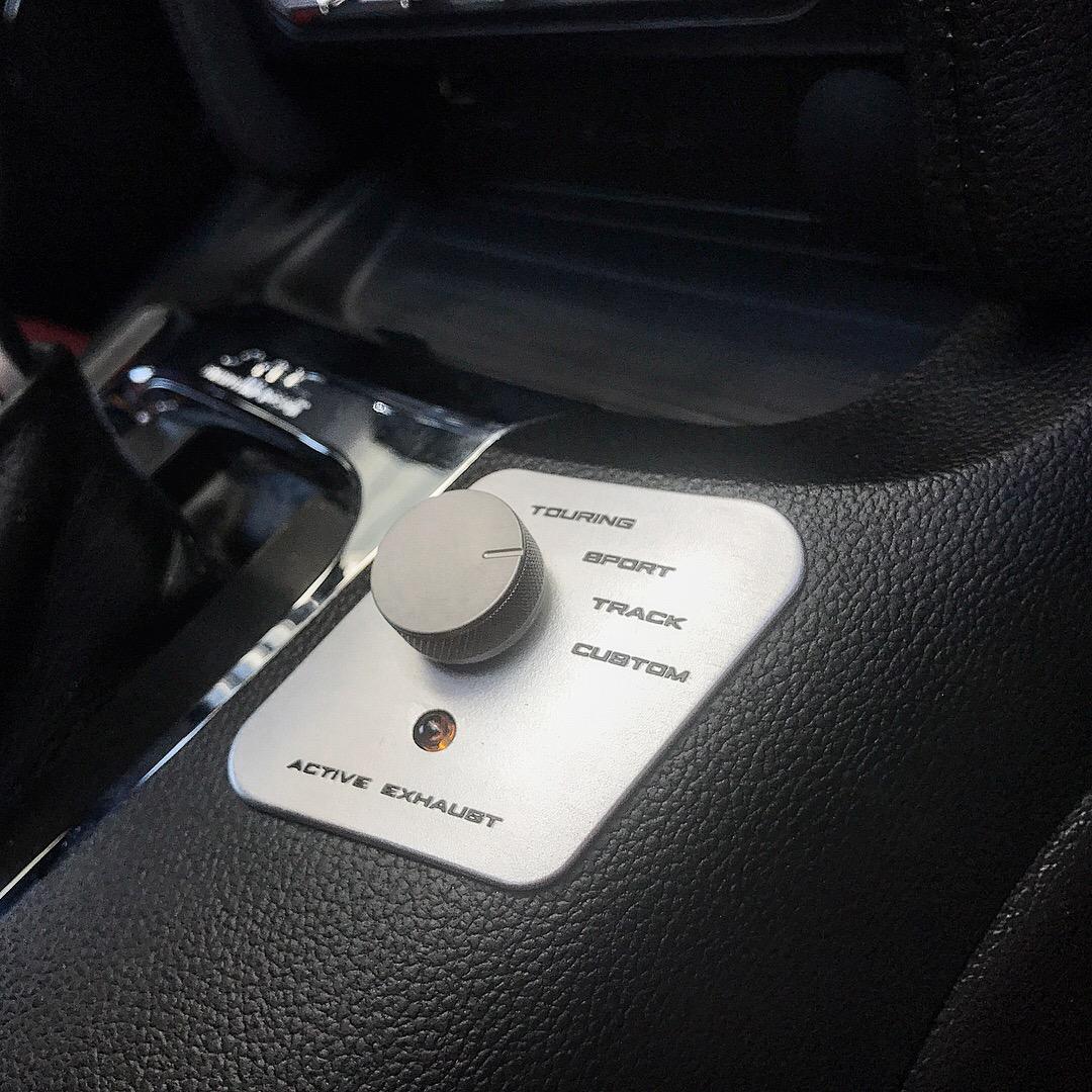

the ROUSH active kit was ordered (the setup was way too loud for suburb living

Good work on your car, jealous of the active exhaust. Also that grille definitely looks unique props on that. You have any issues with cops and those Euro tails?
No issues ever with the euros, i think the only reason they would be illegal is the orange turn indicator but mine have been wired with the U.S. spec sequentials.

Do you have that dash trim you took off for sale? I'd like it for my base model

Thats the best story i have heard about the grille, Thats awesome, not sure if im going to be making any more the way i did mine (hand cutting the two grilles and putting them together) abs is not fun to mess around with, although a buddy of mine suggested 3d printing....hmmm
Actually The trim piece just sold on ebay last night, auction was up about a week, unless your the buyer.. haha

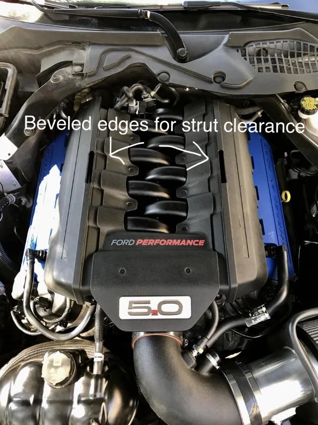

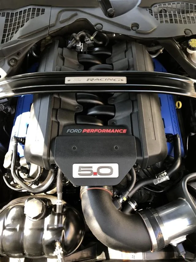

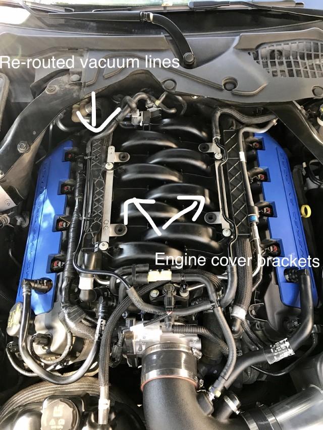

Update, finished up modifying the stock engine cover to fit on the gt350 manifold. Here are some quick notes on the process
-used brackets for the cover that i found on ebay (thought this was going to be a simple bolt up and your done...i was wrong)
-had to cut the back of the cover a bit to fit
-vacuum lines on the gt350 manifold had to be re-routed (used longer rubber hoses)
-had to trim the top of the cover down in 2 spots to clear the strut bar
