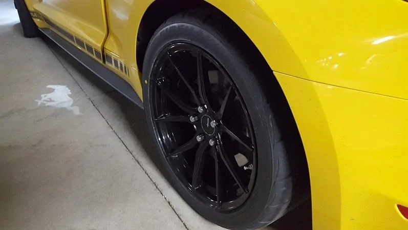

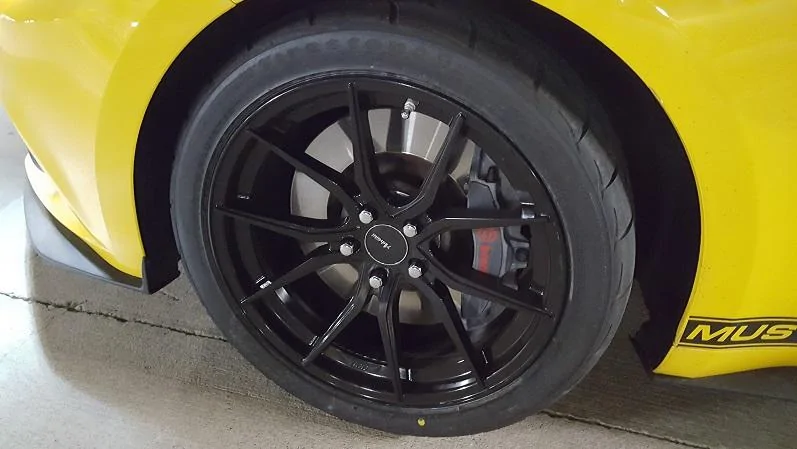

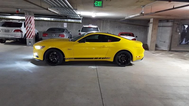

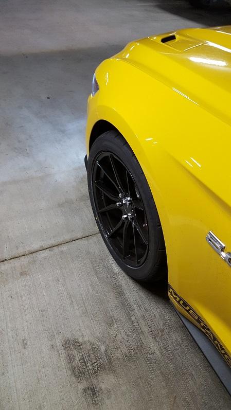

I replaced the OEM Pirelli's (255/40 F, 275/40 R) and rims (19x9 and 19x9.5) on the 2015 GT-PP (which collectively weigh F-60.6lbs / R-64.3lbs) after driving around in them for over 2 years (and putting in 5 autocross days as well!). I felt the Pirelli had three strengths: decent steering feedback, even wear and high limits in the dry heat (but with a sudden drop off). I wont go into the negatives on those tires as many of you already know them. Changing those wheels and tires out was harder than I expected it to be as they were so goddamn heavy that lining those with the hub studs was hard (I need to do more core workouts!)
I went with Firestone Indy 500s (285/35 F and R) and square Advanti Hybris wheels that were wider on the front and rears (19x9.5) and MUCH lighter (19.6-20 pounds each). This combo weighs 49.6-50 pounds each.
I also added 5mm hub centric spacers in the front so the wheel caps can clear the hubs!
So changes in specs:
  • Totals a savings of 50 pounds of rotating unsprung mass.

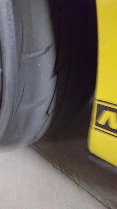

  • Slightly wider tires in rear (275 Vs 285), much wider in front (255 Vs 285)
  • Newer more advanced rubber.
  • Improvement in front and rear track (not measured)
  • Reduced sidewall, especially in rear (0.8 inch)
  • Really reasonably priced wheels and unusually cheap tires (I purchased from CARID which had no sales tax and beat Tire Rack by 100-150 for the 4 set!)
  • I like the design of the wheels and aggressive tire tread look. The wheels have a nice concave design that doesnt show in photos.
Here are the improvements I have noticed driving around in the street and freeway for 200 miles. I have not auto crossed the new combo yet or driven it hard on mountain roads. To be clear, I was expecting benefits from the weight loss but was skeptical of the FireStone brand. I did a lot of research and the reviews on Tirerack for these tires were really good - apparently they are re-branded Bridges tones Potenza S003's (sold abroad). Worth mentioning - there is no bulge with mounting 285 tires on 9.5 inch wheels (measured width is 10 inches, range is 9.5-11 per TireRack).
  • Car feels much lighter. Especially in the front. It feels like I removed the V8 and put a lighter engine in there! I suspect this is because of the lighter front wheels and improved track in the front, which improves steering response.
  • Steering effort is greatly reduced. I suspect this is because of lighter wheels and tires that have a smoother tread. Normal has the effort of comfort now.
  • Car responds to smaller steering inputs (better response). This is likely because of wider front track.
  • The ride is noticeably better even though the sidewall is smaller in the rear. I think this is because the tires have a softer sidewall? Potholes and issues in the road are dealt with without impacting the body much (its like the dampers are better) and overall the ride is less busy.
  • The car is controlled less by wheels and tires. Before, a mid corner bump would disturb the car more than it does now. To be fair, the S550 is MUCH better than the S197 in bumps. I should also add, the mid corner bump situation got worse when I installed stiffer rear sways and poly bushings/cradle bracing in the rear IRS (so I made a trade-off here when I stiffened the rear in order to get less wheel hop and more rear feel). With this tire and wheel combo, I can carry the car with more confidence much faster on ramps and its NOT because of improved grip (I have not explored that limit yet).
  • The car grips way better in the cold (40-50 and rainy days). Before, I would assume anything but babying the throttle would result in spin. Now I couldn't really get much spin even in moderate throttle in those conditions (I haven't tried full throttle in the cold wet conditions).
  • Car feels like it accelerates faster up the rev range (its a minor change). I would say it almost feels like a lighter fly wheel. This is def due to reduced rotating unsprung mass.
  • I have experienced no tramlining. This was unexpected. It might be because these tires have a smooth tread design that doesn't catch and softer sidewalls.
These are all subjective benefits, which are important to me. My build philosophy is a daily driver and fun car for autocross and twisties with balance, handling and feedback/feel = confidence and enjoyment . I am not building a drag car or race car. I expect actual objective benefits when I autocross and take her to the twisties, resulting mostly from the improved rubber compound, wider fronts and lighter wheels. Not that I have had an issue but I'm curious if braking will improve given lighter wheels, better compound. Additionally, the wheels have big gaps between the spokes - this could improve brake cooling.
More on that when I get a chance to test those out.
Some snaps showing the wheels, gaps, wider track, tread etc. The wheel gap needs to be reduced - I have GT350R springs and Pro Action adjustable shocks waiting for me to find some time to install! Unfortunately, when I autocross next I will have these new tires, wheels and shocks and springs, camber plates etc so it will be difficult to tease apart what caused what improvements.
