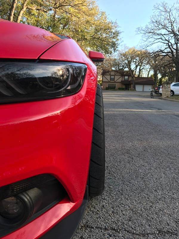

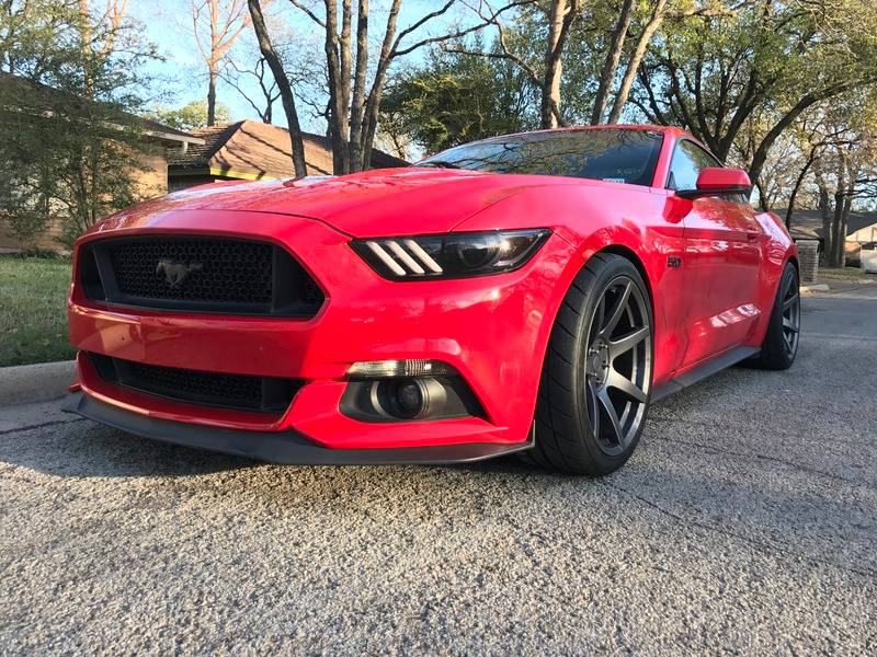

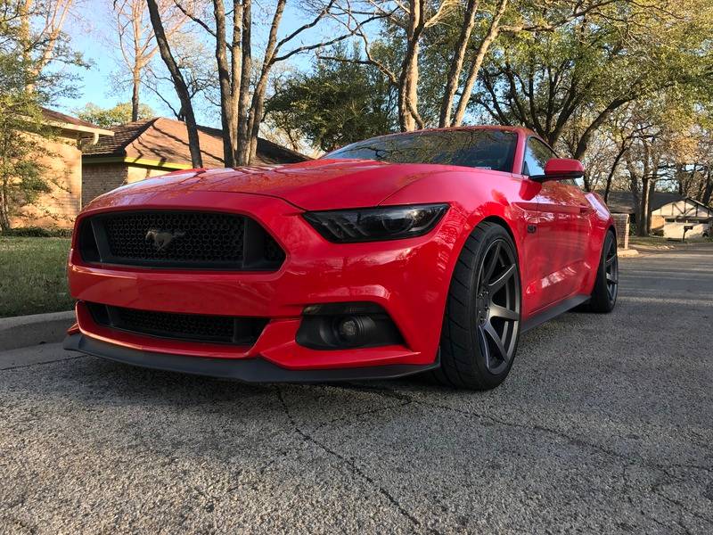

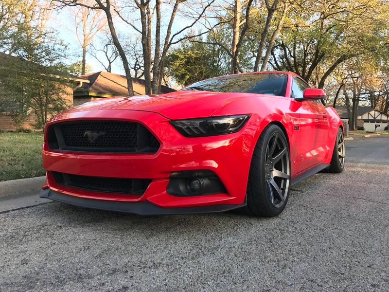

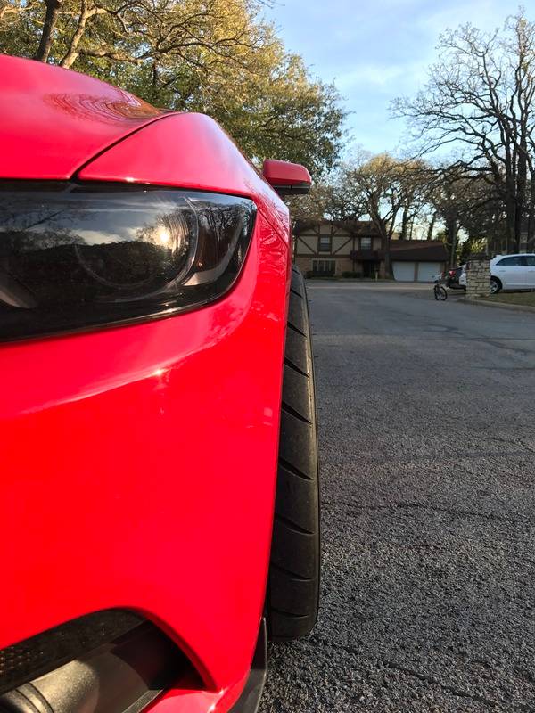

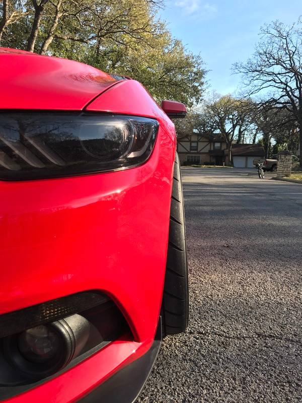

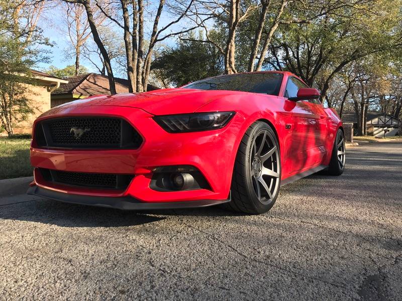

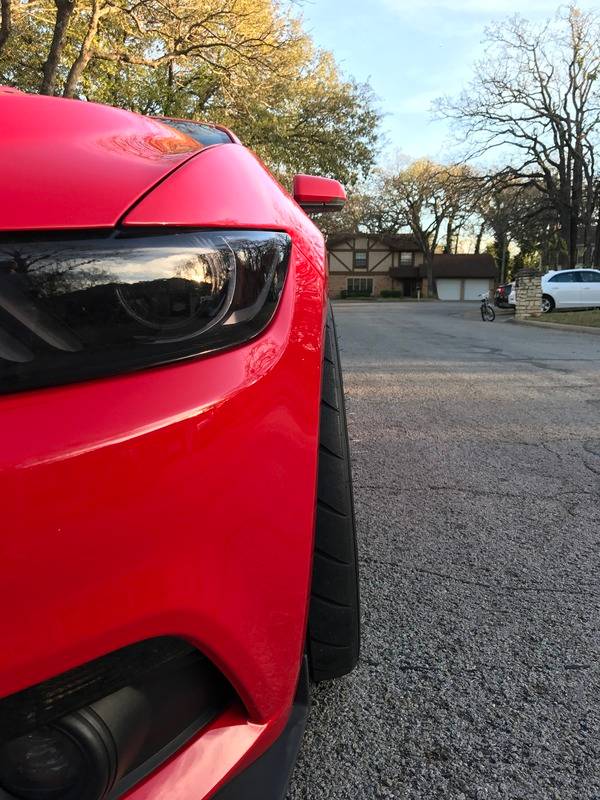

Over the weekend, me and a buddy installed our 19x11's on our GT's w/ PP and wanted to document clearances and such since our suspension setups are different. Between the both of us, we have stock style springs/struts, coilovers, 20mm spacers, 25mm spacers, stock bolts, camber bolts and caster/camber plates. We only have a few clearance measurements so far but would like to mix setups to get more measurements in the future.
Here's what we have so far... more pictures/clearances to come.
2016 Mustang GTPP (Member: Killspray)
Controlled, Does Not Change:
Wheels: 19x11 et50 Project 6GR
Tires: 305/30R19 Hankook Ventus R-S3
Springs: BMR Handling
Struts/Shocks: Koni Yellows
Camber Plates: MM
Rear Spacer: None
Will Vary For Pictures:
Front Spacer: 20mm
Camber: -1°
Clearance to Strut: 4.5mm
Camber Bolts: No
Front Spacer: 20mm
Camber: -2.8°
Camber Bolts: No
Front Spacer: 25mm
Camber: -1°
Clearance to Strut: 9.5mm
Camber Bolts: No
Front Spacer: 25mm
Camber: -2.8°
Camber Bolts: No

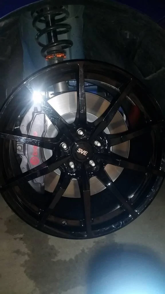

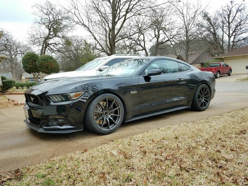

Nice information! I did some test fitting with an SVE 19x11 +50 last week. I'll post my information here as well. Sorry for the crappy pictures. I had about an hour to play with so I was trying to hustle.
The wheel:

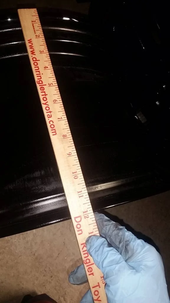

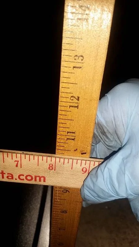

I think most know, but just in case,a 11 in wheel is actually a 12 in wheel total when taking into account the mounting surface:
backspace for a 19x11 +50mm is 8 inches. I like to work in backspace over offset as it doesn't change based off wheel width, so for reference:

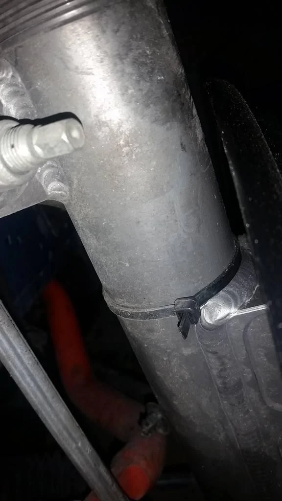

Afe coilover front strut clearance with 22.7mm spacer(sorry for the crappy picture). I need to get my calipers out measure the thickness difference between stock struts and aFe :

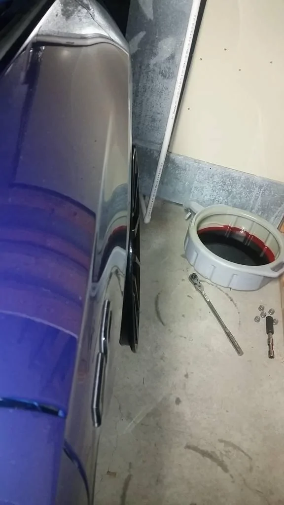

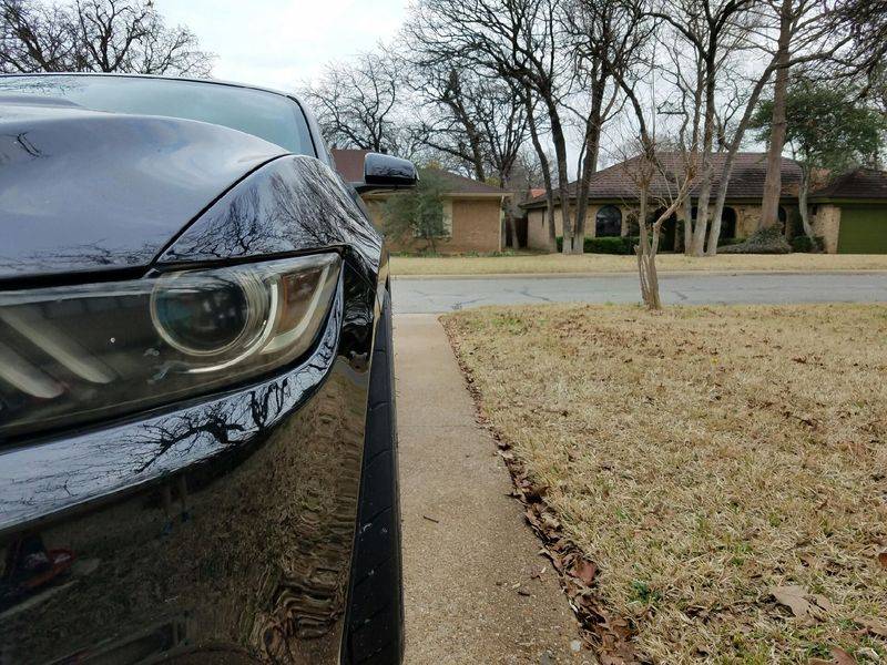

Front unweighted, should clear fender easily. I'm currently sitting at around -3 of camber:
Rear wheel with no spacer clearance on aFe rear coilover. Currently at -1.9 camber(since we know this fit):
Looks like a good, cost effective way to run 19x11 squared. :)

Thanks for the pics, Brent! We have seen a few 19x11 setups on coilovers but haven't seen any on stock style suspension... I bought my Konis assuming I'd eventually buy 19x10's and run them with no issue. I ended up buying 19x11 once I realized the STP class now allows 11" not even knowing if they'd fit. I was already preparing to buy coilovers and was surprised that they actually fit!

Thank you guys! You two are the one doing all the real work. I just bought a scratched wheel from LMR to work on what I think the correct offsets are for the S550 since several companies act like this takes more than 1 hour of work and is a proprietary secret. I just wanted to hopefully add a little useful content to your thread as I was in the basement this last week working on the same thing. :)
I think the stock struts are thinner and should have more clearance than the afe struts, but I'll need to measure that to confirm. The cortex coilovers with the offset strut gives roughly an extra .5 in of clearance so a smaller front spacer would be required(maybe 8-10mm based off your 20mm spacer).
Out of curiosity, are your friends rear JRZ's coilover or stock configuration?

As killspray said, my JRZs use stock spring location.
I think the JRZ front struts must have an offset built in as I seem to far more clearance to the strut body than killspray has on his setup with the konis. My minimum clearance is to the lower spring perch. I think I am going to raise my ride height a 1/4" and then I should have the perch out of the way which will allow me to run with camber bolts maxed out. I might not need to, as right now I have 8-10mm or so clearance. So *maybe* with camber bolts maxed out I'm looking at 3-5mm clearance? We will find out soon.
