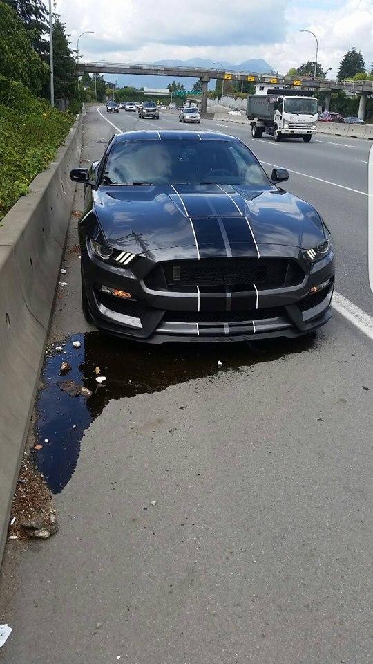

Found a case of a failed recalled oil line

Found this on a Facebook group. May be a little hard to read, Photobucket will probably kill the quality. The guy did comment it happened before the recall was put out.

Customer's comment on bottom is telltale..... MY2017 bring it on. ;)

The service dept put a lot of work into cleaning up the effects of the burst oil line.

Less than 2 liters of oil left in sump......?
That can not be good, they state no material metal/material found, but.....
Yeah because the other 8 quarts are all over the cars chassis.

Here is the rest of the oil.

This is your car?

Lucky for me, not my car. This poor dude posted this pic on his Facebook page (link provided by Matt above). The rest of us seem doomed for a similar fate, yet clearly parts exist for the recall, the newest cars not involved in the recall already have them, so..., what in the hell are the rest of us waiting for? Ford.

No shit!
This is your car?
OP is from FL. We don't have mountains in FL, so probably not his car.
However, with all that said you are spot on...... Ford needs to own this. Imagine dropping 10 qts of oil on a track where people are depending on braking.
Either the car is safe to drive as it was built or not.
All lives matter.
All I focused on was the Exxon oil spill. Alaska has mountains.
If you look at the picture you'll notice tire tracks from the oil! Thank God this driver didn't lose control!
I'm willing to bet this is the same cause as what happened to joe Charles car that caught on fire. They can say the snap ring failed but I'm not buying it, it was the hoses.
