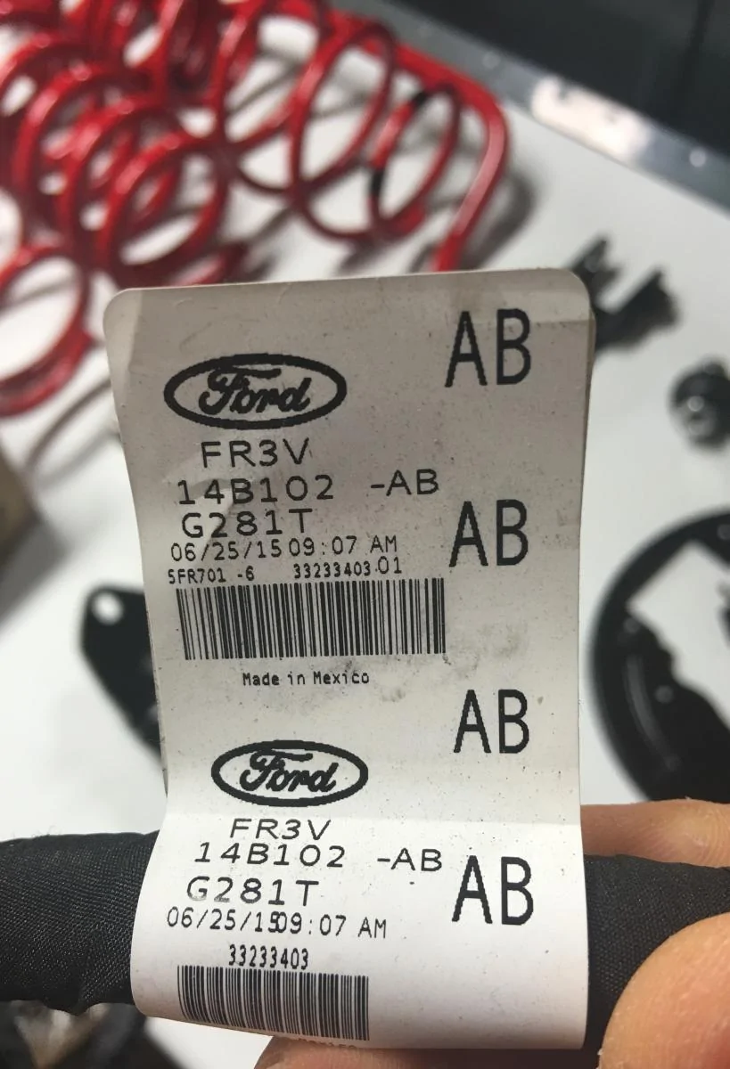

Here's the differential cooler pump harness from my 2016 GT350 track pack

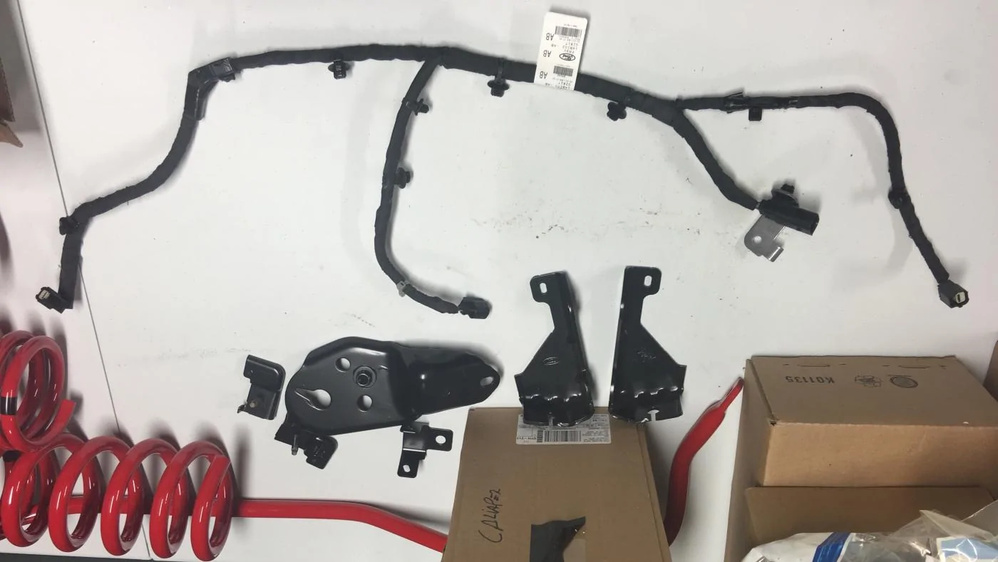

Another pic of same harness
