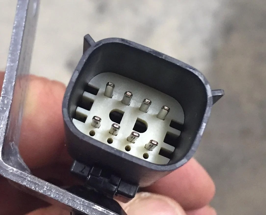

The plug/socket on the pump I have has all six pins in line.
The plug/socket on the harness has 8 pins and 4 side by side in two rows.
See attached pics.
I'm fully willing to cut the 'new' plug off and put a new plug on, but where to get the new socket/plug that's required?

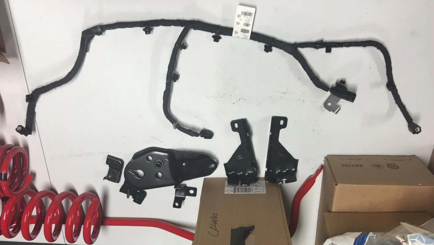

Here is the diff pump harness you tech guys need. This is the harness you guys need to power up the diff pump. This harness also attaches to the exhaust valves, purge valve for the Evap and also the diff lube pump.

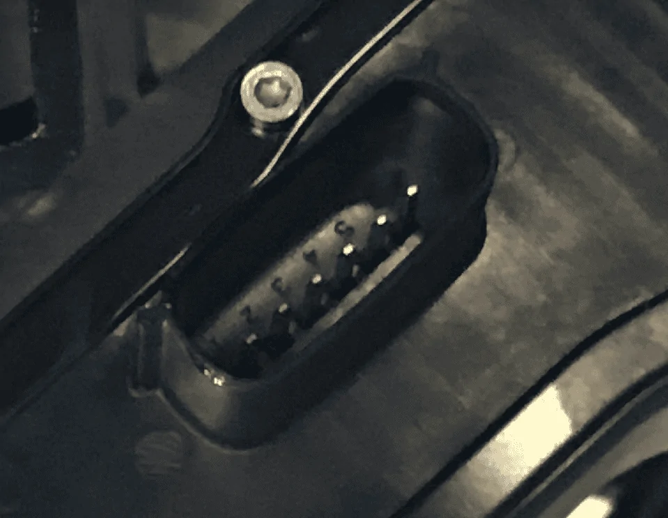

This one you also need for the diff temp sensor. This one is attached to the IRS cradle and is from the chassis main harness. It connects to the diff temp sensor, and both magride level sensors. One on each side. So you have one plug for the main chassis plug, one for the diff temp sensor and two for the level sensors (1 each side)
This harness part (engineering number is FR3V 14B102-AB) the dealer can cross that to a part number for you.

That sounds about right for the connector. I have a wiring diagram open, and C408 (8 pin) is the SVT harness, while the differential pump is 6 pin PWM controlled by the PCM. If you can't find a spot where the new 8 pin connector attaches to the body floor wiring harness, I think you just found out there's a different main wiring loom.

Here is where the 8 pin plus into. Here's a pic of my car. This feeds the diff temp sensor and both left and right suspension level sensors.

This is the diff pump harness.
The pump harness feeds both exhaust valves, the Evap purge valve and of course the diff pump.

Buy these two harnesses and the pump, temp sensor, hoses, brackets and you guys are golden.
This is the pump harness.

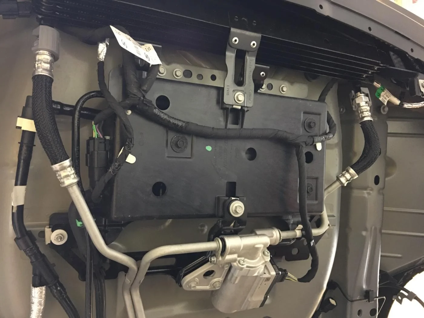

This is the differential temp harness.
But remember. These are considered engineering numbers. Just give these part numbers to your dealer parts guy and he can cross them.
