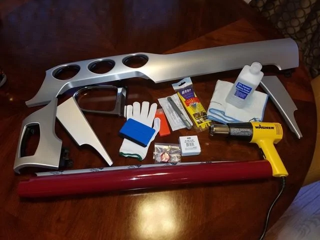

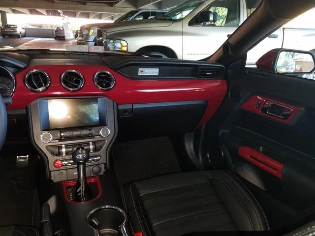

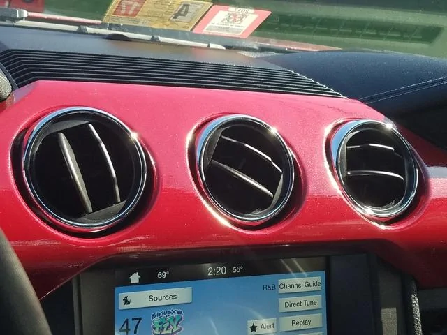

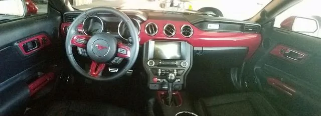

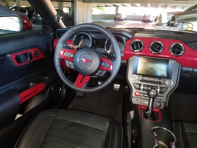

Wanted to share some pictures from my recent interior wrap project. Was pretty fun overall. Panel removal was pretty easy yet terrifying cause it feels like you are going to break something. Came out better than I expected. The panorama is a little blurry, will retake it in better lighting. The last picture is trying to show the metallic in the vinyl. Hard to catch in picture

Here you go.

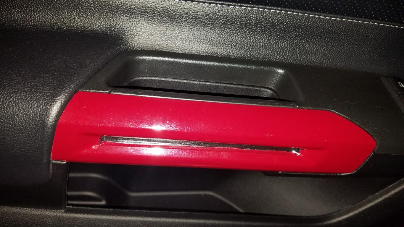

As I loathe chrome, a couple of questions:
1. Did the door handles (not the latches, but the chrome parts on the arm rest) *require* taking out the door panel? How'd you get them off? (videos above don't go to that detail.)
2. How has the wrap held up in wear areas? (Door handles, steering wheel - I can't see you handling the dash too often, nor the shift trim ring.)

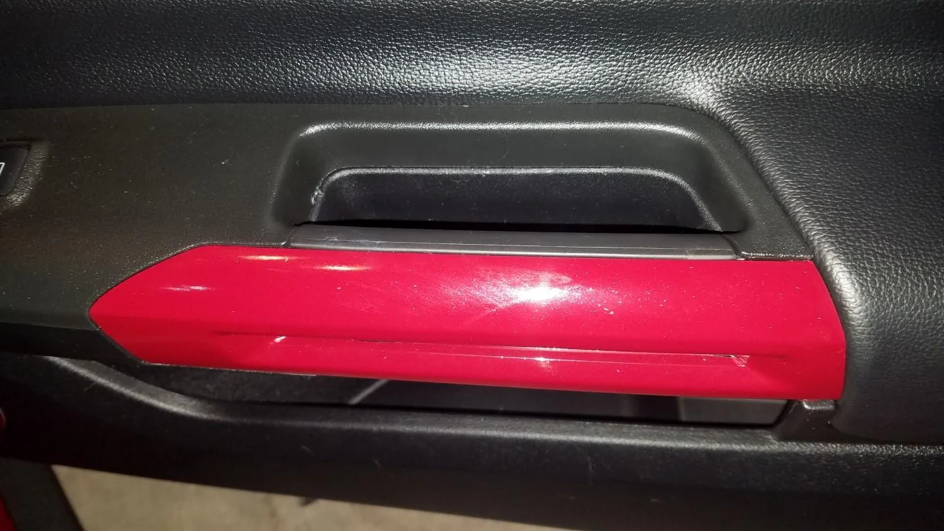

1. You technically dont have to remove the door pulls to wrap them but it does make it a lot easier and it will be very difficult to wrap around the edge with it still attached to the door. Also the part that sits next to the armrest will be a pain. From everything I have learned, tight pieces like this are less likely to fail or lift if you can get a 1/4in around the edge. To remove the door pulls, it required removal of the door card. Once the door card is off, the door pull is held in by screws and comes off really easy. The hardest part is getting the door card off cause popping the clips still makes me think I am going to break something
2. It has held up awesome. There are only a few very light surface scratches on the door pulls which typically cant even be seen unless you use a camera flash or flashlight. There is no visible wear on the steering wheel.
Its just as glossy as when I installed it. You do need to clean surface smudges due to the oils on your hand but those clean right off though with no issue. Below are the door pull as they sit right now. The visible chrome in the middle was my error during wrapping and learning not wear.
Hope this helps. Let me know if you have any further questions.
