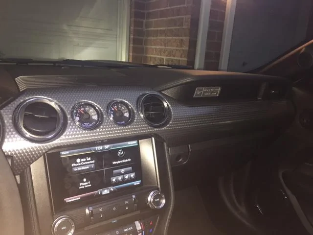

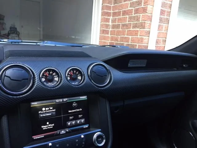

I wrapped my interior panel a while ago with some carbon fiber wrap. Did the whole panel from the lower left all the way to the lower right, which includeds the lighting cluster to the left of the steering wheel.

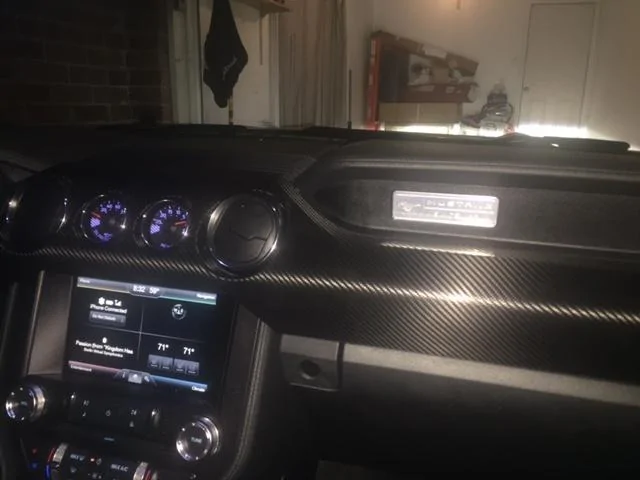

Can you share with me how did you do that? What wrap did you use? 3D, 4D, 5D?
Here is a pic of what I did.

I used 3M Black DI NOC carbon fiber. I removed all the panels from the car and removed the gauges from the center piece. I also did the trim to the left of the steering wheel where the light controls are and the lower left panel.
This is the first time I ever have done any wrapping of any kind, so with that said, if you have any patience and craftful skill this can easily be done. Took me about 2 hours for everything. I watched a bunch of youtube videos on interior warpping to get the general idea and then you live and learn.
Lay the pieces out on the wrap so that the wrap has about a couple inches around the whole piece so that you can wrap onto the back. I messed up the first time and cut too short and had to redo, but a $20 error, not terrible. You'll need a heat gun or hair dryer (what i used) to get the wrap soft around the dials to bend it in. Kind of hard to explain, but once you do it you'll know what I mean.
Interior still looks great, zero wear and I love the finish. Gives a uniqueness to my whip

I just realized the ribbon light you have in yours...how did you do that?? Looks sweet
pockama
Dec 13, 2015
382
San Francisco
2016 MBZ G65AMG, 2016 Ford GT, 2016 RR PHANTOM
I got the blue strips from China. I used one for right and one for left side.
Wired them together.
