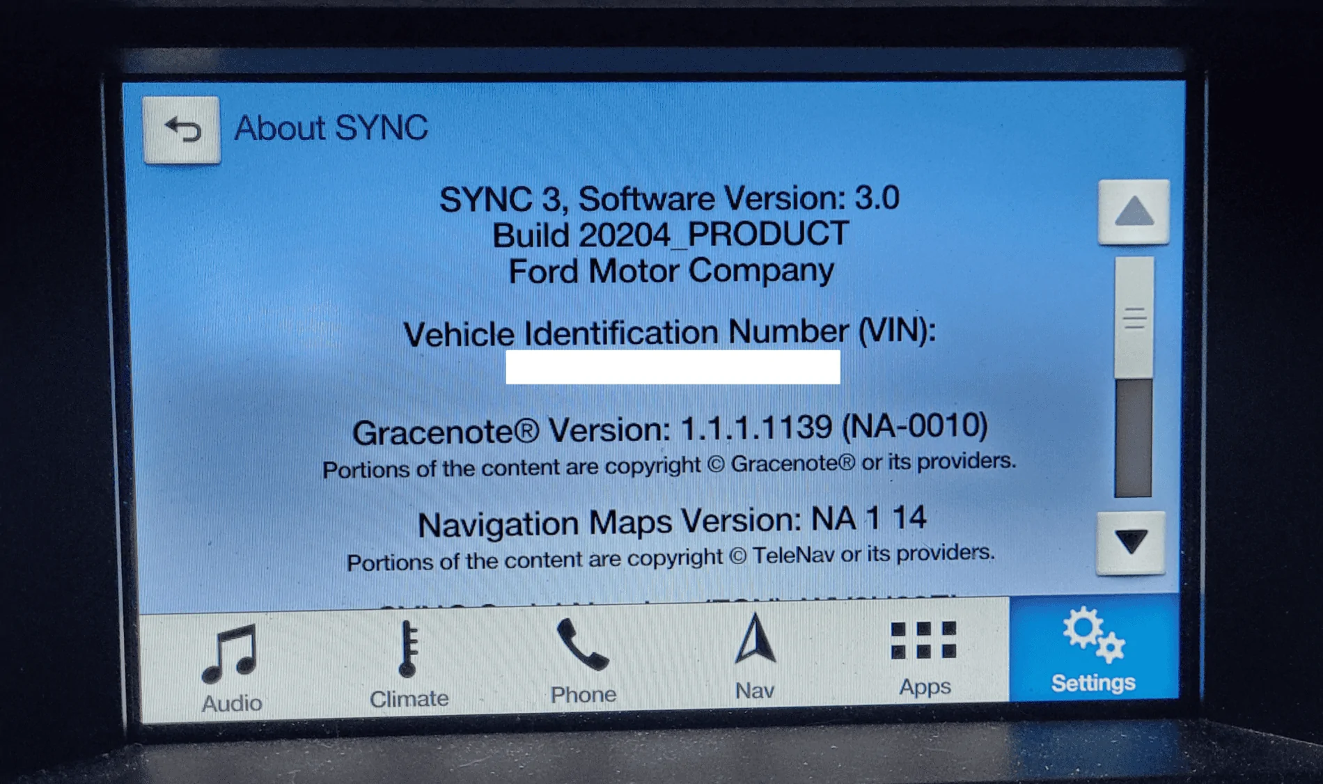

NEW 3.0 BUILD 20204 Official!!
JR3T-14G381-AX
If this is your first time seeing this thread, it might look confusing but all questions have been answered on here.
UPDATED: DEC 12, 2020
JR3T-14G381-AX
(Follow official pdf instructions below) Installation instructions:
1. Download.
2. Unzip onto desktop.
3. Grab a USB Flash Drive, 32GB minimum.
4. Format the drive to exFAT.
5. Put the extracted files inside the flash drive.
6. Turn car on. Turn bluetooth off, just in case(optional). Or master rest before beginning.
7. It might take 5 mins for Updating System Software message to pop up, then 19 mins to install from thereon
Depending on the Ford model, it might reboot automatically after installation is complete, if navigation maps don't come back don't worry turn off/on the car again.

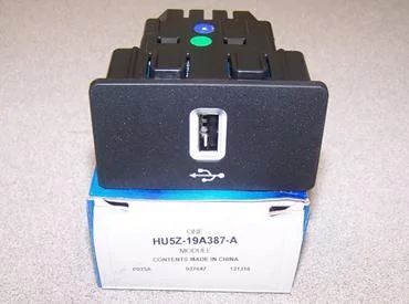

USB HUB: HU5Z-19A387-A
Order here:
Lewittown Ford Parts
Mustang (Confirmed part#) Blue single hub. https://www.levittownfordparts.com/sku/hu5z-19a387-a.html
Ford Parts Giant
Mustang (Confirmed part#) Blue single https://www.fordpartsgiant.com/parts/ford-module-interface_hu5z-19a387-a.html

HOW TO SWAP OEM USB TO USE APPLE CARPLAY: A SIMPLE D.I.Y IN 15 MINS - THANKS TO ALI
Follow Attached pdf files
