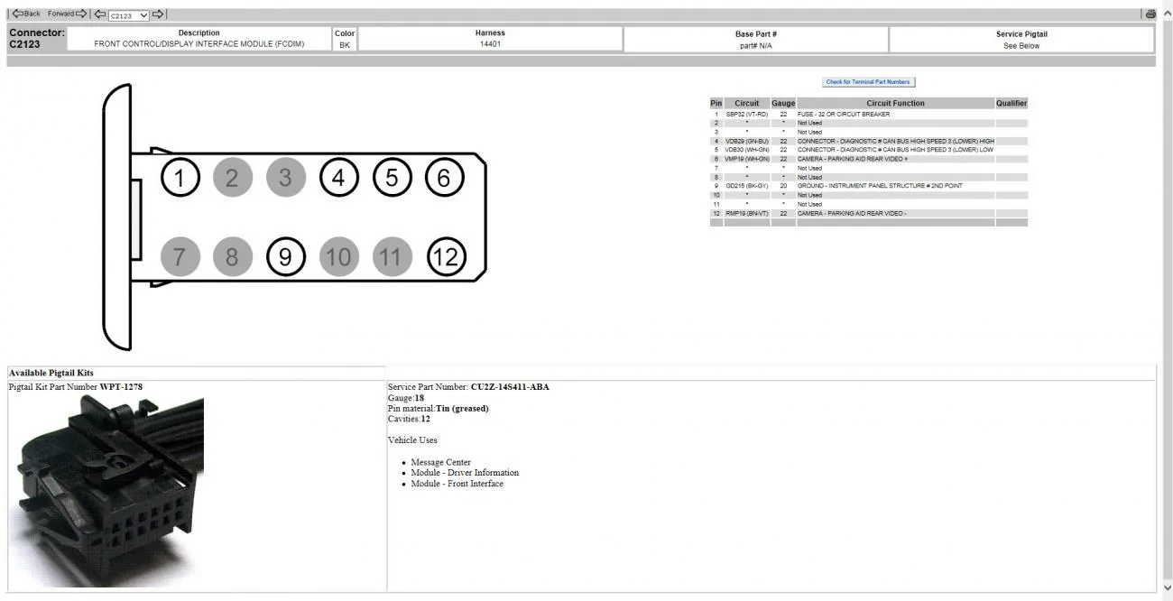

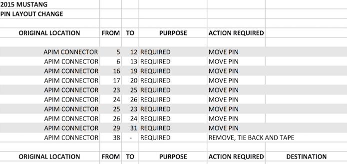

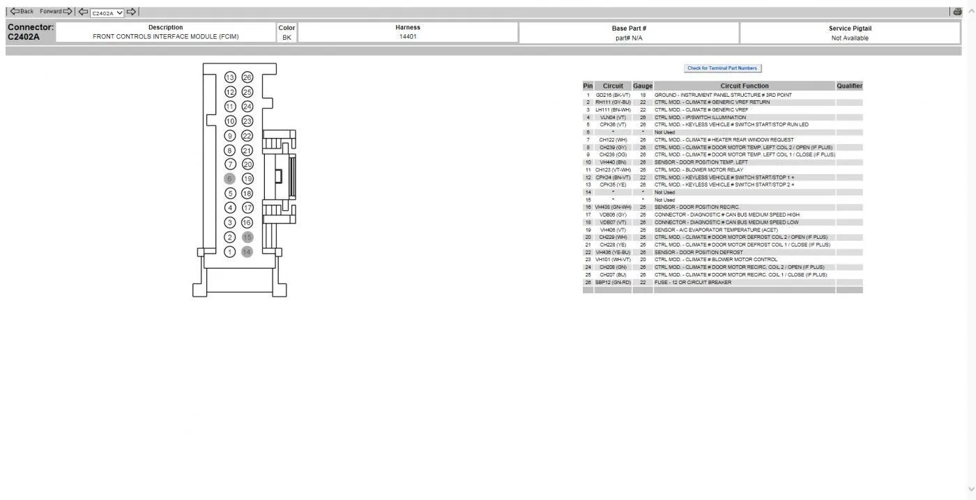

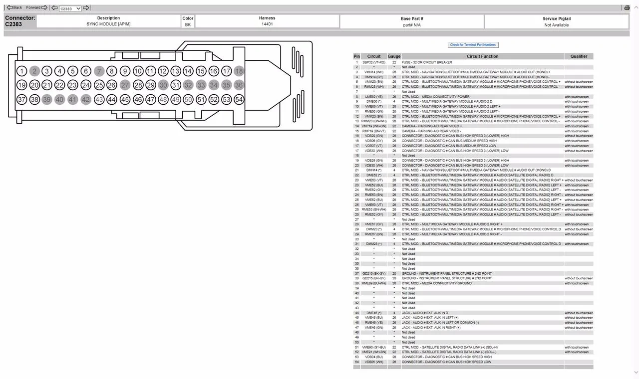

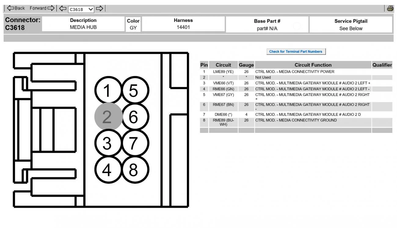

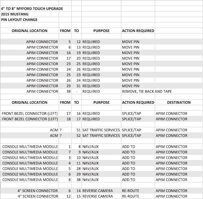

Attached to this thread is a conversion table that shows all of the pins on the APIM (sync) connector that need attention. Some pins have to switch places within the APIM connector and some have to be pulled in from outside sources like the camera leads and MS CAN. Both of these connections need to be tapped into from other harnesses. The camera leads exist in the base 4.2" LCD FDCIM connector pins 6 and 12 and the MS CAN leads exist in the front panel connector. Wiring diagrams below show this. Pins 17 and 18 on the FCIM connector A are the best to tap into to get MS CAN. These then need to be routed to pins 16 and 17 on the APIM connector.

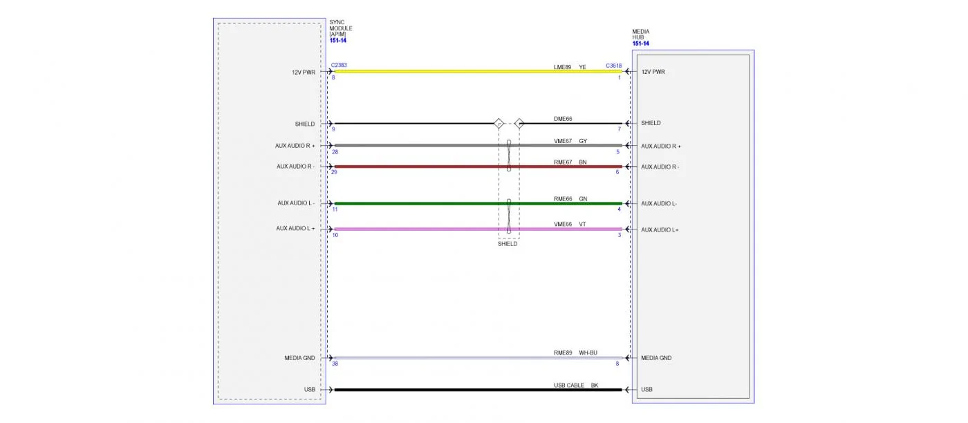

Also attached is the wiring diagram for the Multimedia module. Since base models do not have this module so the wiring is not present. You will need 26, 22, and 20 gauge wire to build a harness for this module.
In addition to this the MFT APIM only has one USB connector so the dash usb port will need to be routed to the rear USB plug on the Multimedia module. The multimedia hub acts like a usb hub basically. You can easily route the dash usb to the console using the original USB wiring. Connect both usb connects (will need micro usb to micro usb adapter) behind the APIM and then at the console end of the original usb port have a USB A adapter to micro USB adapter to plug in to the rear plug on the multimedia module.

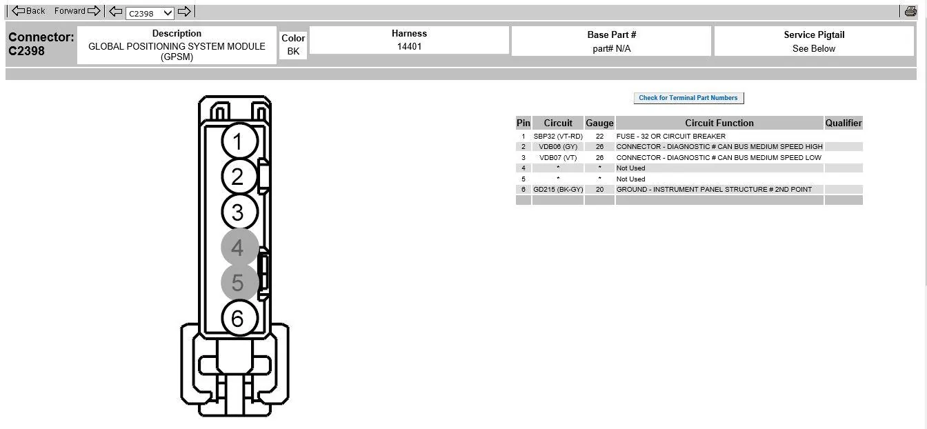

The DIY route for Sync 3 currently includes just the wiring as sync 3 systems are near impossible to find on eBay. Acquire the sync 3 system from OEMRadio. The good news is that Sync 3 requires less wiring then MFT! Follow the picture below for DIY sync 3 wiring. Sync 3 does not require the sd card multimedia module so this simplifies the wiring to just swapping around pins and adding 4. Those 4 to be added are the rear view camera leads and MS CAN leads. Tie into the rear view camera leads just as MFT above. With the MS CAN leads though, these can now be tapped into from a separate location without the need for splicing! Sync 3 no longer requires the GPSM in base models to function so this module can be removed and the connector can be used to add the MS CAN leads to the APIM. The connector uses a standard Arduino pin header which is very cheap to purchase and would allow for a plug and play MS CAN connection without the need for wire splicing.
Pin 2 from the GPSM connector will go to Pin 16 on the APIM connector
Pin 3 from the GPSM connector will go to Pin 17 on the APIM connector
NOTE: Remove the GPSM under the center top cover on the dash when installing Sync 3. It is no longer needed.
Credit to [MENTION=26132]nerdh3rd[/MENTION] for providing me with the GPSM connector view!

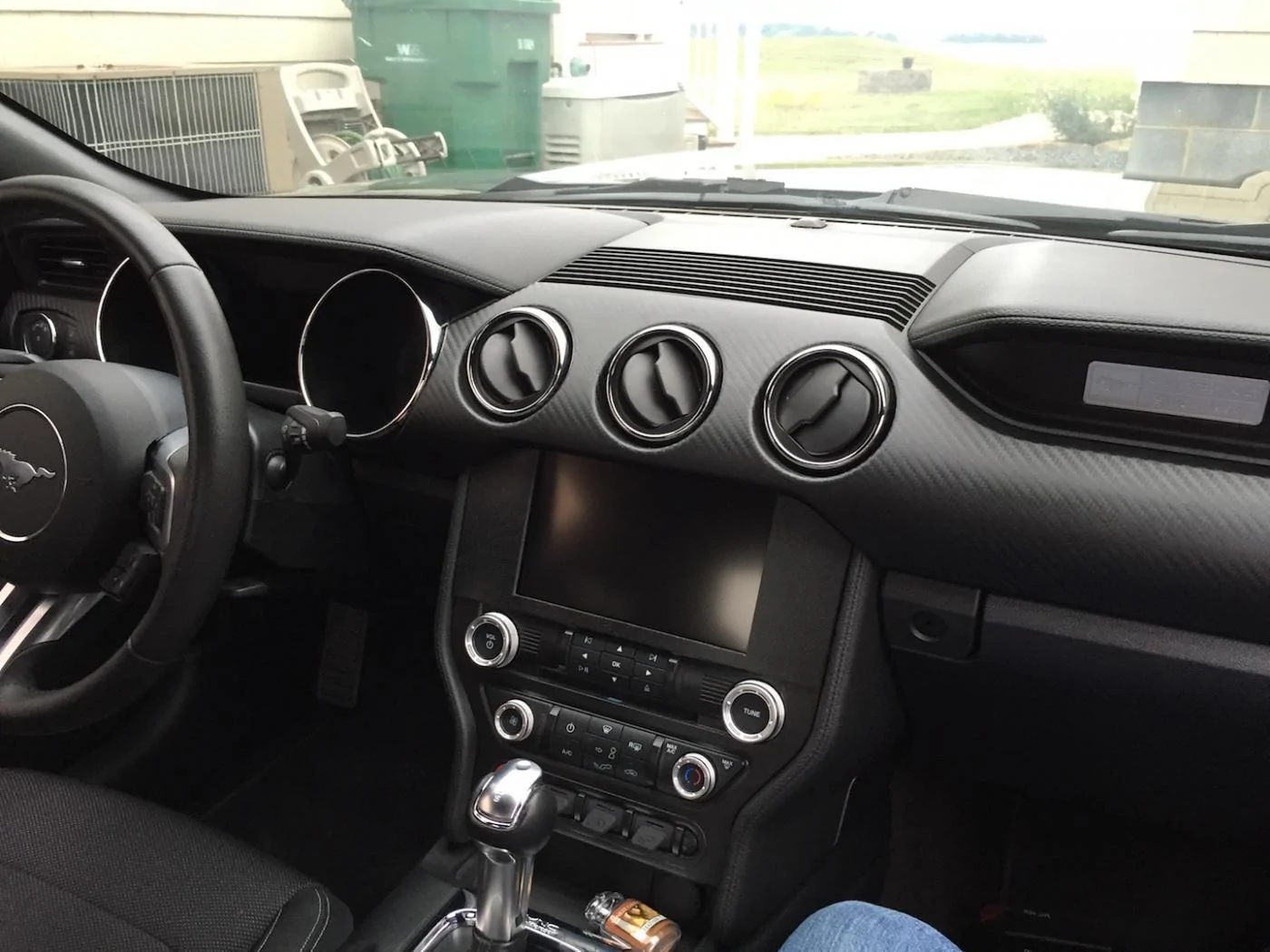

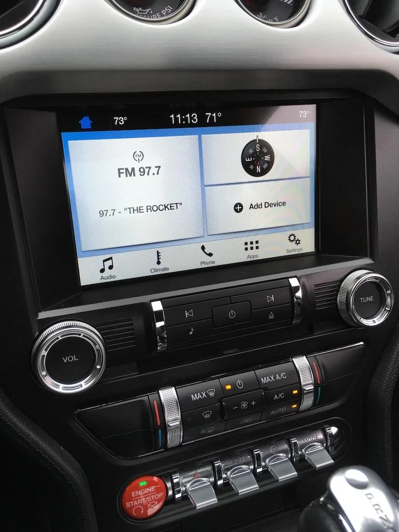

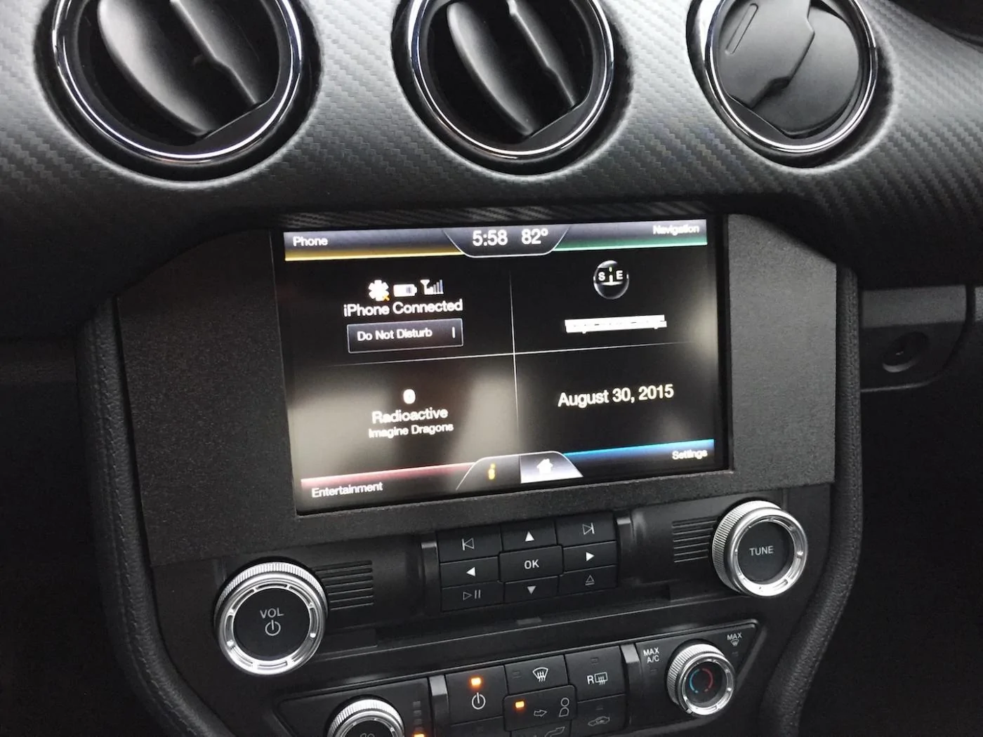

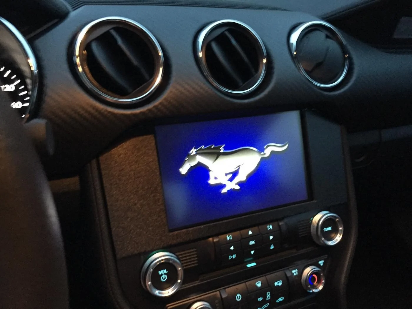

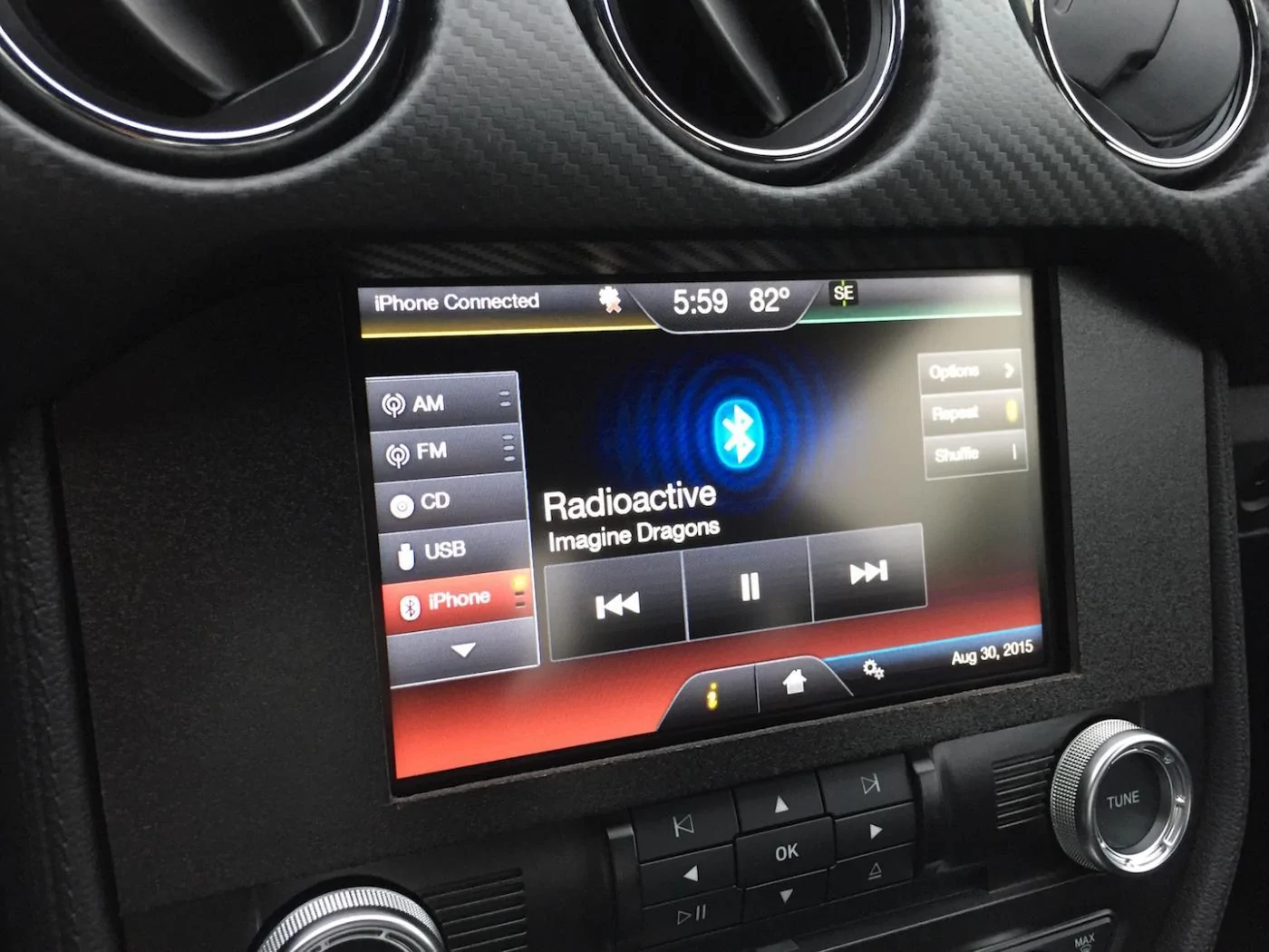

Installed pictures and videos
[ame]
[ame]

Thanks guys! My printed bezel should show up Tuesday! Once I get that in I can truly finish my install.

Dude that looks great. Can you post a vid with the car in reverse showing the backup camera and please post pics of that printed bezel.:thumbsup:
