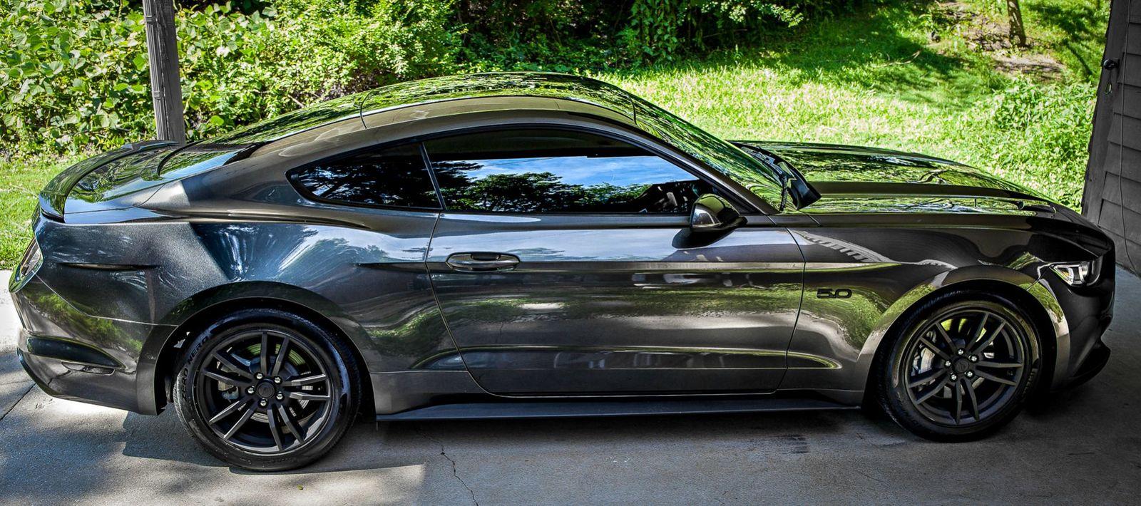

Finally got the balls to attempt a heavy cut

It's a new car and I have been babying the paint thus far, but today I gathered the courage to cut the exterior paint with a denim pad and some M105. There's still some factory orange peel left, but I'm really happy with the results.

:eyebulge: that looks great!!! how long did the whole process take you?

Funnily enough I timed my work today. 6 hours and 10 minutes. But that was the entire process including setup and take-down time.
1. wash
2. blower-dry
3. clay
4. denim pad and M105
5. MF finish pad and M205
6. MF finish pad and synthetic sealant
Going panel-by-panel takes time and you have to be very careful with compound on a denim pad, it's like 2500 grit-sandpaper.

Thanks NotBlake...you answered us. Makes me look like the "slacker" that I am. I can only wash and dry without having to take a nap! Lol.

Whoa...dude! You are a magician! That looks fantastic. How long? Do tell us your secrets?
No real magic here. Unfortunately, today's painting techniques are optimized for effiency ($$) not quality. This is often realized through a thin orange-peel-texture clear coat which is good on consumption and protection, but crappy on clarity. Cutting down the peaks of that clear coat results in increased clarity at the cost of protective clear coat thickness.
I fully intend on maintaing a layer of synthetic selaant at all times to make up for this reduced protective layer, but yeah, denim pads are a nice trade-off between wet-sanding an traditional polishing.
If there's enough interest I might make a video showing the process.

Thanks man, honestly this is risky, so it's not an issue of lazyness or anything like thant, I'm cutting away at my protective clear coat for clarity so really I'm the fool here.
Plus a little photography skills never hurt anyone. ;)

Damn dude is that the T1000 terminator? Speaking of, the trade-off, this is definitely a no-brainer if you're fortunate enough to keep your car under cover or have a garage.

I am not familiar with these products... so the 105 is the rubbing compound and the 205 is the Polish?

Dude that car looks sick! Well done!!!

Yeah make a vid ... Your car looks amazing.

Very good stuff. Have used 105 and 205 for many years. Moved on to some other polishes since but still good products.
I do not have the balls to hit the car with a denim pad. At least not M105/Denim combo.
Great results.
