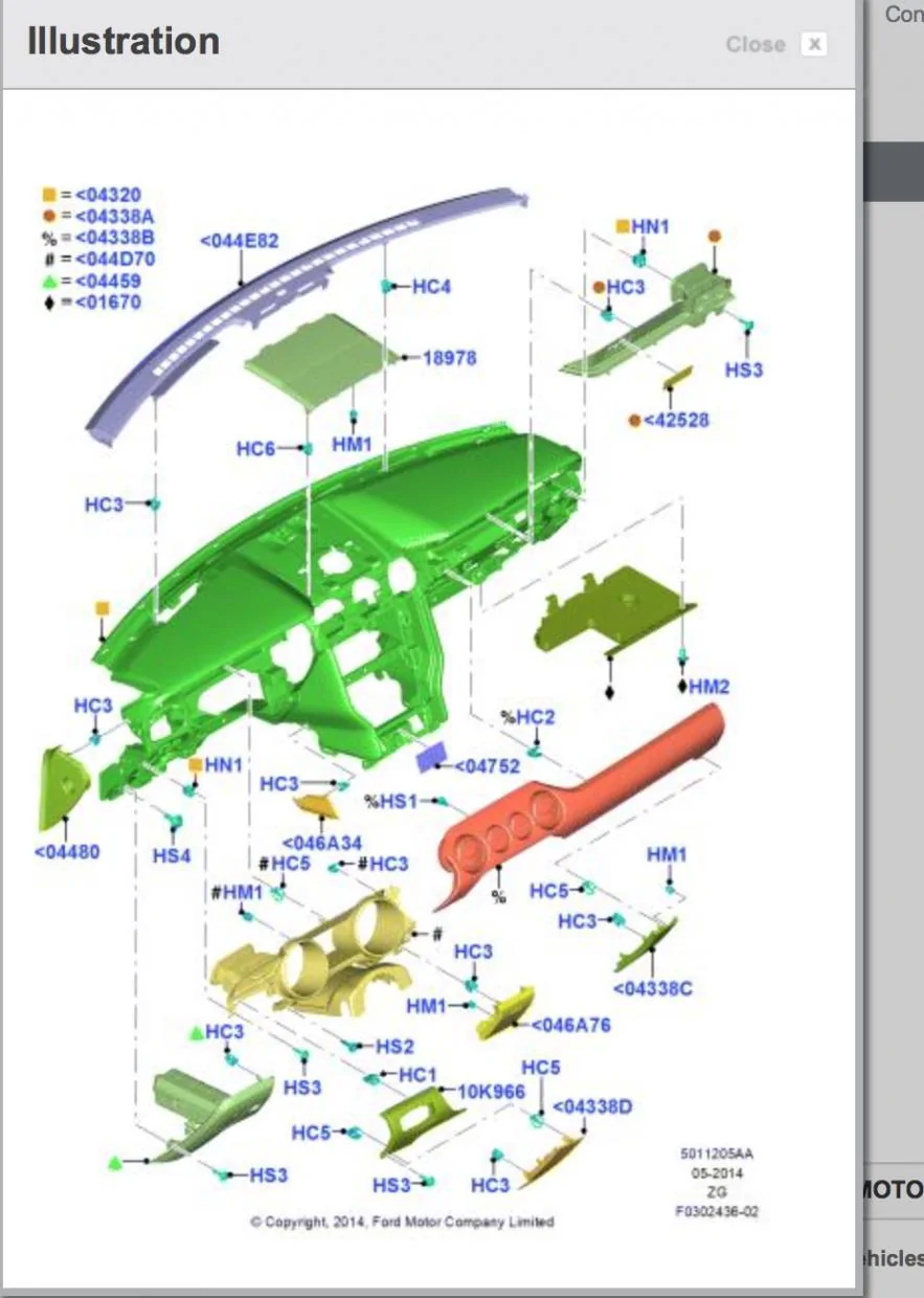

I hope I'm wrong but at some point I looked up the parts diagram for the dash and it sure looked like the eyebrows were part of the actual dash panel, meaning the dealer would have to remove the entire dash assembly to replace it. Every. Single. Thing. That scares the living hell out of me... can you imagine how many rattles??? :eyebulge: I'd probably just have to live with it.

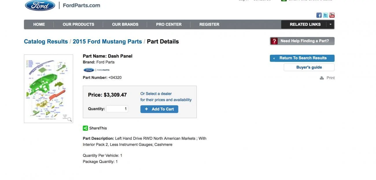

Dealer called back today, and Ford is approving it. They need to pull the entire dash to replace it, and she even told
me the part is super expensive all on its own. So I'm gonna bite the bullet and have them replace it. Have to keep the car overnight for them to do it. I just want it done the right way.

it appears that some members are having the same issue i am with the bubbling dashboard. After some research, i found out what part it is that they are replacing.
I have attached two photos of the part. the part # is 04320, and it is the green dash shell.
The two pads, according to the illustration, is built into the SHELL OF THE DASH. The tech has to disassemble everything related to the dash just to change those two pads.
I decided to take the chance because i didn't want the other side to start and then eventually spread. So lets see how it goes.

That is INSANE that those aren't separate pieces attached to the dash panel itself. :crazy:
Wow.....
