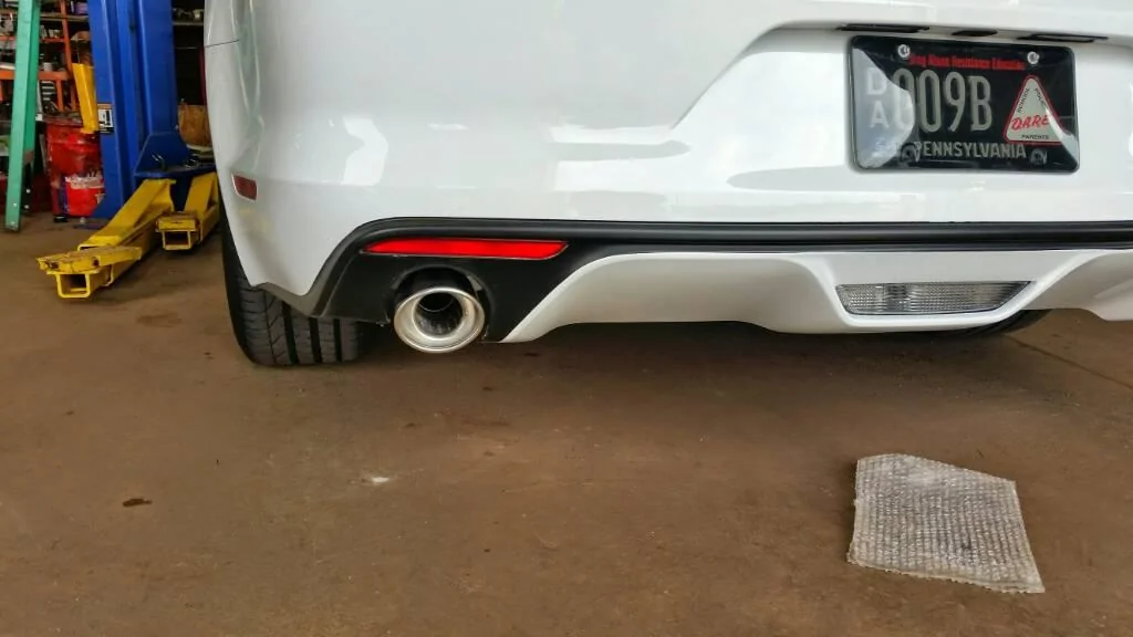

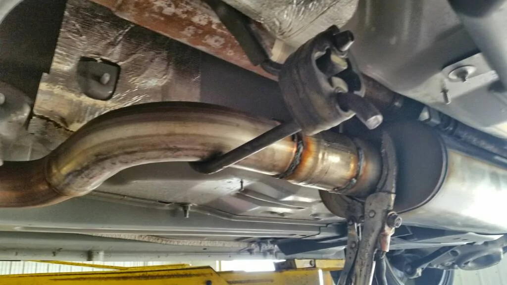

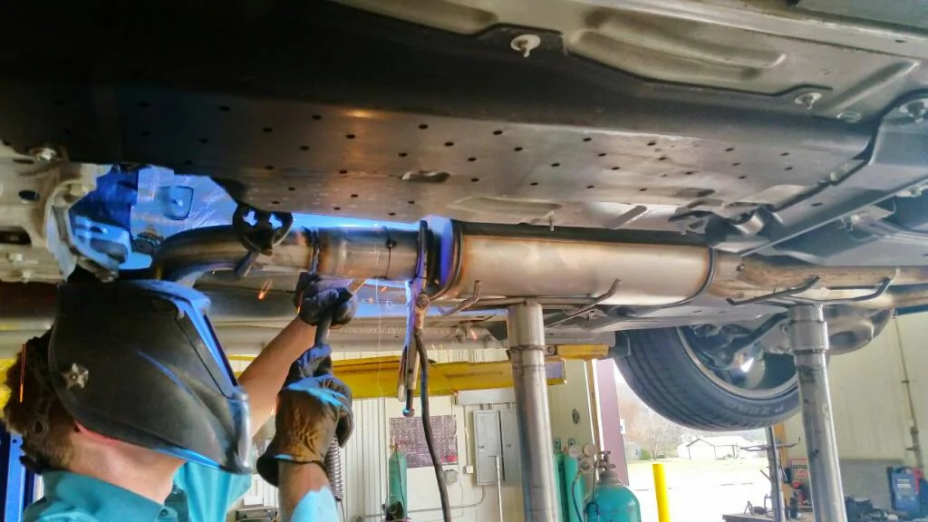

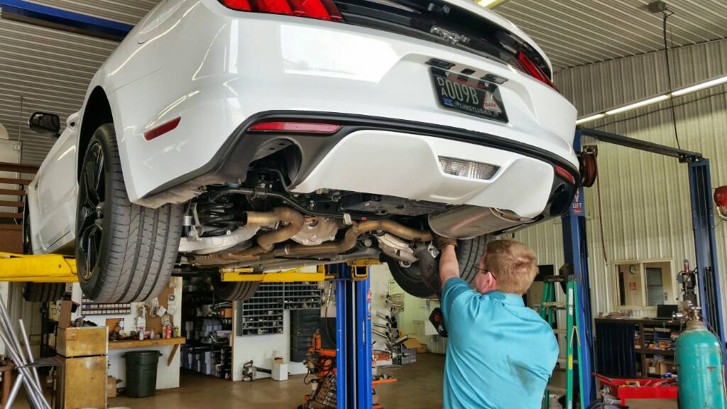

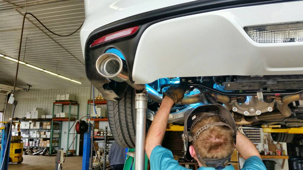

Cut out the resonator
Weld in 3 inch mandrel bent 90° from the factory down pipe to the 3 inch inlet of the straight through design muffler.We took out the flex piece on the factory pipe.
Weld in new muffler. 3 inch inlet dual 2.25 outlets. http://pages.ebay.com/motors/link/?nav=item.view&id=171524686727&alt=web
Keep factory piping .

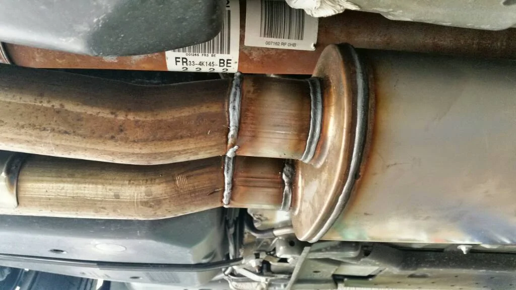

Cut out mufflers before the 90° bend.
Weld in new 2.25 straight pipe.

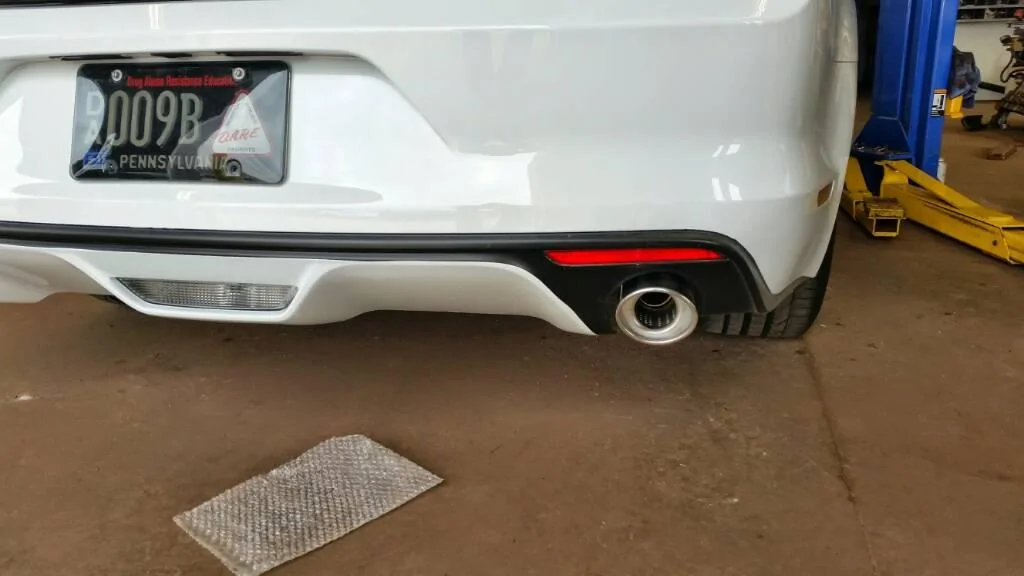

Weld on 2.25 inlet resonated tips.
I will say I'm not happy with the style of the tip sometime soon I hope to change them to more of a resonated round slash cut.

Yeah, the tips are a little funky, check out the Borla resonated tips. They have a very nice appearance.

Yes dragon you and ericRN inspired me.
Will do on the tips.

Turbo's need that flex, don't be surprised if you end up with an exhaust leak.

I have had 4 turbo cars that did not have a flex pipe from the factory and never had a leak issue. 3 of the 4 had well over 200,000 miles on the factory exhaust, the 4th had about 130,000 miles.
Don't think it is much of an issue especially with the longitudinal mounting of the engine.

Dgc333 it's all about the engine mounting. That's why I'm not scared

I went this route last Saturday (replace resonator with muffler and delete stock mufflers). The sound is perfect! Nice bass tone, not too loud, and just enough exhaust note in the cockpit to let you know what the engine is doing. I went with 4 inch tips. The improvement in looks alone was well worth the $ spent. I ended up spending $270 for the work and tipped the technician $20. Thanks EricRN and EcoboostJim for leading the charge on this mod and sharing the Intell. :headbang:

There is a perceptible increase in power and overall efficiency at reaching speed with the exhaust mod. Combined with the JLT CAI and Unleashed tune, the car is my version of automotive perfection. The muffler is a high quality Magnaflow type; straight through (not chambered) with one input and two outputs.
