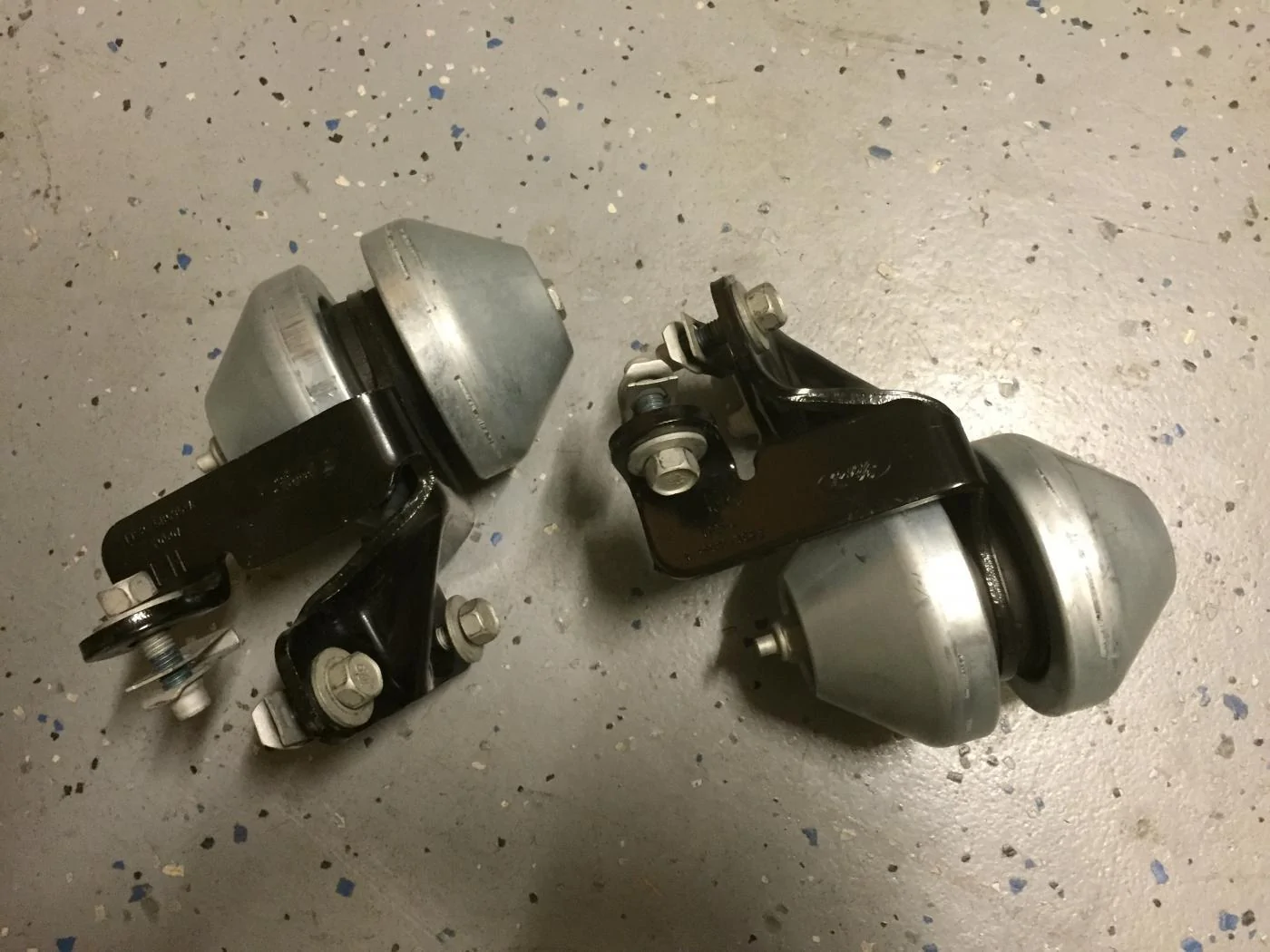

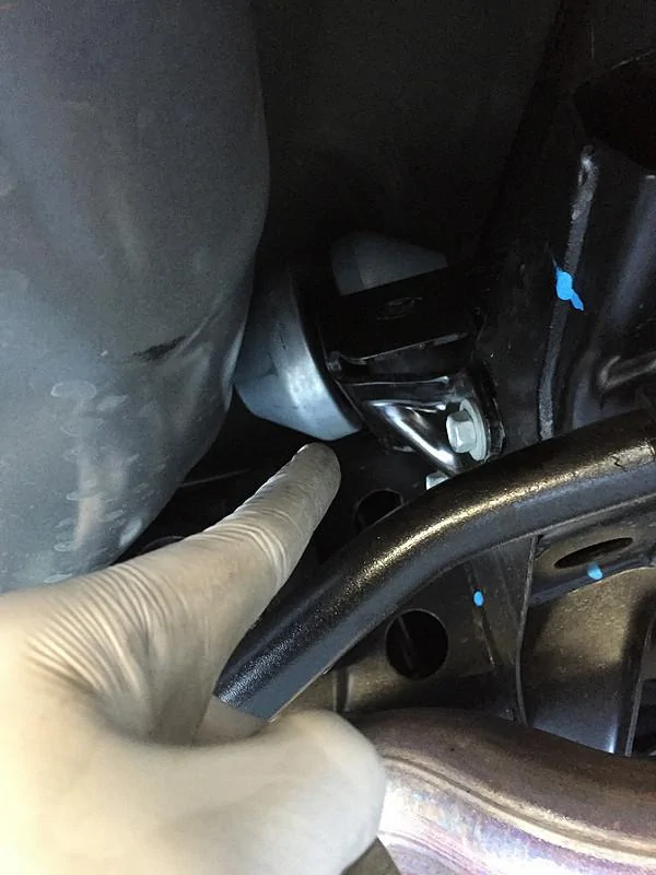

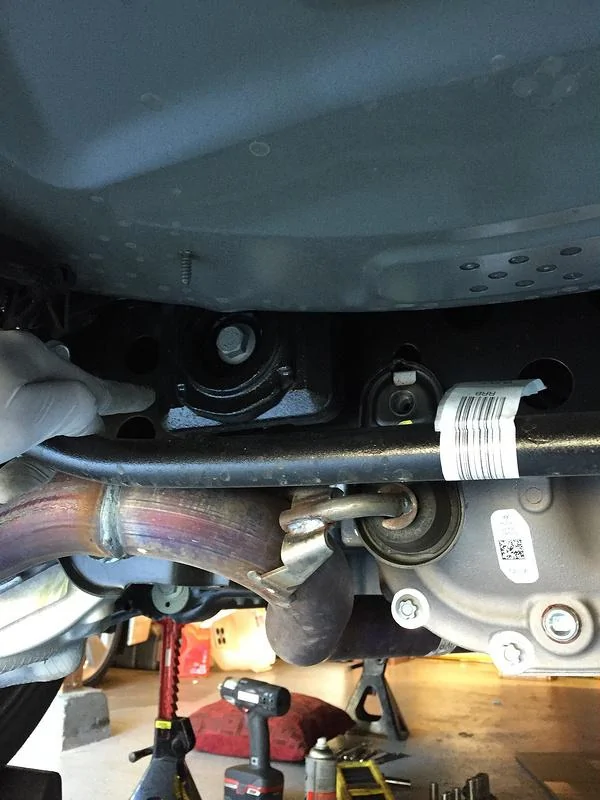

After being under the car for a bit I noticed 4 odd items on the subframe. Two cast black square pieces that bolt into the rear diff cover. And also two silver egg shaped items that bolt to the top of the subframe.
I spoke with Kelly from BMR and the GTs do not have this. Next time I have the car up I'll probably go ahead and remove them and get a weight. Has anyone removed these yet?

No problem, no change at all.
These will not be going back on haha

They are out, they weigh 11.8lbs bolts and all.
They come out very easily. Just need a 13mm ratchet
