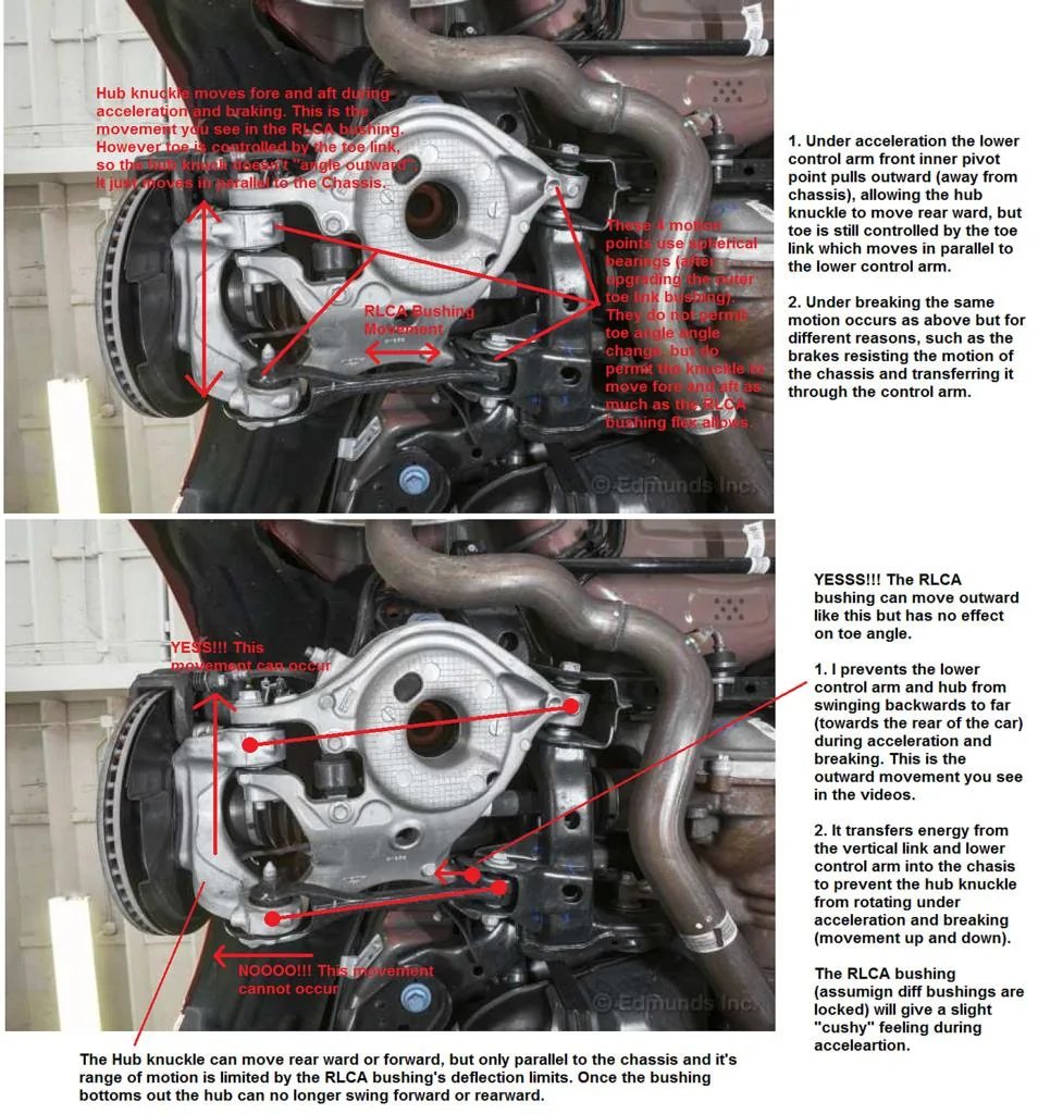

I've done some thinking and one thing that I think would make the car easier to drive on corner entry is the non-PP GT swaybar. The bar itself is identical (so identical roll stiffness), but it does not have the integrated 'sticky' bushings that were added to sharpen on-center response. If you don't desire an increase in front bar stiffness, this would be a good suggestion to make it a little easier. I think the next thing to address critique number 2 are the RLCA bearings (BK055 or BK081) and to a much lesser extent, TCA048 vertical links.

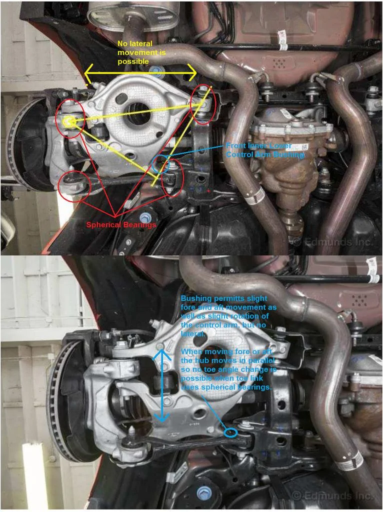

RLCA bearings only allow forward and aft rotation of the lower control arm around the rear pivot point which already uses a spherical bearing stock and a very small amount of vertical "rotation" or "twisting" of the arm until the bushing bottoms out and I do mean SMALL amount that only matters in high HP drag cars that can result in a very minor amount of wheel hop. The stock bearing configuration does not allow horizontal movement because the back inner and outer rear are Spherical Bearings stock. When you add in spherical bearings to both toe link ends, toe angle can no longer change either.
Unless your drag racing, there's nothing moving laterally with his setup in the control arms. There is only one bushing on the lower control arm and knuckle assembly that's rubber in his setup and that's he RLCA bushing you mentioned.
His described movement may actually be the IRS lockout kit's limitations for controlling lateral movement or possibly tram-lining of the rear end due to wider off-set wheels (yes the rear has a scrub radius just like the front). The tubular braces, while strong, are taking all of the IRS lateral movement the stock bushings cannot manage in their permitted movement range until they bottom out, which is quite a bit of energy. I have a hard time believing two single tubes by themselves can avoid flexing in extreme g cornering, especially under load.

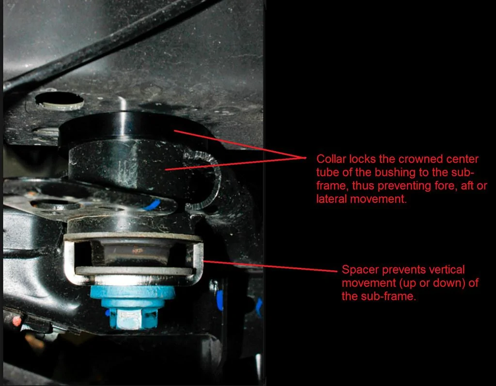

The vertical movement of the IRS is already well controlled by the steeda lock out collars which work just fine and don't permit any vertical deflection (up into the chassis or down away from it), but they do nothing to control the fore, after, or lateral movement which is entirely handled by their tubular supports all of which is transmitted to the bend radius which acts kinda like a sway-bar that resists lateral movement of the IRS.
There are other ways to lock out the IRS sub-frame which are more effective and lower in weight. Each has it's pros and cons. The Ford Performance sub-frame bushings fully lock out the IRS movement in a very similar way to BMR's CB005, but they are a permanent and involved modification as the replace the stock IRS sub-frame to chassis bushings entirely.
The BMR CB005 aluminum top rings lock the crowned center tube in the stock sub-frame to chassis bushings to the sub-frame itself, thus preventing their movement. The concept is the same as the Ford Performance Aluminum Sub-frame bushings, but it's not permanent if you want to return it to factory and is much easier to install because your just sliding a few locking rings over the existing bushings.
It controls by far the majority of the sub-frame movement and adds only 4 lbs. The entire kit weighs 6.5 lbs, but your replacing the stock front bushing to sub-frame supports with their own supports. The stock supports weigh about 1.25 lbs each so your net weight gain is only 4 lbs. It's easy to install, self centers the IRS (the BMR supports double as alignment bushings to the front two bolt holes). It's by far the most efficient IRS lock out kit on the market.

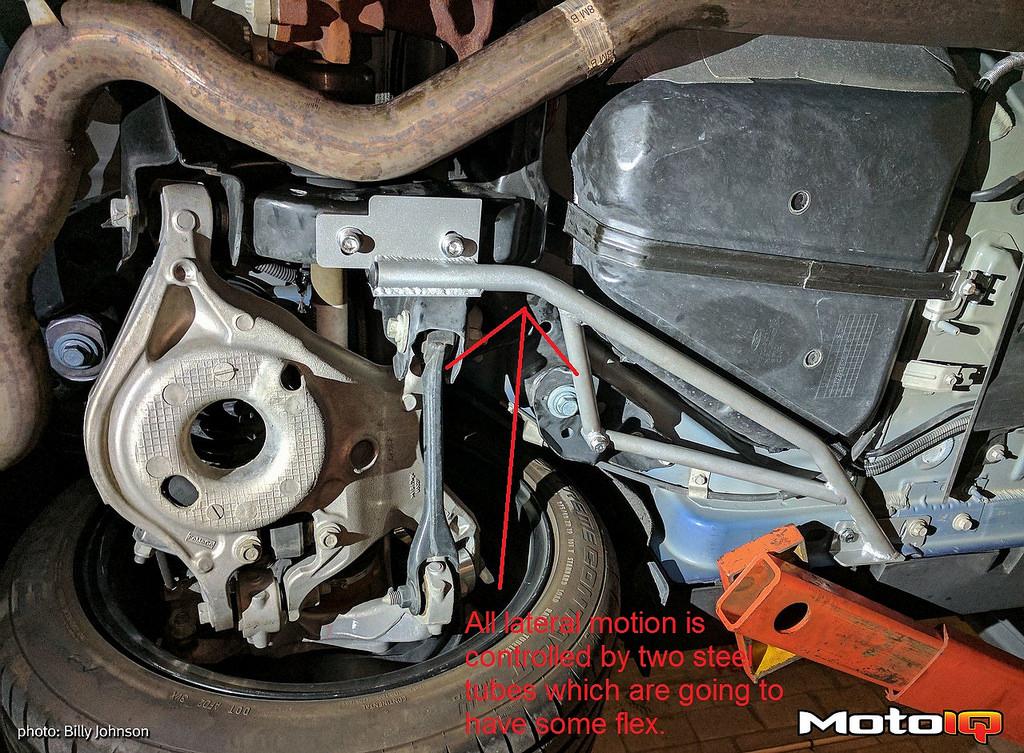

I want to add a clarification about what is in my Steeda kit. I have the IRS subframe bushing support system (555-4447), and that kit does NOT include their subframe braces (555-5754). It was not a matter of choosing to include them or not (or choosing Steeda vs BMR); it was simply that at the time of purchase I happened to get lucky and get a screaming good deal on the 555-4447 kit.
I mention this in particular because one of the photos posted by TheLion shows a subframe brace to control lateral movement that I do not have. I am very interested in your thoughts about that (or the lack of such support) being the source of what I am feeling.

[MENTION=32569]J.P.B.[/MENTION] You will need the subframe braces to complete the job that the CB005 does, that Bluemustang and I have. I'd recommend doing that or going to the CB005. Either way you'll definitely notice another improvement.

The RLCA bearing does NOT allow toe angle change. The video you posted shows an S55 that has rubber bushings in the outer toe link end where it attaches to the hub knuckle. Of course the toe angle is going to change because the outer toe link end has a rubber bushing during that test. The RLCA bearing's movement has NO bearing on Toe angle. Toe angle is controlled by 4 points, being the inner and outer toe link bushings, the rear inner and outer lower control arm bushings. 3 of those points are spherical bearings stock on PP cars with the outer toe link bushing now being upgraded to a spherical bearing by the OP.
Look at my first image, please explain how it's possible for the toe angle to change if the Toe link has spherical bearings in both ends like the OP said he upgraded to? There are 4 points of motion. The RLCA bearing plays no role in toe angle.
It's primary purpose is to transmit load energy carried by the vertical link into lower control arm and ulimately the sub-frame. It doesn't matter if it moves outward slightly because the toe link forces the hub to move in parallel relative to the sub-frame. The RLCA bushing may pull outward a bit because the lower control arm is moving backwards (toward the rear of the car) slightly until the RLCA bushing reaches it's limits of travel.
The RLCA bearing as a small impact on wheel hop as do the vertical links only in Drag racing applications. For track, Auto X or Street use, spherical bearings in the toe link at BOTH ends, differential bushings and cradle lock out eliminates toe deflection, any possible lateral movement (side to side) of the suspension and sub-frame and drastically reduces wheel hop in power down situations. If your a drag racer, by all means upgrade the RLCA bearing and vertical links as there is some measure able benefit in further reducing wheel hop.
For street, auto x and track it's not going to really benefit you and may make the car a bit edgy in corners (what others have reported). Some small compliance keeps a car from having so much edge it becomes hard to drive. Too much compliance makes it a mush box that's difficult to drive at it's limits. The trick is to balance the car. I think we get too caught up in replacing crap because vendor X says it will make it better or because we don't fully understand it's application....but I digress, both videos show exactly what I'm talking about.
You need to fully understand the rear integral link's theory of operation to understand it's motion paths and load paths. But hey, if you want to spend the money for an RLCA bearing and the absolute butt pain it is to upgrade it, by all means have at it!
Here is a great article that illustrates and explains the IRS Integral Link design at a good level of detail and further reinforces what I'm trying to explain: https://www.edmunds.com/ford/mustan...15-ford-mustang-gt-suspension-walkaround.html
The front RLCA bushing more or less is a load path to control Knuckle rotation and limits rear or forward movement of the hub / lower control arm. It does NOT control toe angle in any way.

You're correct in that the main toe control points are the link and the rear of the control arm points to the subframe and knuckle. The outer point of the arm that connects to the knuckle moves with the arm, so any time that you get deflection at the forward control point, your rearward outer point is coming with and rotating about the rear inner point. The only way this wouldn't induce toe change is if the toe link and the rearward control arm point distance were identical length and completely parallel.
Having said that, you also do get dynamic caster with the motion of the control arm via the forward bushing, since it will effectively shorten/lengthen the height of the vertical link. This means some camber change outside of the geometric change.

You're correct in that the main toe control points are the link and the rear of the control arm points to the subframe and knuckle. The outer point of the arm that connects to the knuckle moves with the arm, so any time that you get deflection at the forward control point, your rearward outer point is coming with and rotating about the rear inner point. Having said that, you also do get dynamic caster with the motion of the control arm via the forward bushing, since it will effectively shorten/lengthen the height of the vertical link. This means some camber change outside of the geometric change.
Right, but the toe angle change is linear and pre-defined. It's not erratic or unintended and it's VERY small and it's not really because of the RLCA bushing itself. The stock RLCA bushing doesn't move a lot. A few mm which isn't really going to result in a lot of meaningful toe angle change (due to the slightly shorter toe link / to rear arm ratio) and that change when it happens is linear and pre-defined as to how much can occur.
My general point was, the RLCA bushing isn't going to make a difference for track type applications. Money and time for it (considering it's a major butt pain to even do) is far better spent on sway bars, springs, dampers, toe link spherical bearing upgrades, sub-frame lock outs and differential bushings and eventually some power adders.
It's really a drag racer specific item for those with high HP FI setups. For NA it doesn't really matter (ask Braski, even with stock IRS and a Power Pack 2, with a good set of DR's the car doesn't really hop much as there's enough traction even when launching fairly high up around 5k).
Sure, throw enough power at any car and your going to have to replace just about...everything. But that's not 99% of our applications and that's why I'm sticking with my point of argument on this and the vertical links. The benefits just really aren't there for track / street / auto x applications and that little bit of compliance gives the car just a little less edge to keep it a little more forgiving. Great cars are easy to drive and drive themselves, not a razors edge basket case.
I never suggested they don't have an impact, they do, but it's not meaningful for the OP's application and issues. Anyway, I think we can move on as we are all in agreement on this enough so that nobody is going off the deep end and we have all helped the OP to find a solution specifically to address that occasional "rear end squirm".

Right, but the toe angle change is linear and pre-defined. It's not erratic or unintended and it's VERY small. The stock RLCA bushing doesn't move a lot. A few mm which isn't really going to result in a lot of meaningful toe angle change (due to the slightly shorter toe link / to rear arm ratio).
My general point was, the RLCA bushing isn't going to make a difference for track type applications. Money is far better spent on sway bars, springs, dampers, toe link spherical bearing upgrades, sub-frame lock outs and differential bushings.
It's really a drag racer specific item for those with high HP FI setups. For NA it doesn't really matter (ask Braski, even with stock IRS, with a good set of DR's the car doesn't really hop for common pump gas NA setups).
I never suggested they don't have an impact, they do, but it's not meaningful for most of us and it may even have some negative side effects like making the car a bit overly edgy on the track. We want a balance and balance means some controlled and purposeful compliance. No compliance on everything = extremely edgy hard to drive car.
Believe it or not, we agree on pretty much everything lol
Yes the change is small. The more serious/racecar you get, the more that small things like that are noticeable. There are definitely some benefits that are noticeable with removing that movement and the small amount of binding that bushing can cause during suspension travel (because of how Ford uses those indexing 'teeth'). There are some potential disadvantages too, as you pointed out. I would say whether or not it produces edginess on track is going to be dependent on the rest of your setup and your alignment settings.
