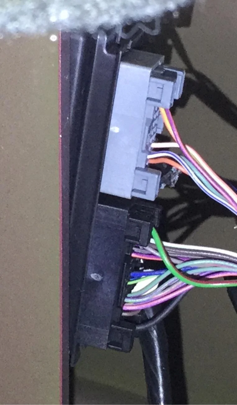

I saw a factory Shaker subwoofer for a 2015-17 and wanted to upgrade mine poor audio on a budget. I looked in the trunk and found these connectors. Are one of these the subwooker connector?

Short answer; No
Long answer: Ford chose not to run the cabling for the subwoofer in non-ShakerPro vehicles, so if your car didn't come with a sub from the factory you either have to run the cable for the factory sub or tie into the rear speakers for an aftermarket sub.
