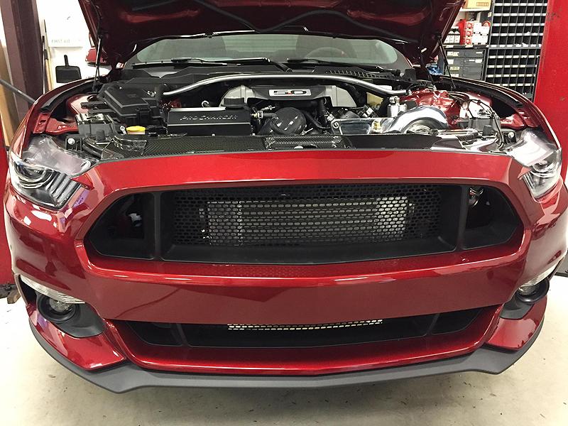

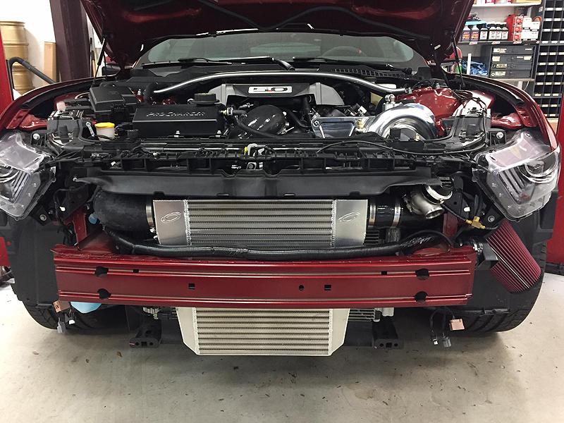

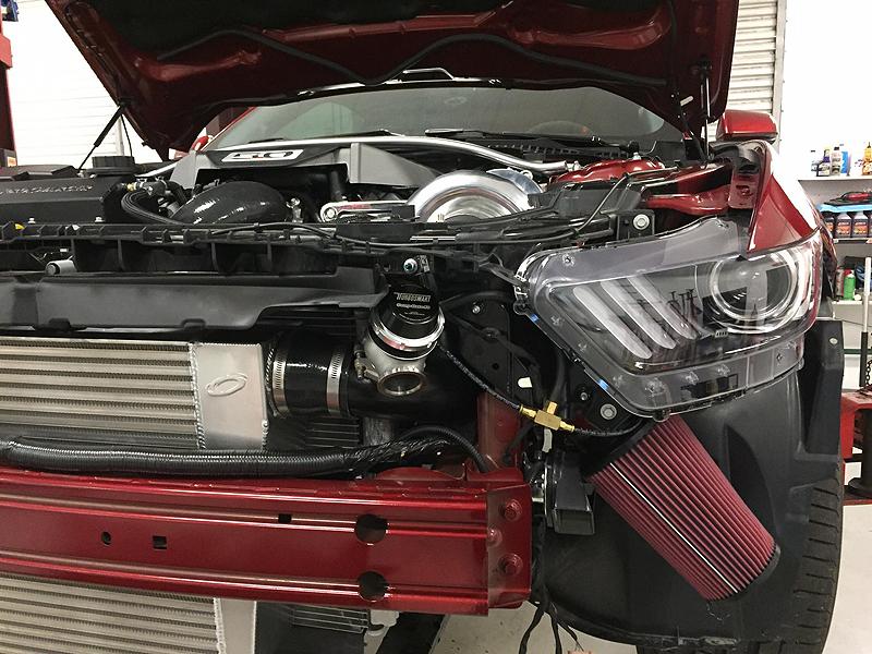

^ yup this! The challenge with the PC set up is if you use stock routing with the hotside pipe you have to be creative with the placement of the BOV and WG. Coastal has a bad @ss set up where the pipe wraps around the wheel well but it looks like you cannot have an intake with the pipe set up like that so you are left with an open blower intake.
Either way, I ordered a hotside pipe from Travis at Boostworks to relocate the race valve to the front and since the WG is smaller I should be able to fit it on the pipe where the race valve used to be.
WG will be here Tuesday, once the pipe comes in from Travis I will document and post the whole thing for other PC guys.
Here's my setup from Sam @ Coastal Dyno.

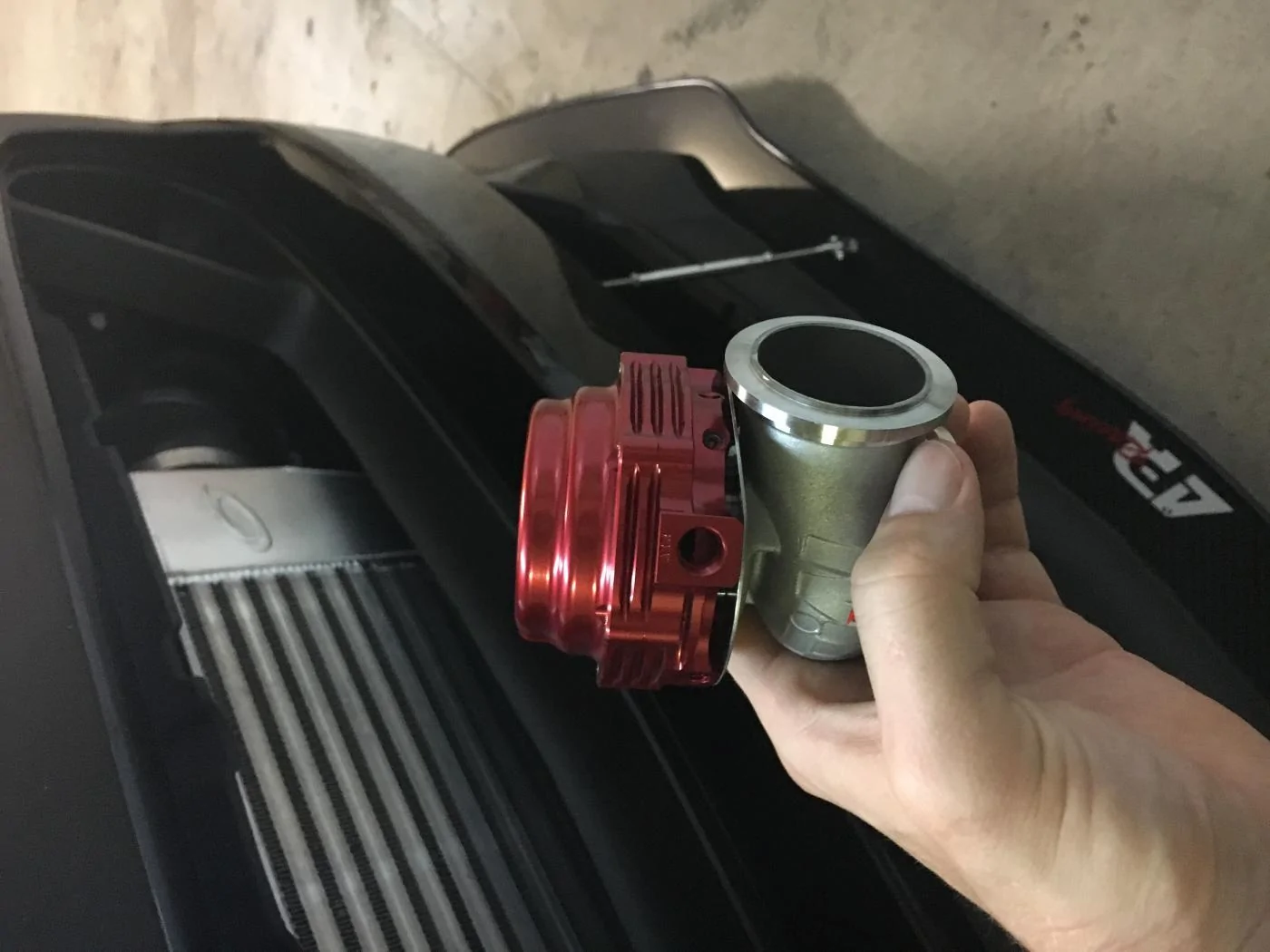

Anyone use the Turbosmart HyperGate 45?
I think that is what Terry uses in his torque booster package. I went with 38mm TiAL MVS for size and ascetics since it will be visible and space is limited. That was choice #2 for me though!

Tial MVS 38mm in hand!! Just need the hot pipe from travis@boostworks and I can wrap this initial build up!! So close!! :headbang:

I'm thinking of buying the same WG or the turbosmart. Is it ok to welded it on the same pipe as the bov? Maybe behind it? I can't remember if I'll have space. I have a Paxton and need to check

I want to see a picture of where the Wastegate ends up sitting. Which Surge valve do you have?
