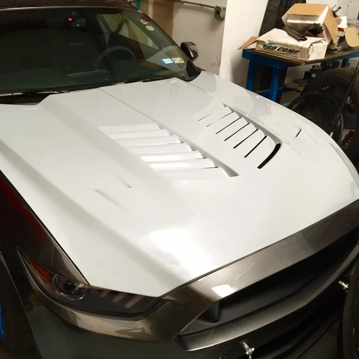

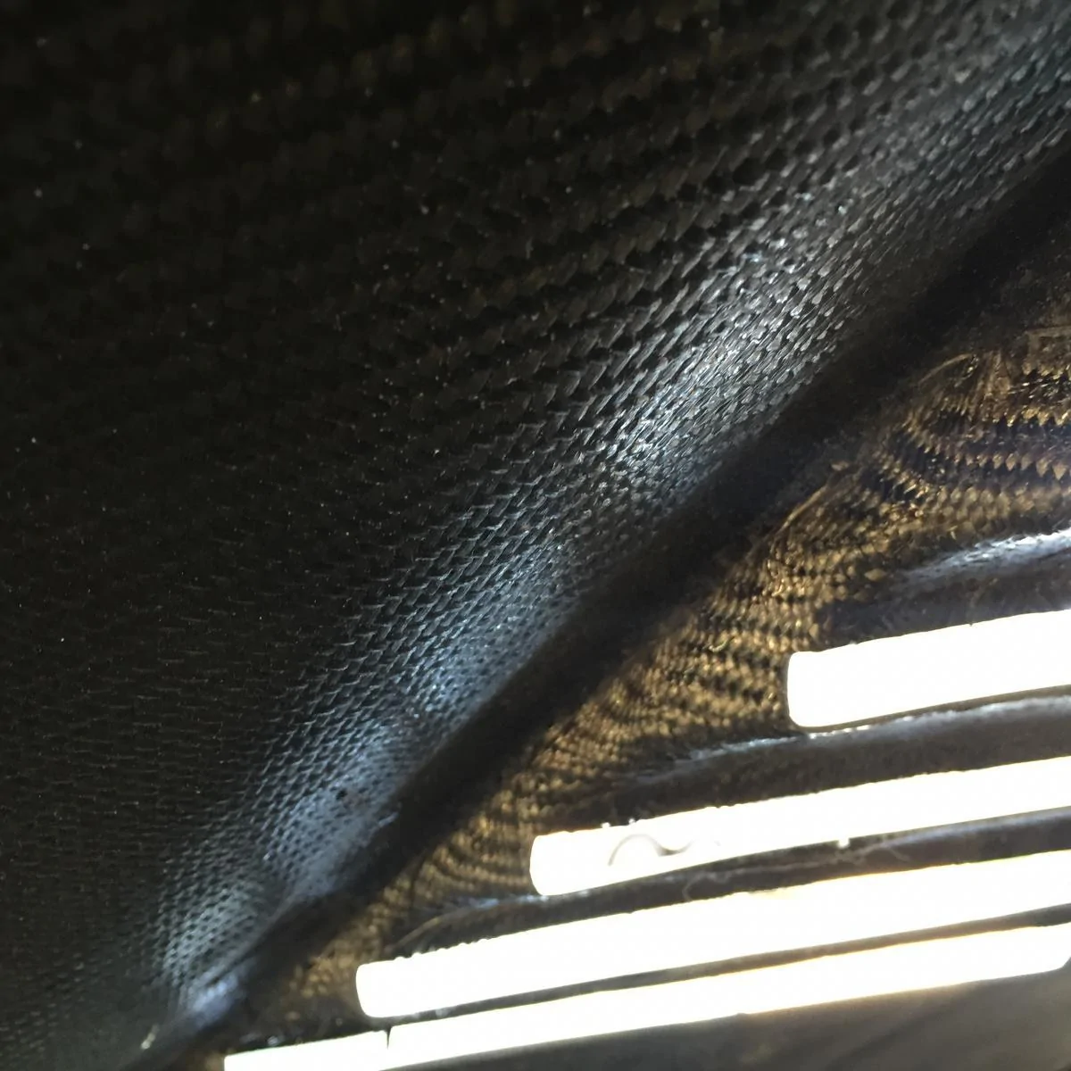

Carbon Tiger Racing Hood
Fit the Carbon Tiger Racing Hood. Fit and finish are very good and the install is straight forward. The benefit of this hood are less weight and more aero, no more hood lift!

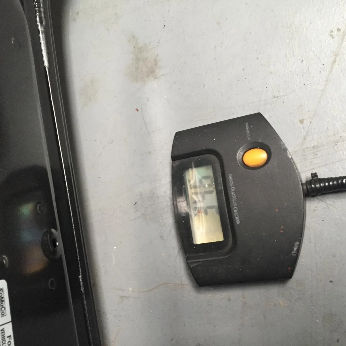

Carbon Hood: 14 LBS
Factory Hood: 34.6 LBS
That is 20 pounds off of the nose!
