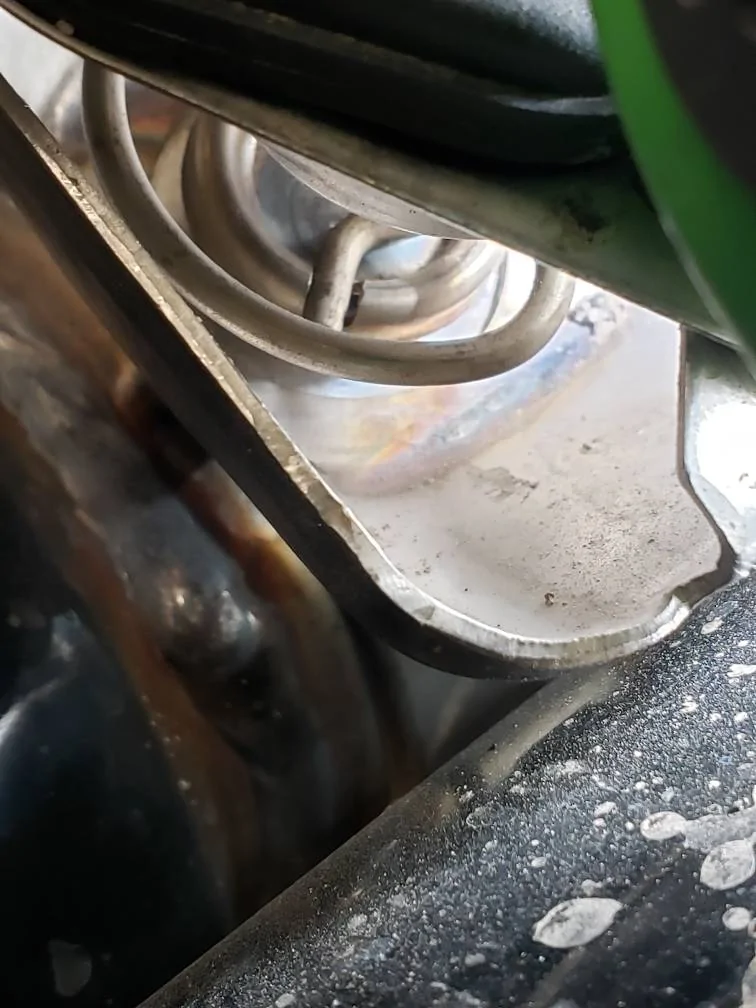

And..... still not working. Will be going to dealer next thursday
this was the photo sent to me regarding the fitment

Car was fixed at dealership. Ultimately, the passenger actuator was damaged during installation from the shop I took it to. Had to replace the actuator and is now running as intended.
