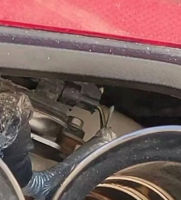

Aside from the above regarding the valves, check the rear connectors and harnesses by the valves. It’s a common issue that the harnesses melt or get damaged. If there is black conduit on the wires, you’ll have to peel it back to see the condition of the actual wires.
Do a wiggle test first of the connectors and make sure they’re secured, if no success in getting them to work, check wiring.

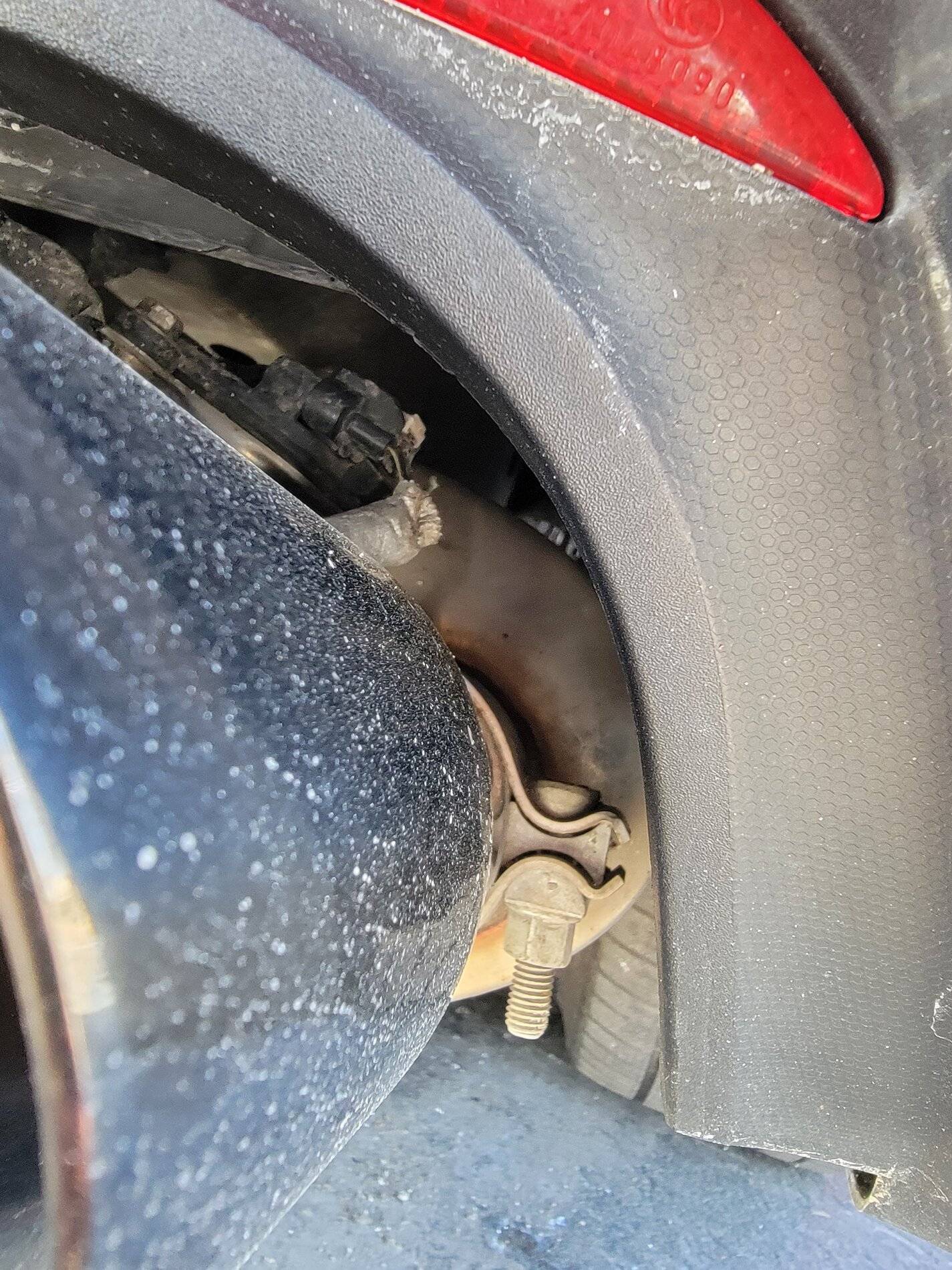

The main issue with the harness is the wires touching the sharp sheet metal pinch welds, especially on the right side. The insulation eventually gives way, causing a short circuit. I checked my car when new, and even though the right wires were closer than I'd like to that metal, they're not in danger of touching, but I still bent them up a little more, just in case.

It was cold and there was some ice and snow everywhere I didn't want to bother to check the harnesses so I went to the dealer 2 days ago to see what's wrong. I waited around 4 hours. ( I got CEL previously, the Fordpass app sent me "the catalytic converter efficiency is below an acceptable level" but the light disappeared the next day right before going to the dealership. Also Fordpass sent me "unable to fully open or close the upper active grille shutters" the dealer claimed I have those because of "exhaust flow control valve fault ". The dealer gave me these codes: P0430 , P1703 , P2BF5.
In the end, I've waited extra 1.5 hour then they said there is cut in the wire connected to the right actuator. They said because I have after market exhaust system, the diagnosis will cost $90 and won't be free. so yeah the wires on the right muffler was touching and with the cold weather made it break I guess.
The harnesses costs $52 and the labor almost $300 lol. I ordered it online for 30 ish and will install it myself in minutes.

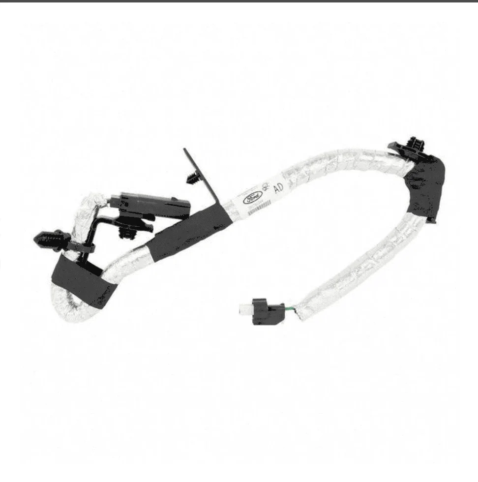

Do you have a link to the part you ordered? I’ve been searching through this forum trying to find which wire harness I need to order for this same problem. I’ve seen people mention 3 different part numbers and I’m not sure which is the one I need
njweatherman
Apr 24, 2021
409
182
Northwest NJ
Tommy
2023 Mustang GT Premium California Special

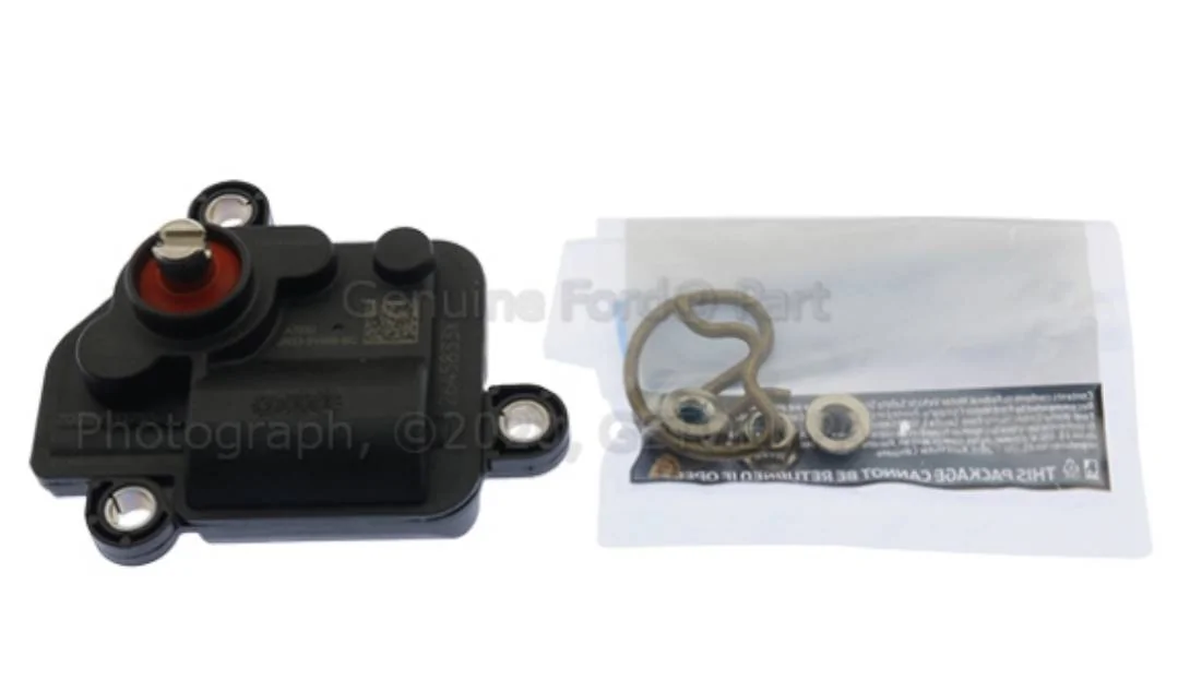

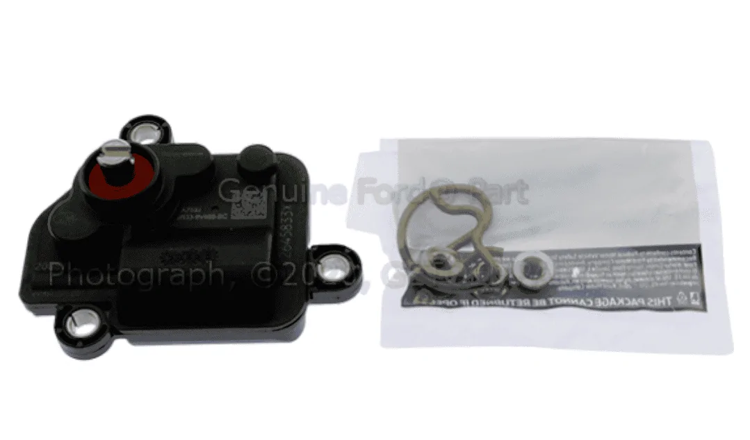

I found this posted by HollowKEYS in February.
Active Exhaust Actuators: JR3Z-5K245-B
And the Active Exhaust Pigtail
harness: JR3Z-14A411-H
