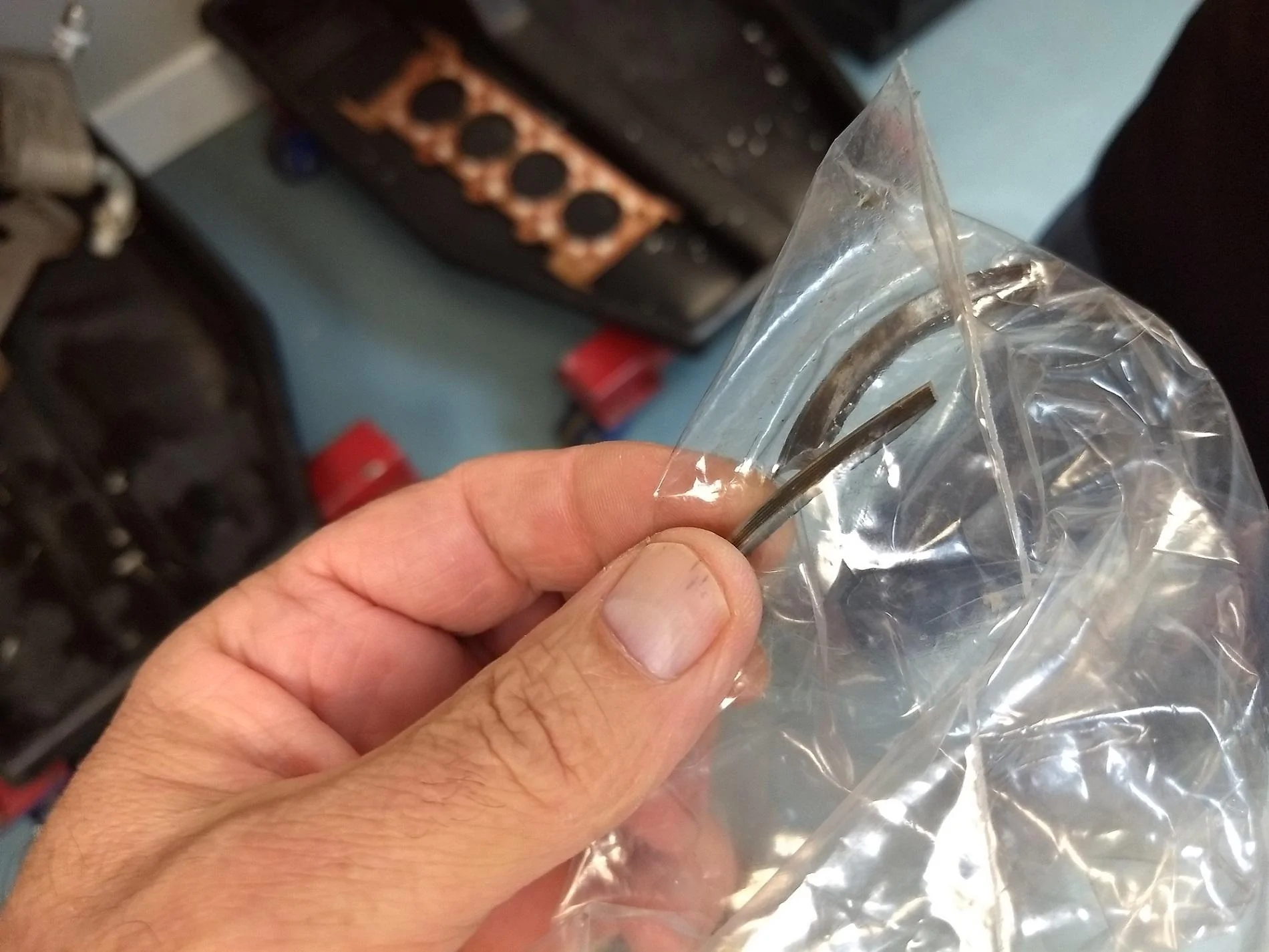

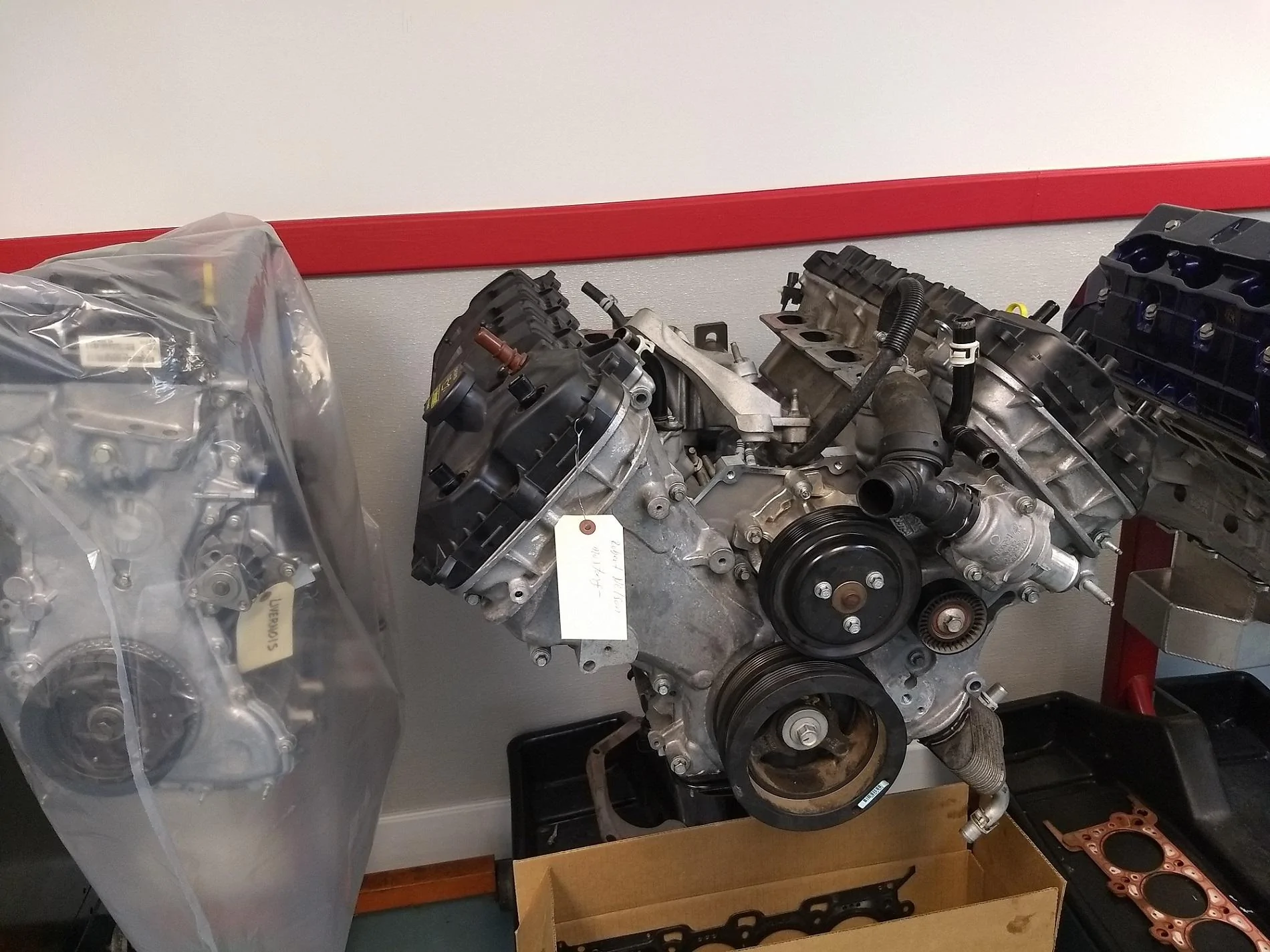

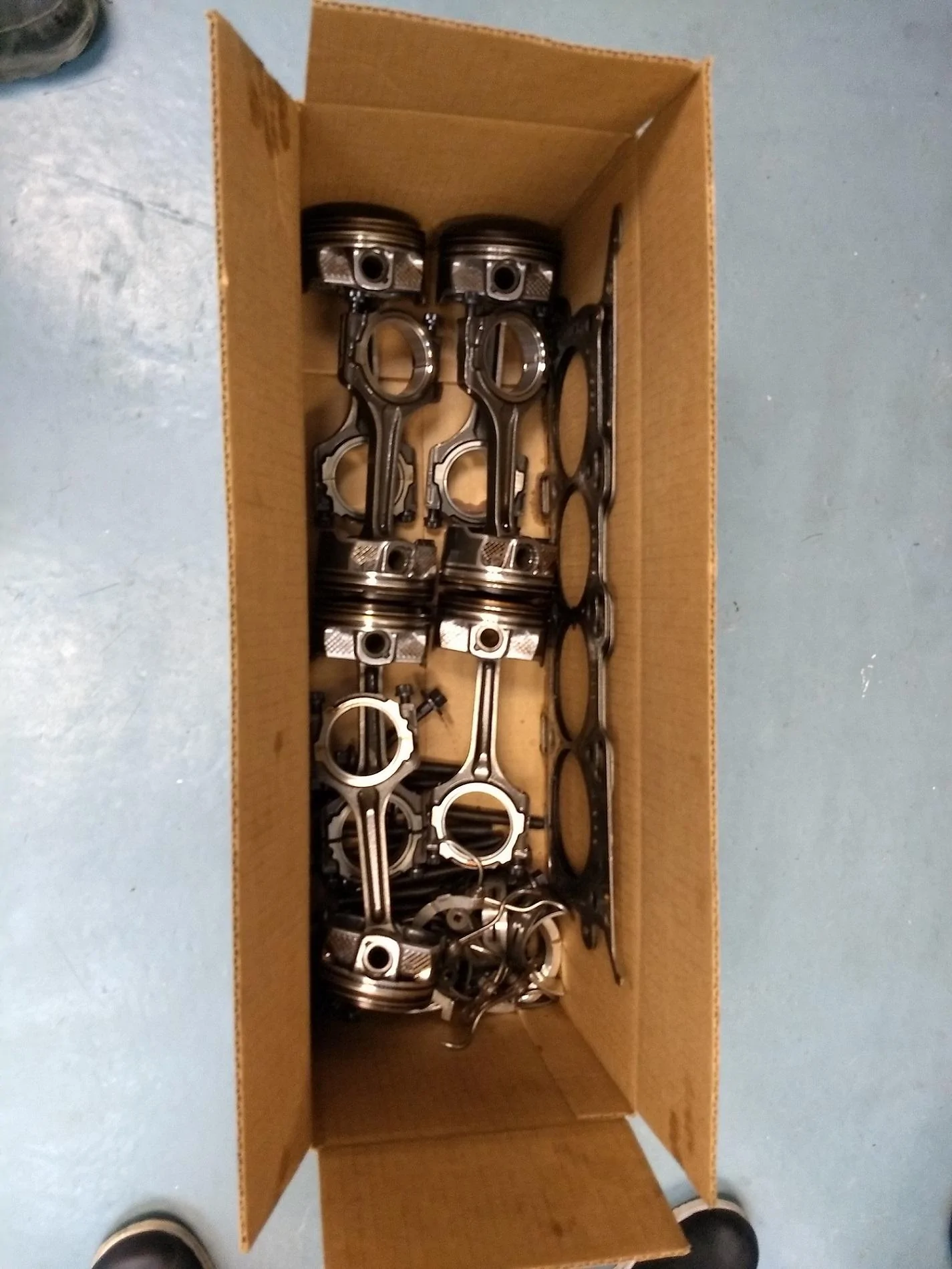

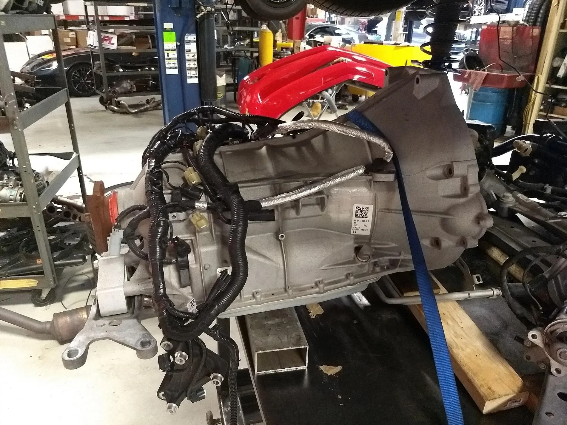

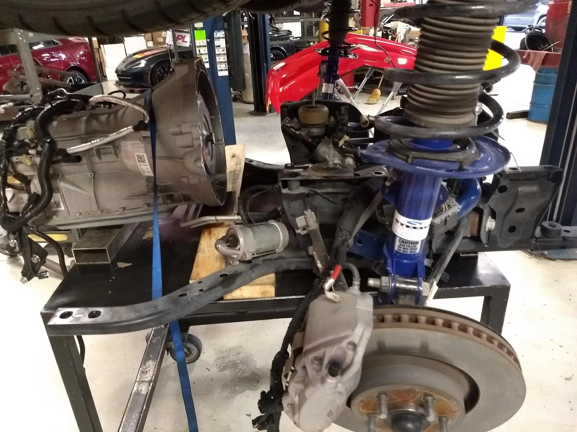

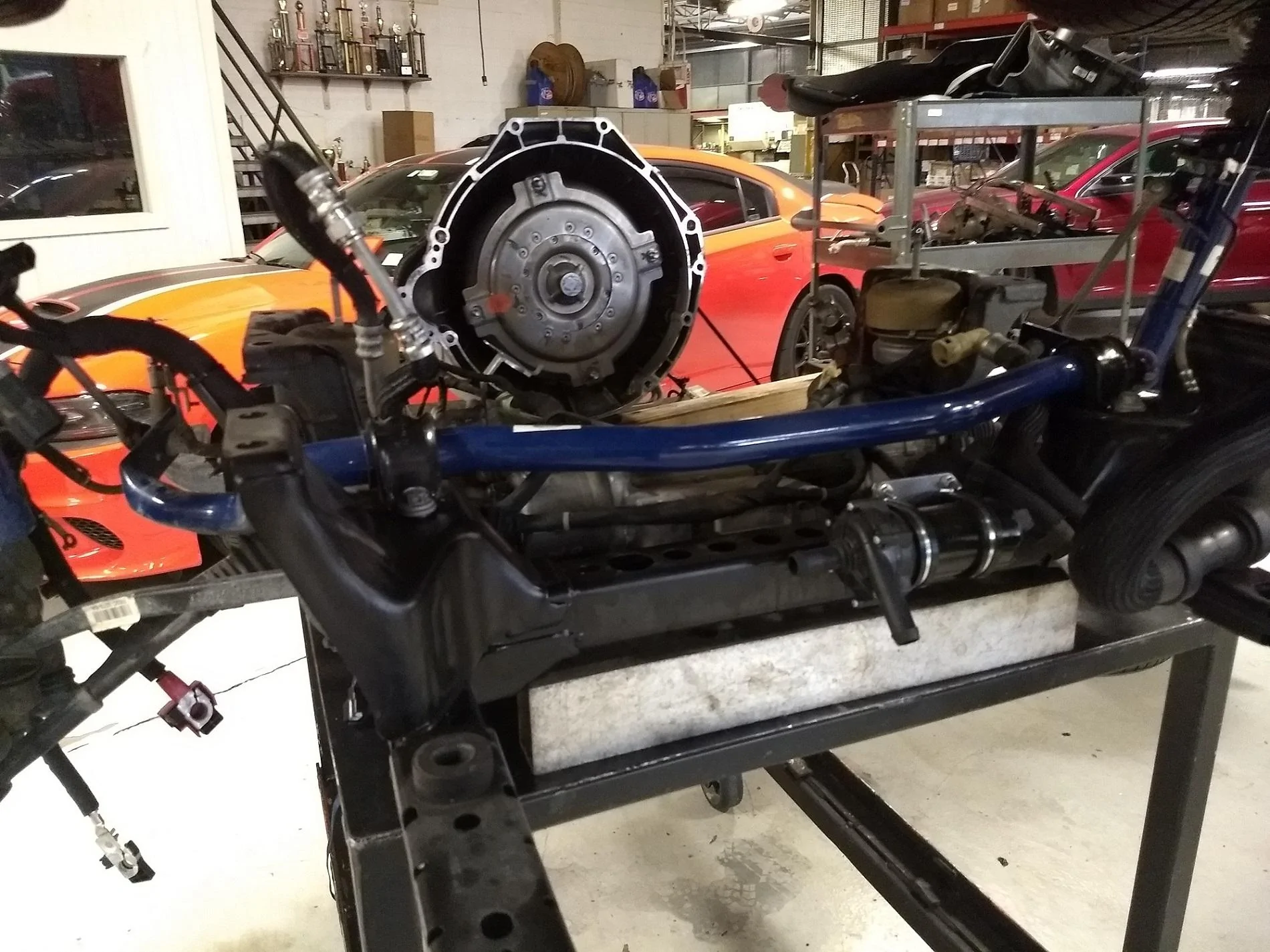

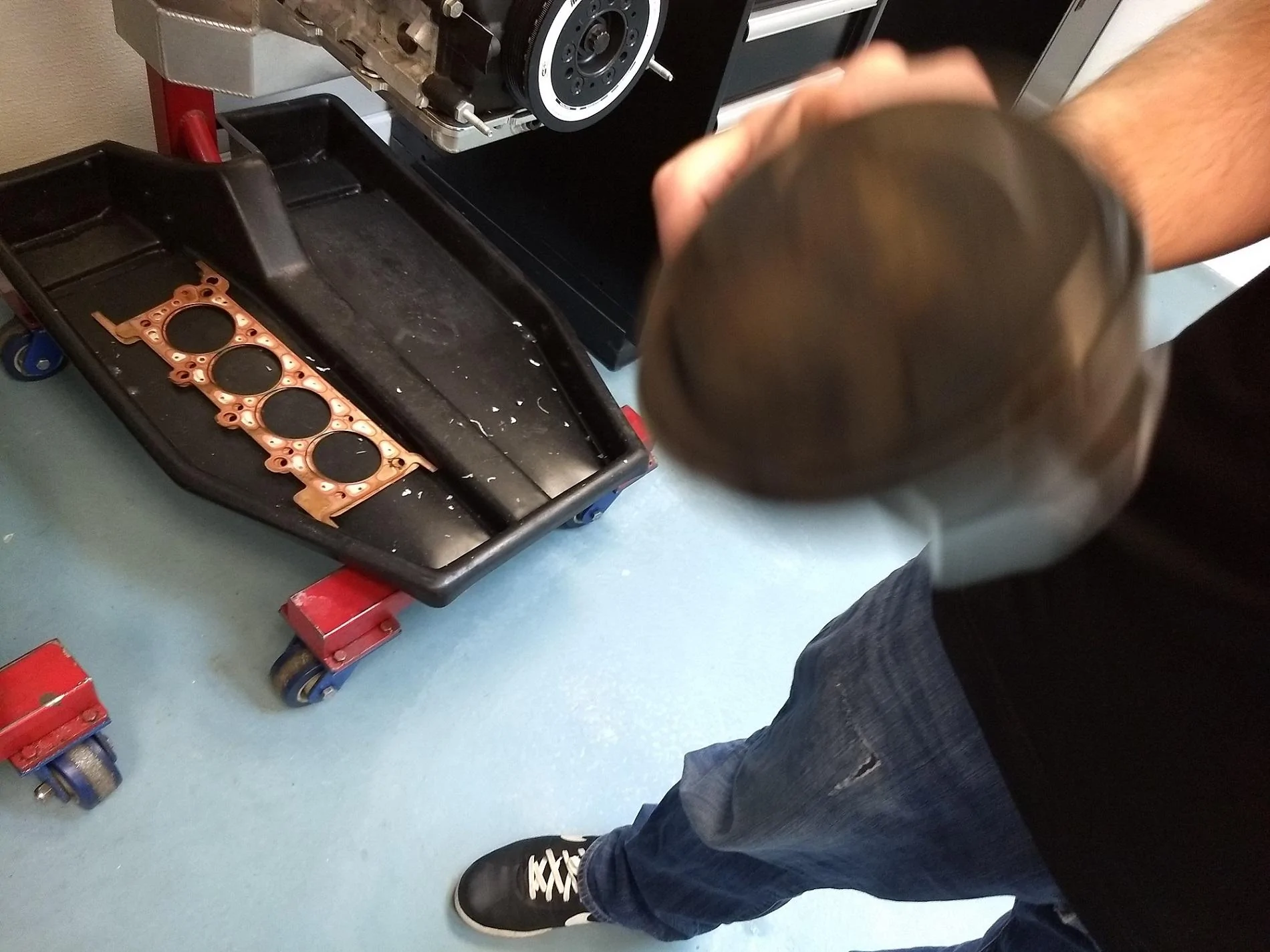

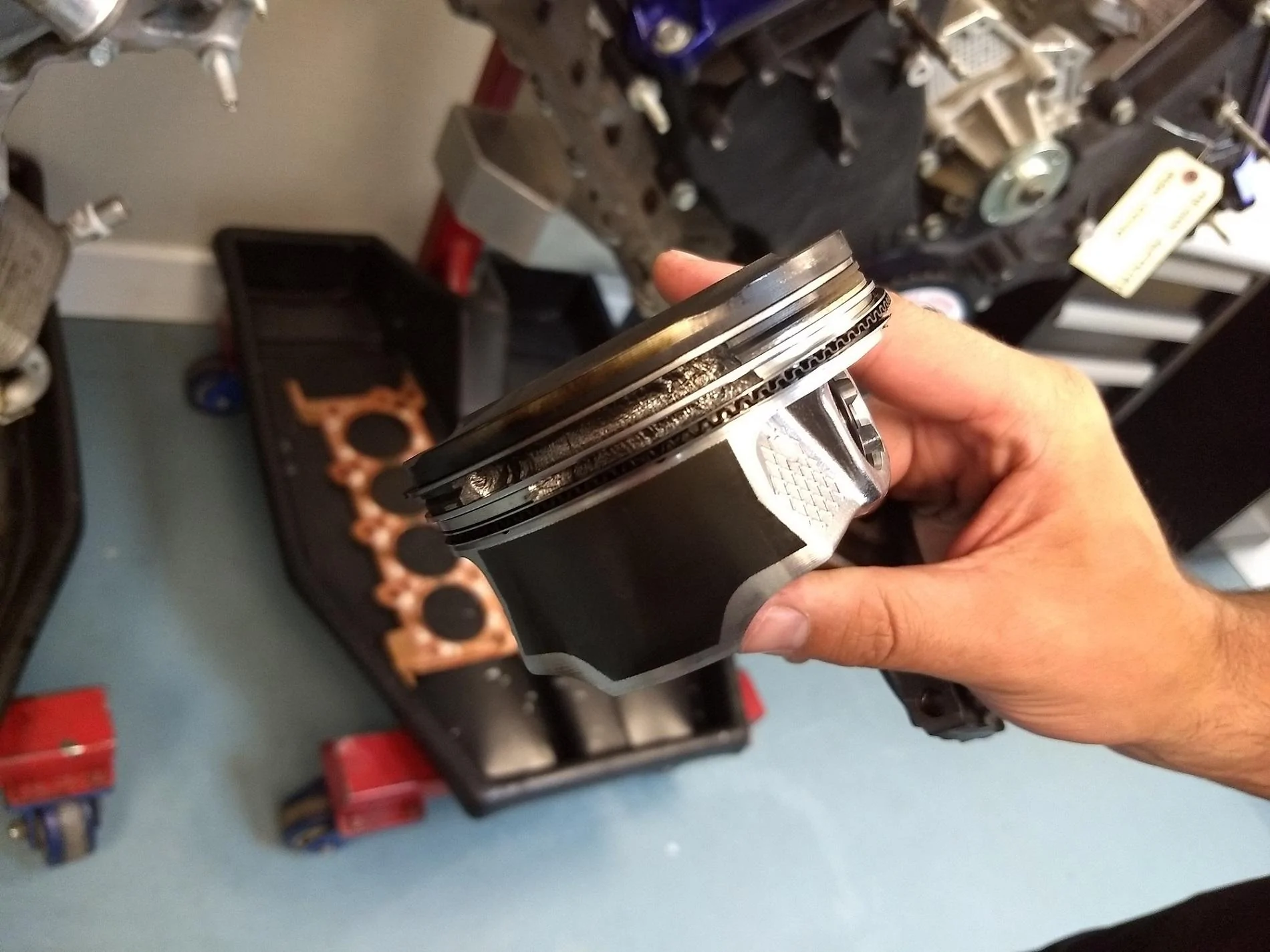

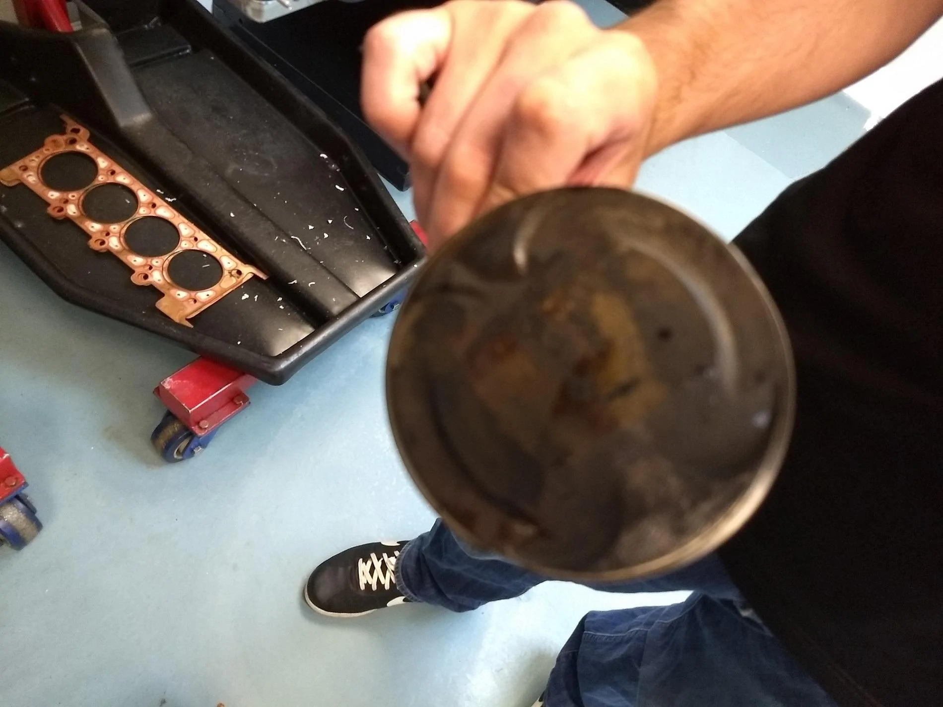

I stopped by LMS today. They have my engine ready to be installed. The old parts were in a box with the damaged #7 piston with them. I totally trust that these were my engine parts. I have found no evidence of LMS lying to me. Poor service at the beginning, for sure, but I accept the compromise I agreed to. I told Steve I almost ordered a brand new long block, but this way LMS is on the hook completely!
My salesman, Steve, said the engine guys are not sure what the cause was, but are thinking the ring gap on that piston was too close but admitted they are not sure. They seemed concerned about what happened. When they took the piston out, the ring came out in two pieces. We will likely never know for sure.
Here are the photos I took today, they include the photos of my car and the stuff taken out. I realize now that the top piston pictures are kinda blurry.
I'm a bit technologically challenged. I decided to leave the parts there until I pick up the car.
