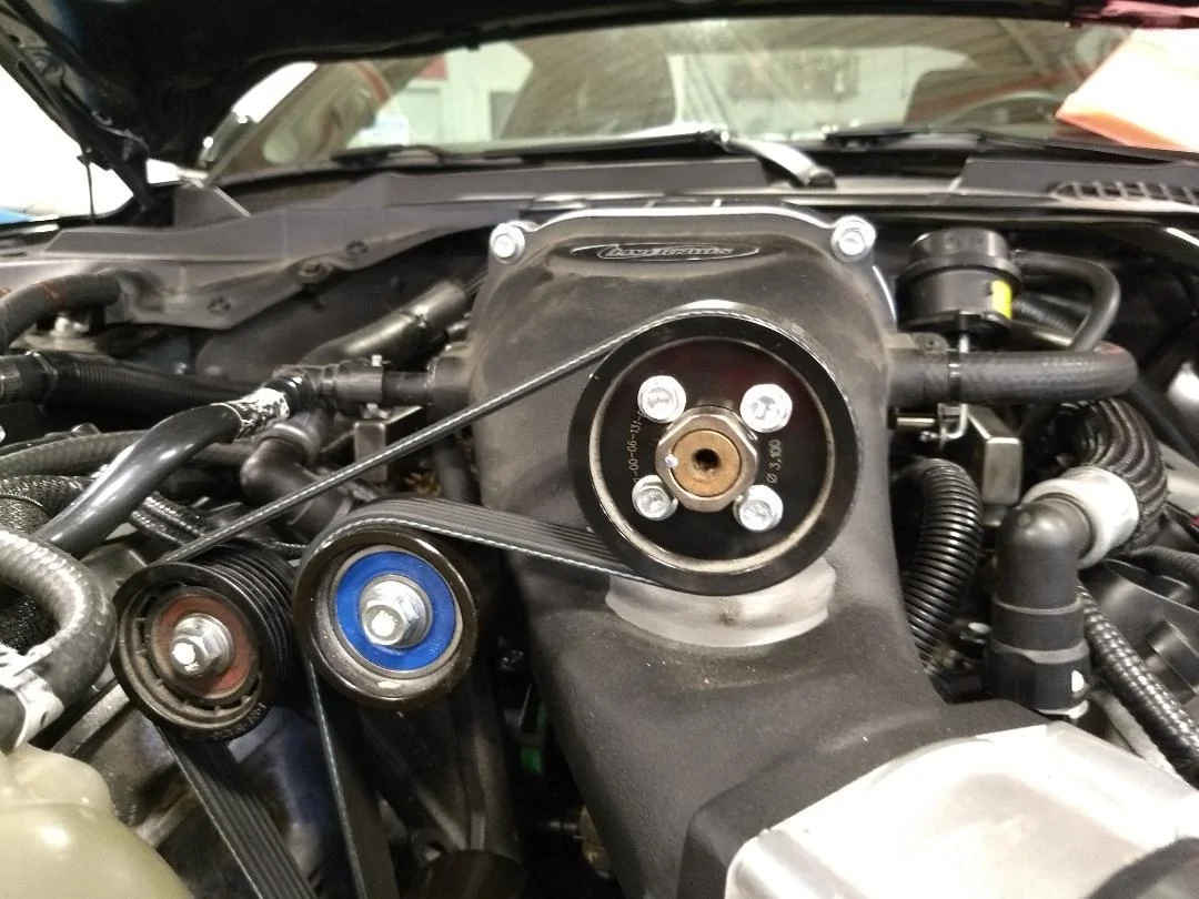

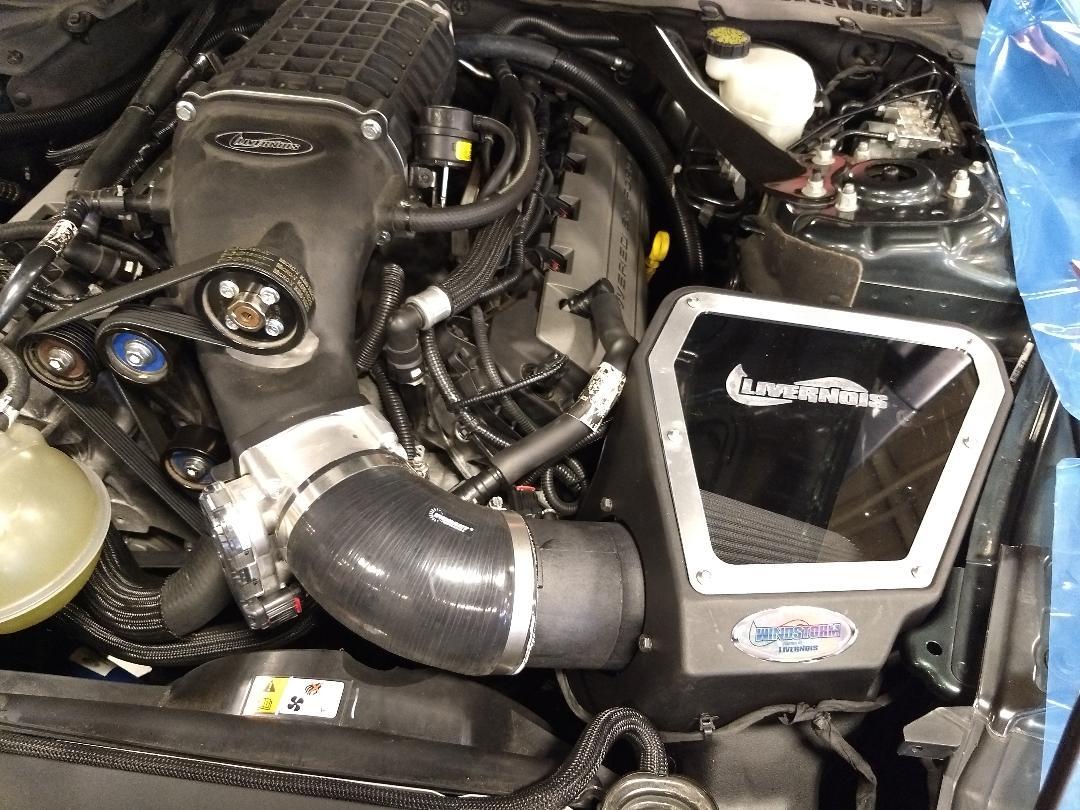

I stopped at LMS today to see the progress. They had the engine in and running a couple of days ago, but, according to my salesman, are spending a lot of time on the tune. They are going to road test it, etc. I am not really sure of the details, but they are definitely giving the car tlc. Here are the photos of the engine so far. The pulley is the smallest that Magnuson makes, I think. The CAI was fabricated. Getting air in to the engine is the limiting factor.

Man... I was holding back but I gotta say it. I feel really bad for you... the hassle and the amount of money you have spent on getting this far... to have that whole kit look like it was put together by random parts from a junk yard. Just looks awful. :(

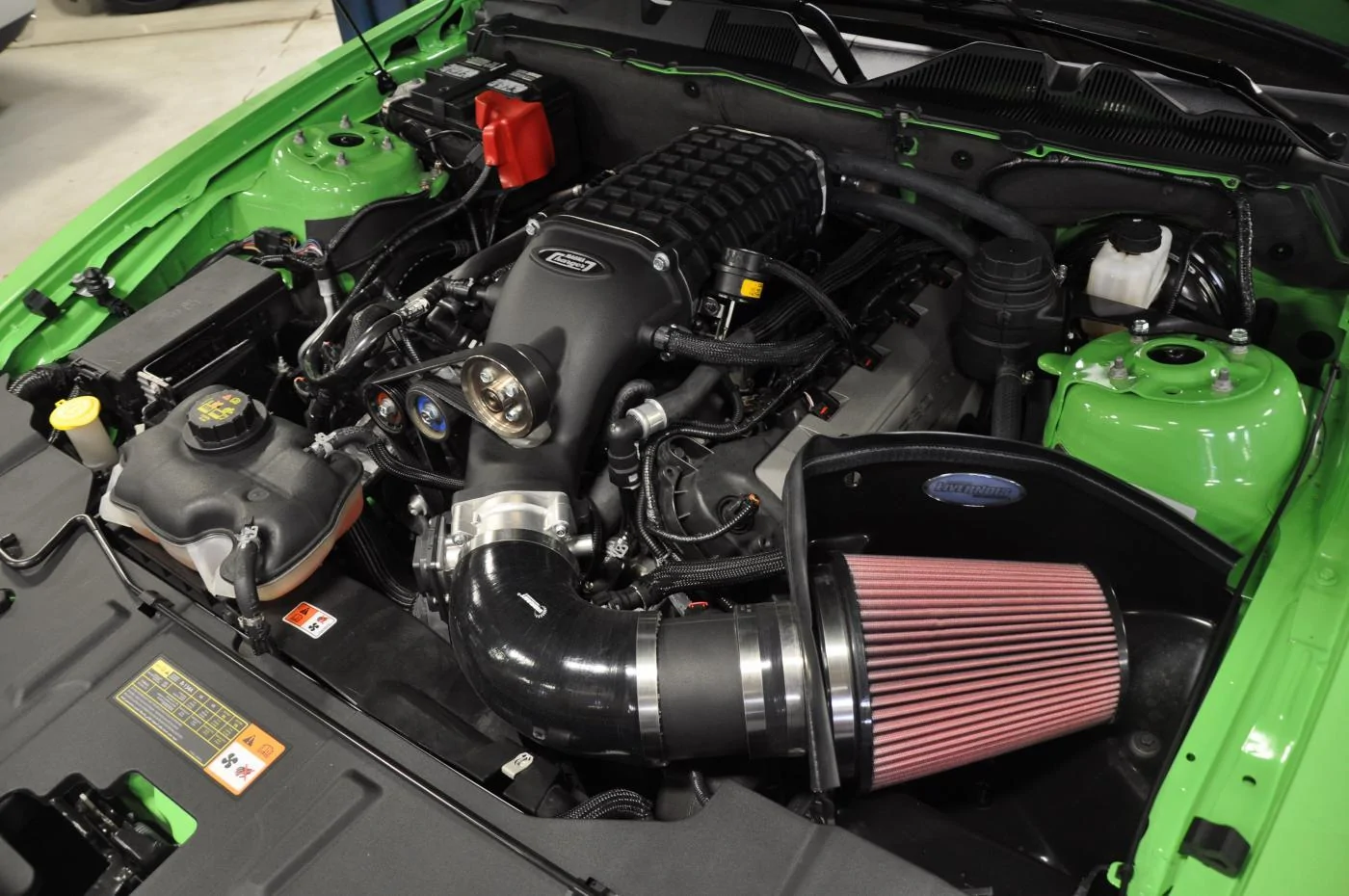

Why did they make that thing and not give you the one in this picture?
I’d want the one in the green car? I wonder why they changed it?

I think it looks fine just extremely dusty. I’m glad they’re going you the TLC. I like that they put in the CAi cover too
