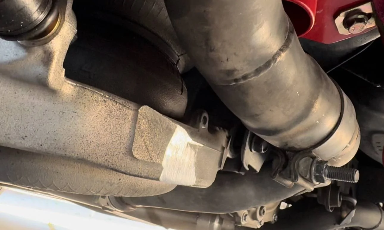

SOLVED: part of the axel-back was rubbing on base of the drivers side suspension. Can’t believe the unusual sounds it was making.
