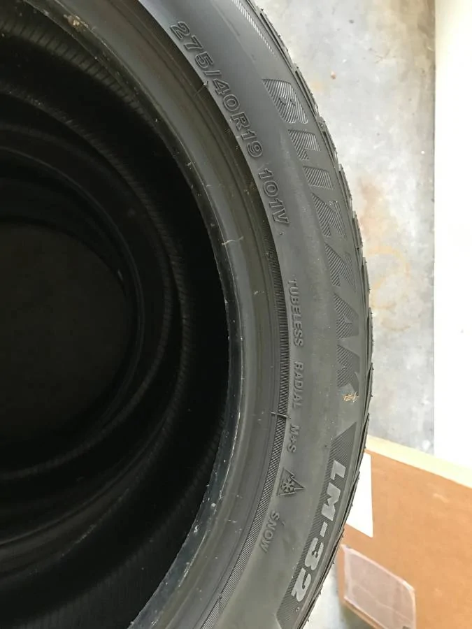

I prefer the winter performance tires because I live in the city and the streets get plowed and treated pretty quickly when there is a snowfall so my biggest issue is cold and wet pavement during the storms. But I am not giving up quite as much performance when I just have cold and dry pavement as I would if I went with studless Ice and Snows.
As Rock and Roll mentioned you don't get as many miles out of winter tires because they need deeper tread depth to be useful. They would still be better in cold than the performance pack tires, but their usefulness in snow really diminishes once you get below about 5/32 in tread depth. The other thing to look for is that the tread sipes are still there. This is what pulls the thin layer of water off the top of ice which is really what you slide on when sliding on ice.
If the LM-32s still have their sipes and still have decent tread depth, I'd say go with those.
These are the pics I got from him. I can't make out much from the pics, and not too experienced enough to assess the tread wear.
