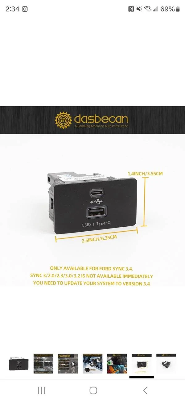

So I'm ordering all the stuff for sync 1 to sync 3. Would this work for the usb hub

Yes but I believe your front USB hub will need to be disconnected as the Sync only accepts two inputs.

I believe that people recommend OEM parts for the USB hub, particularly the cables.
edit: Not sure if it really matters, though.
I don't think it matters and I believe it's oem from a newer vehicle.

I am totally prepared to be wrong, but that was not made by Ford or one of its suppliers. That's not to say it won't work.

It might work, but I wouldn't. I just ordered the two cables and hub from a Ford dealer in STL and it was like $120 shipped. The USB hub doesn't have USB-C but it's an OEM part, which that doesn't appear to be.
the hub I used was HU5Z-19A387-C, and the cables were FR3Z-14D202-B and FR3Z-14D202-A.
Yeah that's what I ended up doing

Good call. Best of luck with the install and forscan. It's not a simple upgrade, but it's also very doable with tons of info available.
