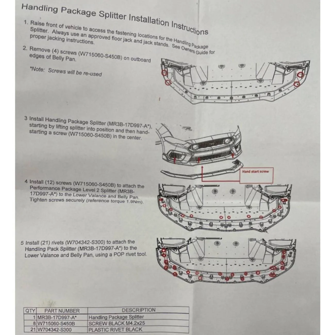

I like the idea of this honestly that way I’m not stuck with it on, do you have a link to which you ordered? It looks like it takes 12 screws to install (this includes the 4 you remove and reuse?) and then 21 rivets. So when you install using rivnuts instead, do you still use the screws and just replace the 21 rivets? That’s probably what I’d like to do, if that’ll work.

Once you have the rivnuts installed, what size screw do they need?
