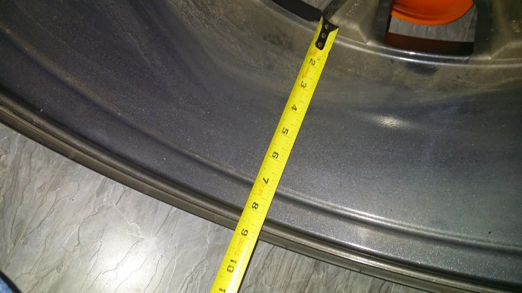

Does this help :)

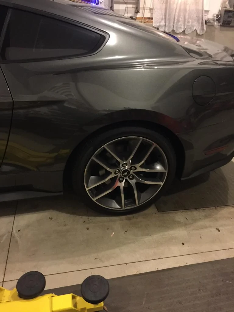

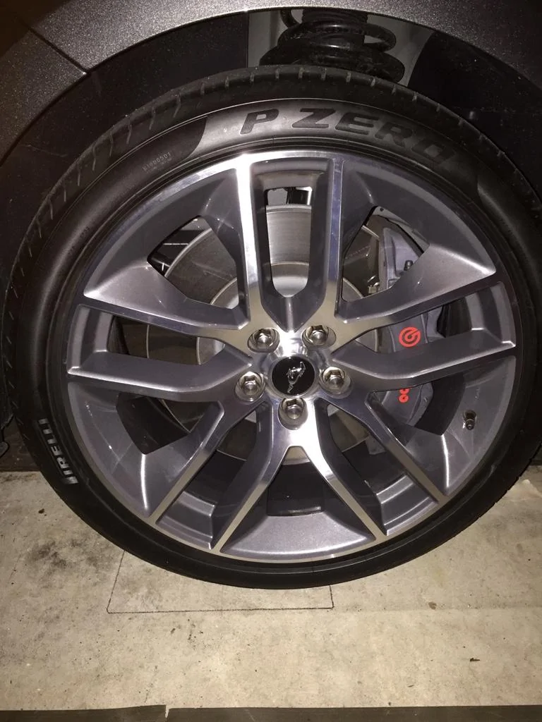

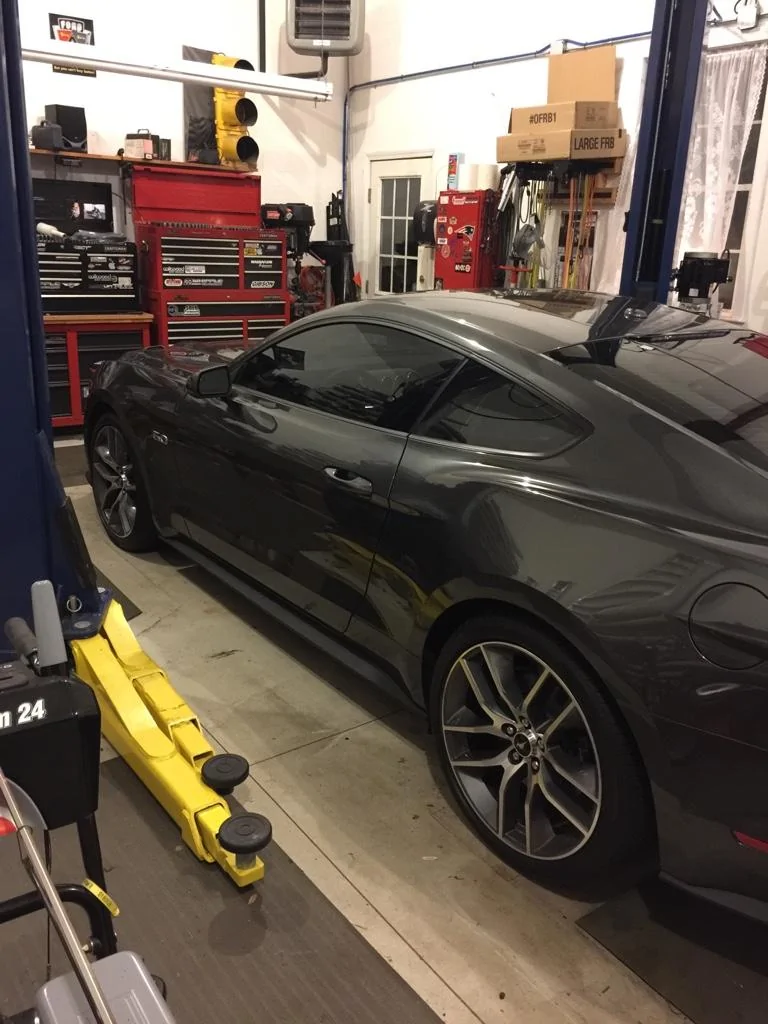

They fit!!

Congrats buddy!! Looks great.

Why wouldn't they? Those are Ford 2015 Mustang 20". The PP only has 19".
To answer this. There is more to the fit than diameter fitting over the rotors. The caliper depth versus mounting pad height (hard to explain) plays a large role and was the problem in previous years more than diameter.
But, as he found out, they work.

No spacers needed?

No spacers needed?
No spacers needed. Only lost 1/8" of clearance leaving 1/4" between the caliper and 20"rim. Plenty of clearance.
