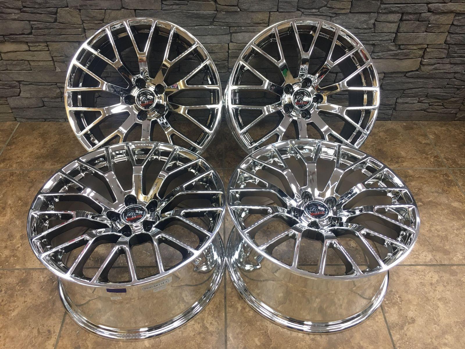

I am looking at some wheels but wondering if they will clear the front Brembos on my 2016 GT Performance Package? The dimensions are:
Wheel Size 19x8.5
Wheel Offset 35
Bolt Pattern 5-114.3
Hub Size 70.6
Back Spacing 6.13
Any help is most appreciated!

They should, as long as they are a good copy of the OEM wheel. Sometimes replica wheels have funky design and barrel tapering and it's not always 100% copy of the OEM.
