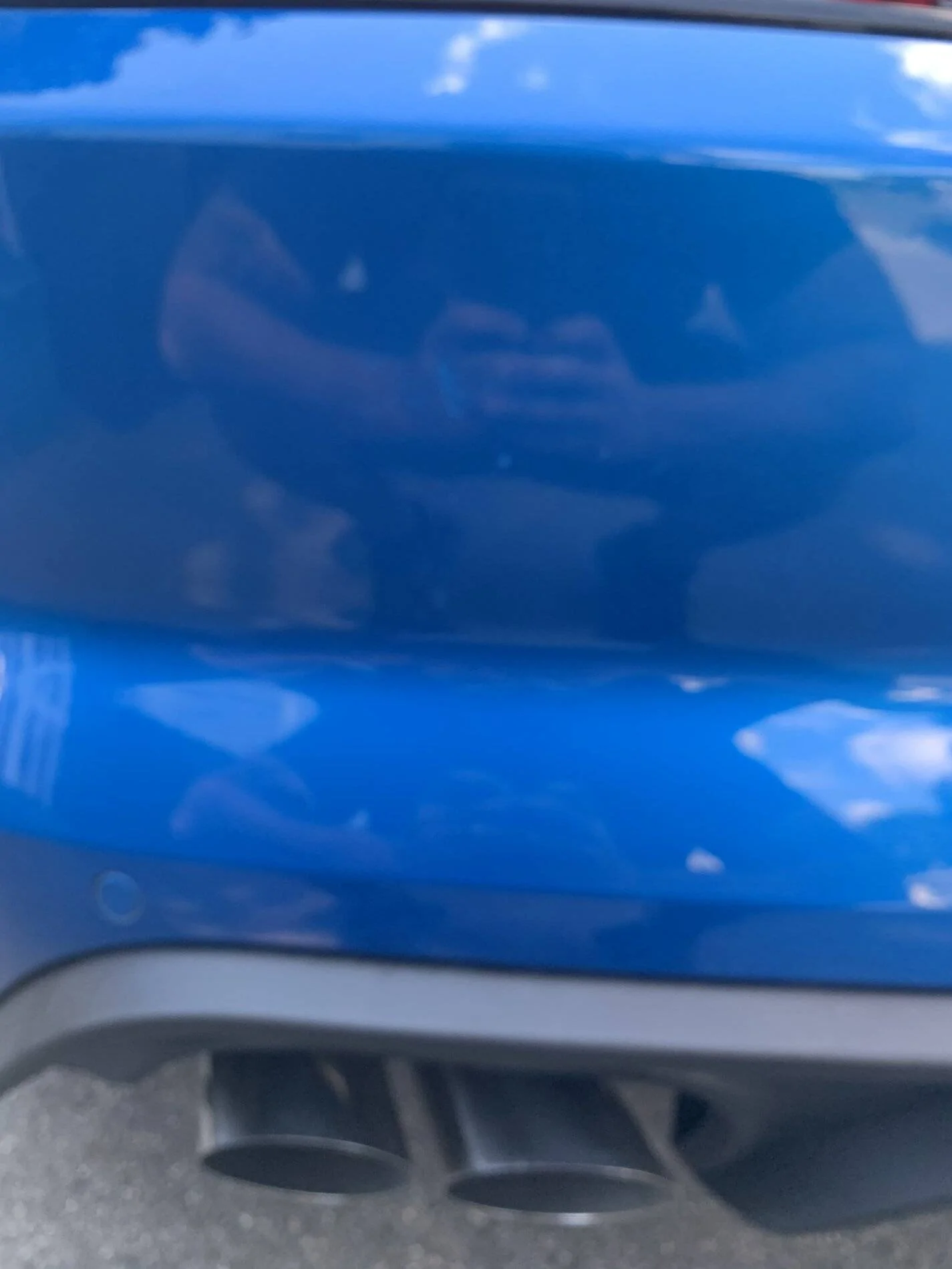

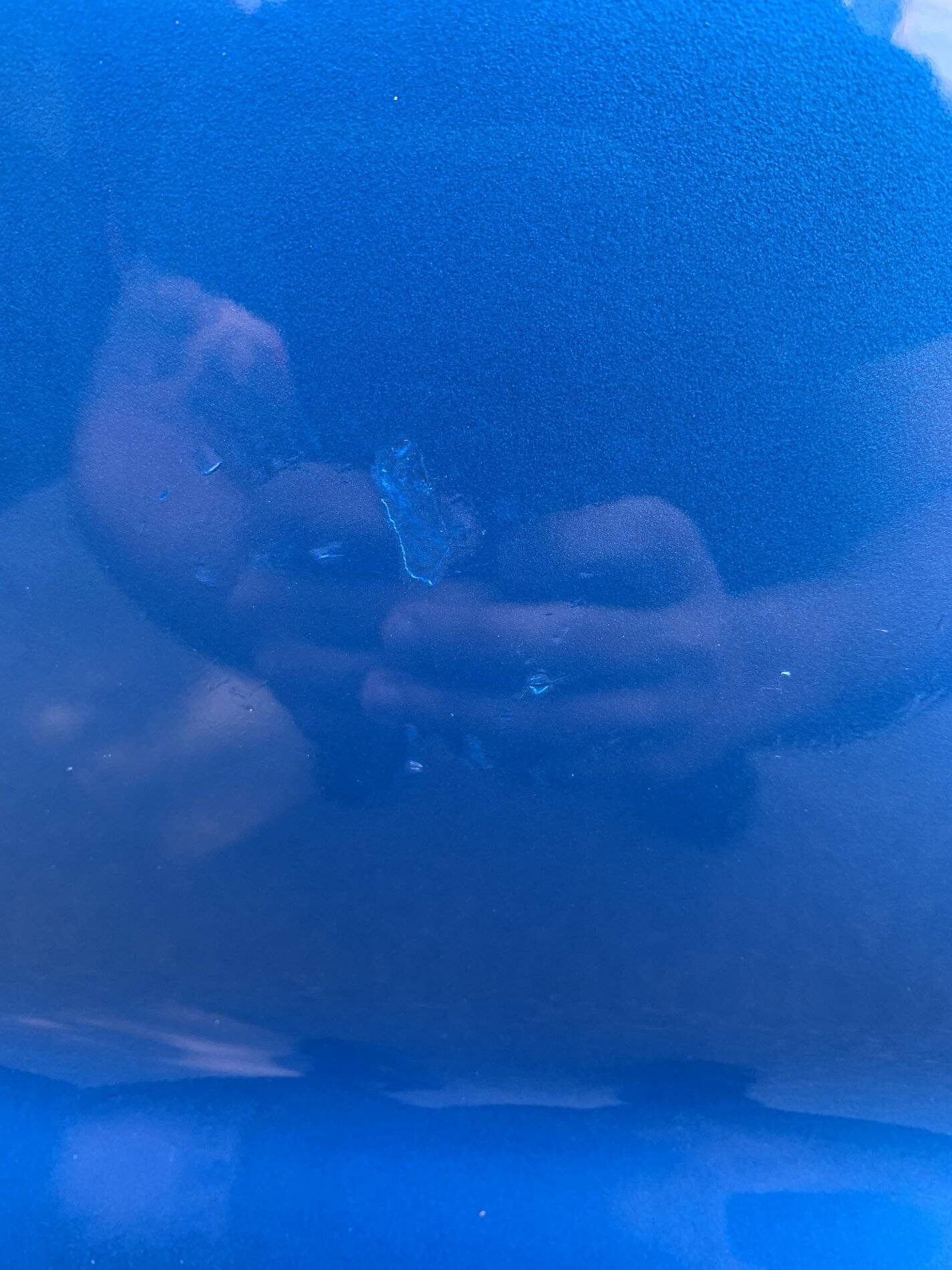

This is currently how it looks until I can get it too a shop Monday to sand and add clear coat , one picture is up close and the other is a few feet back

That's a good start Dave but is the paint totally level (smooth to the touch)? If yes, great. If not you may need to build it up using some additional coats. Actually a touch hi might be even better. The shop can sand it smooth.

Looks good. I think you will have to add some more paint in the next few days :) Those dents are pretty deep and you can see on the left side that there is more paint needed to level up the surface. If you don't level up that dent with paint to the surface level, and just add clear coat, you will see it the same way, like it is now.
You are good for now. Add another layer of paint when it sits after 2-3 days. I think that you will need to wet sand the paint until it is smooth first and then add a clear coat. I am sure, you will be happy with the final result if body shop helps you out with this :)

Okay I see what your saying , it’s not smooth to the touch . So it would be better actually to have it be almost raised because then the shop could sand it down to being flat right

So don’t go to the shop in a few days for clear coat , add a few more layers of
Paint in 2-3 days and then re asses correct ? And I definitely see what your saying about the left side needing more paint . How many layers is safe to do in a day

let each layer dry and put more until you're satisfied or when it's even.

Exactly correct, the largest issue with the paint pen and clear isn't color matching, its the fact that it takes several coats to build up the thickness to the original paint. I have done amazing work with paint pen, but it takes many coats and patience. The clear is critical too.

I would think the paint pen or package would say minimum time between coats. I would double that, at least.
Having a dealer/paint shop do the clear is interesting. I suspect it could be very cost effective. MUCH cheaper than them doing the color and clear. They won't have to mix the color, make sure it matches, clean the gun, etc.. And since they shoot clear all the time, the actual clear spray doesn't require them to do any mixing or cleanup.

Yeah exactly , I’m 25 I don’t have the largest budget right now to fix my mistake so I’m going to apply to paint from the pen until even with the bumper and have them sand and clear coat , hopefully it isn’t too expensive I can’t afford much right now

So could I of done all the paint layers today in one sitting with appropriate amount of times in between each layer ?

Correct. You really don't have to paint all the layers in a single day (I know it is tempting :D ). As the paint is drying it is shrinking its volume. You don't want the paint to form any bubbles or cracks just because you put there too much paint. Give it good 2 days before adding another layer even if the paint looks dry after 10 minutes. You really don't have to count the layers. It all depends how deep the paint chip is. Those smaller chips on the left side may be good with 1-2 layers. The bigger dent on the right down may need 2-3 layers. The main big chip may need 2-4 maybe 5 layers. Use your eye instead, build up those layers and let the paint sit for few days.
Also there is nothing wrong if the final layer of the paint rises above the surface (excess paint). I would say it is essential. If you sand it, you will have perfectly smooth surface.

Awesome thanks for the help! The big crack is on layer 6-7 by now but I’ve been using very thin layers and not globbing it on like crazy
