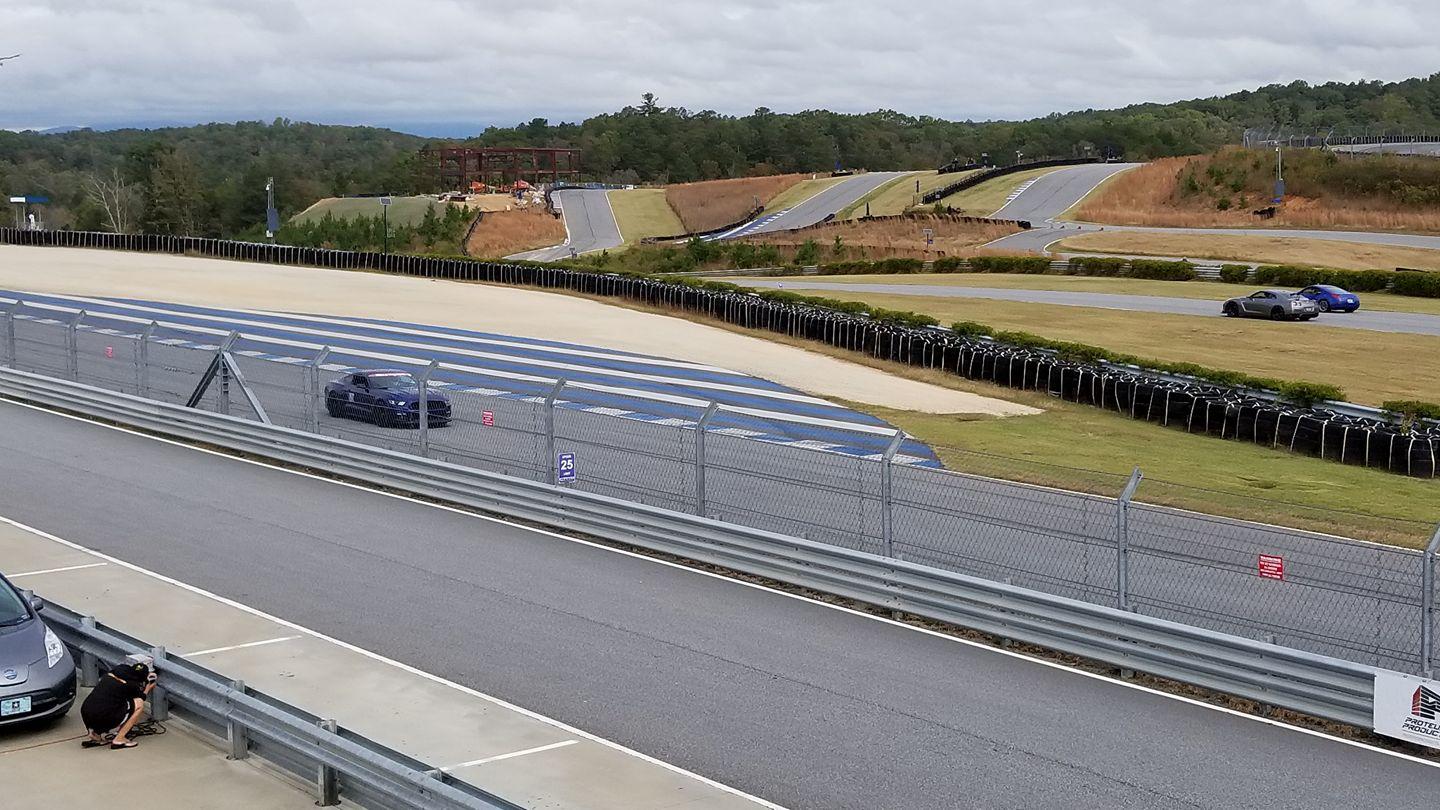

Pretty happy getting 1:35.4 on street tires at this track! Love this place. Wish it were a WEE bit longer of a track, but I can't be picky. I'm not really too fond of tracks with long straights... I just find that kind of boring. I don't care about top speed all that much. This one has a straight but it gets it over with and back into the fun. Road Atlanta has two straights and the back straight just feels like I'm roll-racing on the highway and then hitting the brakes as hard as I can because I see a cop.
I tried the NT01s here and got consistent 1:35.0 to 1:35.1 but I wasn't in the appropriate run group for sticky tires, basically I ended up just constantly being held back by traffic in all the wrong spots to really take advantage of them. They also felt a little hard - like I expected a lot more grip out of them today. They don't seem to like cooler days. They feel much better on 80+ degree days... find that interesting.
I have a lot of learning to do to utilize an NT01 or similar tire. I don't seem to be really getting the 2-3 seconds faster on them and I find, in reviewing video, I'm basically taking the course at the same speeds around turns until much later laps/sessions and when I am going faster, I feel like I'm falling out of the car because my stock regular seats are just letting me fly around. I have to learn how to feel out this kind of tire but also I think having these on the car warrants suspension adjustments and I'm better off getting a seat that'll hold me in place before I spent much time on sticky tires. Photo/video of my car going around turns doesn't really indicate I'm body-rolling all over the place, the car actually feels quite flat... just all 'dem G's man!
