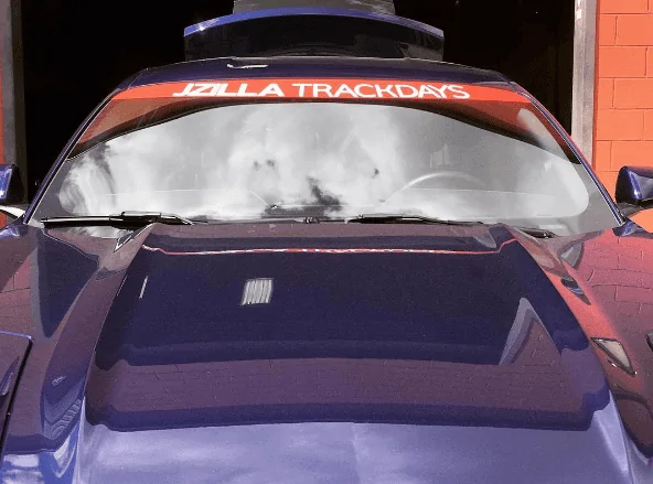

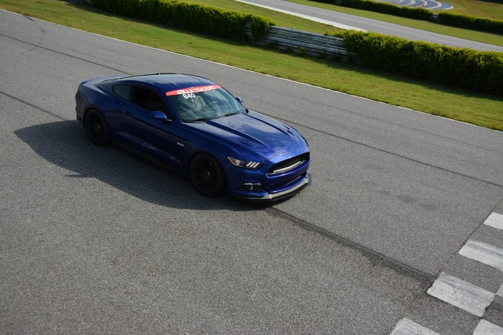

Put a banner on my windshield the other weekend. I did it myself and it turned out perfectly. There are these little lines etched on each side of the windshield that made aligning this a breeze. I mostly HPDE with JZilla and they asked me to run a banner. Mostly wanted it to block out sun glare which comes straight through that part of the window every damn day - and it works perfectly! I have it high enough that my dash cam is not affected. Score!
+10 HP :headbonk:

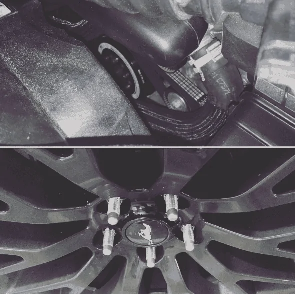

Well, some new news. I had installed an ATI Super Balancer and extended lugs such that I can use spacers (only needed up front) to run 305 square. Should need only an 8mm spacer but I figured I'd put extended lugs front to back. I had this work done by an Atlanta S550's member who is a Ford Tech at Hardy Family Ford in Dallas, GA. I really don't feel comfortable doing any "bottom end-level" engine work - bolting in a new manifold is one thing but I'm not about to fool with anything lower than that. He also did some warranty work and I had my alignment re-done given I installed the aforementioned Steeda parts to the IRS. The alignment was to me specs and perfect.
When the mechanic texted me saying the work was done, he said it felt like it ran smoother. I was like... yeah right. So I get in the car, start it... and before with the Steeda engine mounts you could feel the engine a little more than stock and accelerating same deal. Now... it's like the car doesn't have an engine at all - no vibrations when idling and driving it is far smoother feeling, less transmitted vibration. I swear this isn't snake oil. Additionally, some latent resonance I was getting through the driveshaft I have at 3K RPM reduced notably.
I installed this so I could feel more comfortable having a 7200 RPM redline I'll have with my VMP tune. I know that's out of my power band without a manifold but it's better than shifting a gear right before a turn like I have to do on 19" wheels with 35 aspect tires sometimes - two spots this happens at AMP, for example.
This weekend I'm going to finish up installing my GT350 CAI and load my VMP tune. Currently running the standard stock airbox 93 octane SCT tune on the SCT X4 device. That isn't bad, really - gave the car a bit more pep overall.
I'll be having my Nitto NT01 tires installed on my Rays wheels sometime this month and verifying that my 8mm spacers up front do allow me to clear the strut with a 305 tire. If all goes well, I will be getting some GLOC R12 front and R10 rear pads from OPMustang.com and further preparing for Camp Steeda!

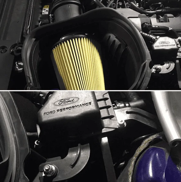

Got my GT350 CAI installed along with a driver's side oil separator and a VMP 93 tune. The tune so far is great - smooth throttle, extra power, extended redline (main goal, really). May send in a data log or two to VMP in the near future to see if it's okay.
Interesting..... I was thinking along the same lines wondering if a better crank balance would suffice for non FI engines that see higher RPM's. I just hadn't floated that thought out there for others to comment. It's good to hear that you have a noticeable improvement.

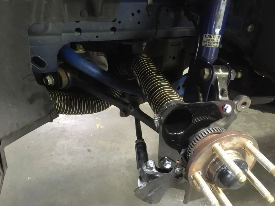

Installed some brake cooling last weekend. I purchased the JLT kit without their cheap hose, got myself some better hose, and put it all together. I am only going to temporarily use the fog light as an air source as I suspect the front lower grill will be a better place to dam air into an intake behind the grill. I'll post a picture of the fog light intakes later. You do have to give up the air diverter on the upper control arm that comes on PP cars. Well, you can cut it to fit around the cooling backing plate, but I'm not going to. Overall fitment is fine. I can see the tube being a relatively quick wear item, but we'll see. May end up replacing once a year or so? I have no basis to guestimate that.
