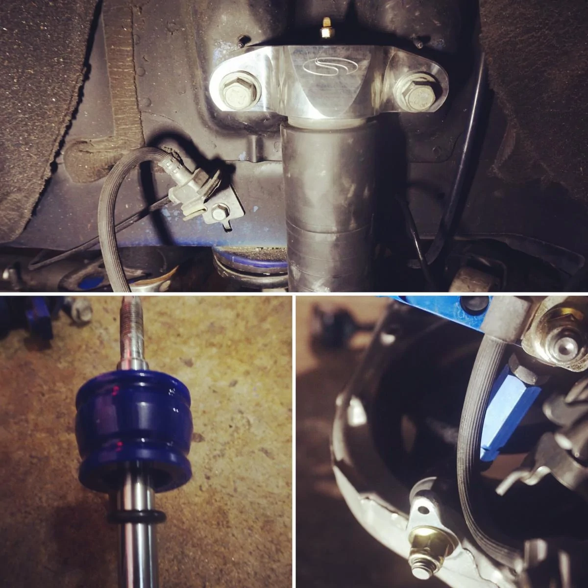

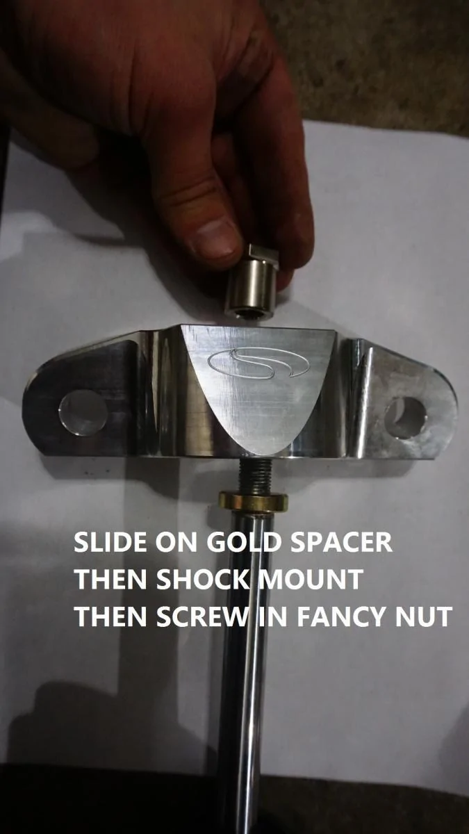

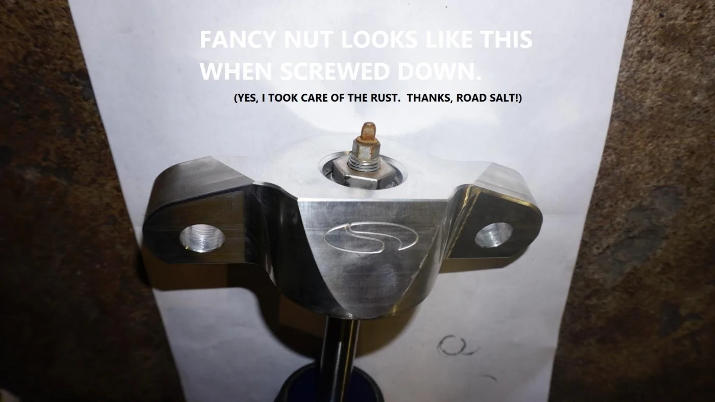

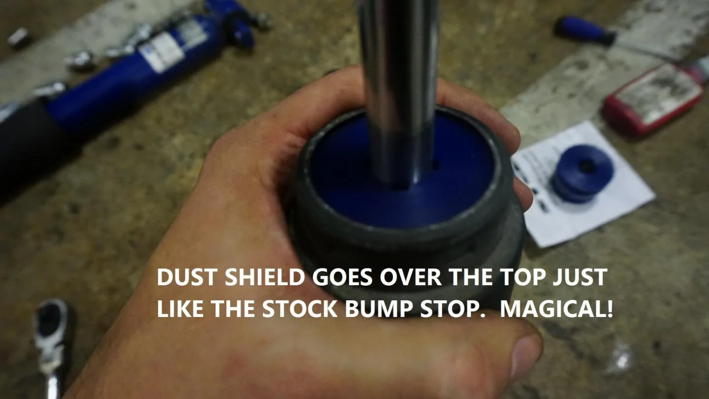

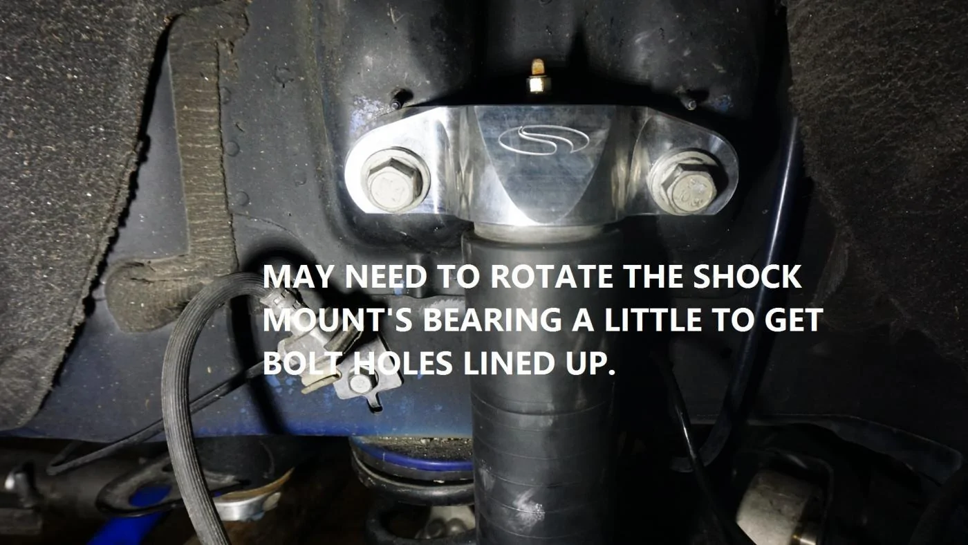

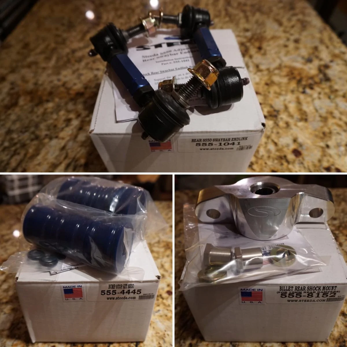

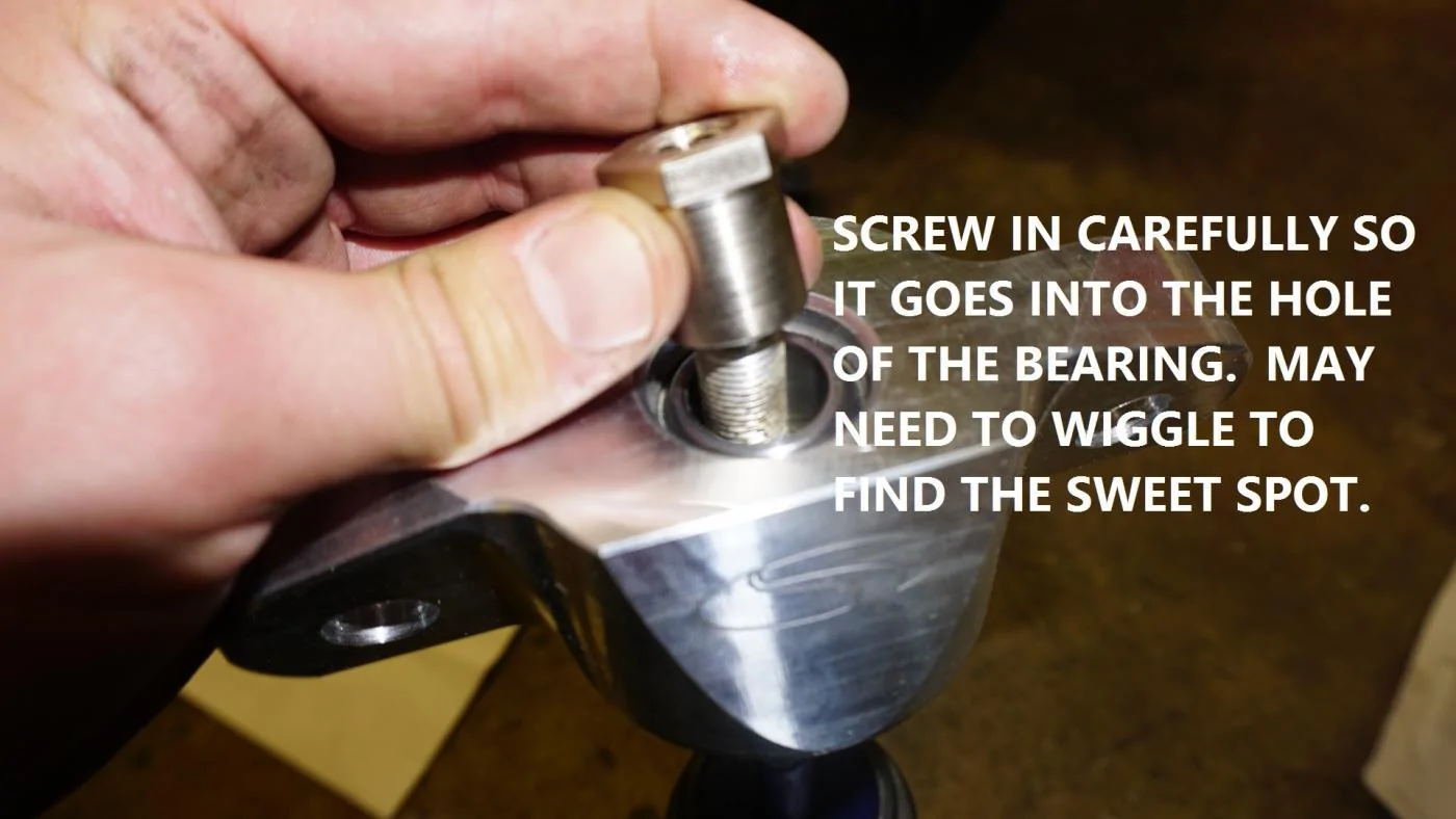

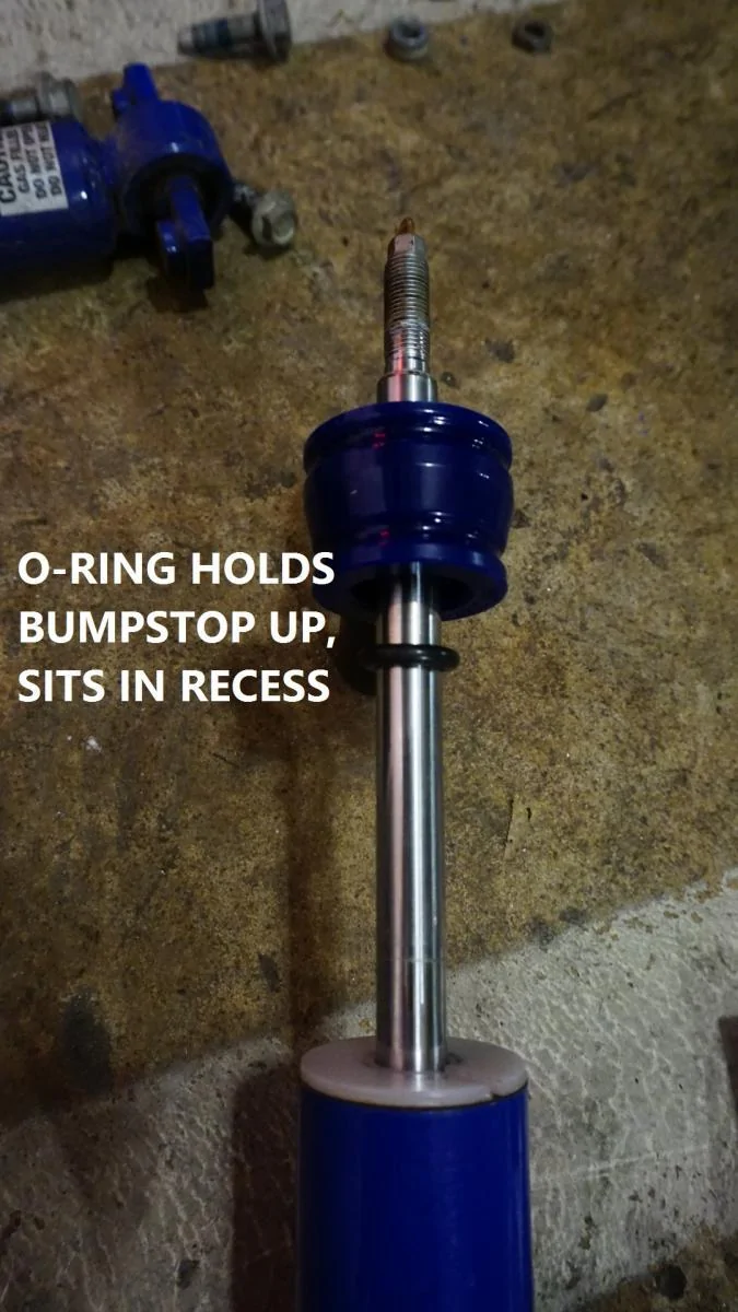

Installed the aforementioned parts tonight. Hardest part was removing and re-installing the stock 900 lbs. wheels that I presently have on (A/S tires for the weather). I've included here some photos of how to "order the bits and pieces" for the shock mounts and bump stop kit.

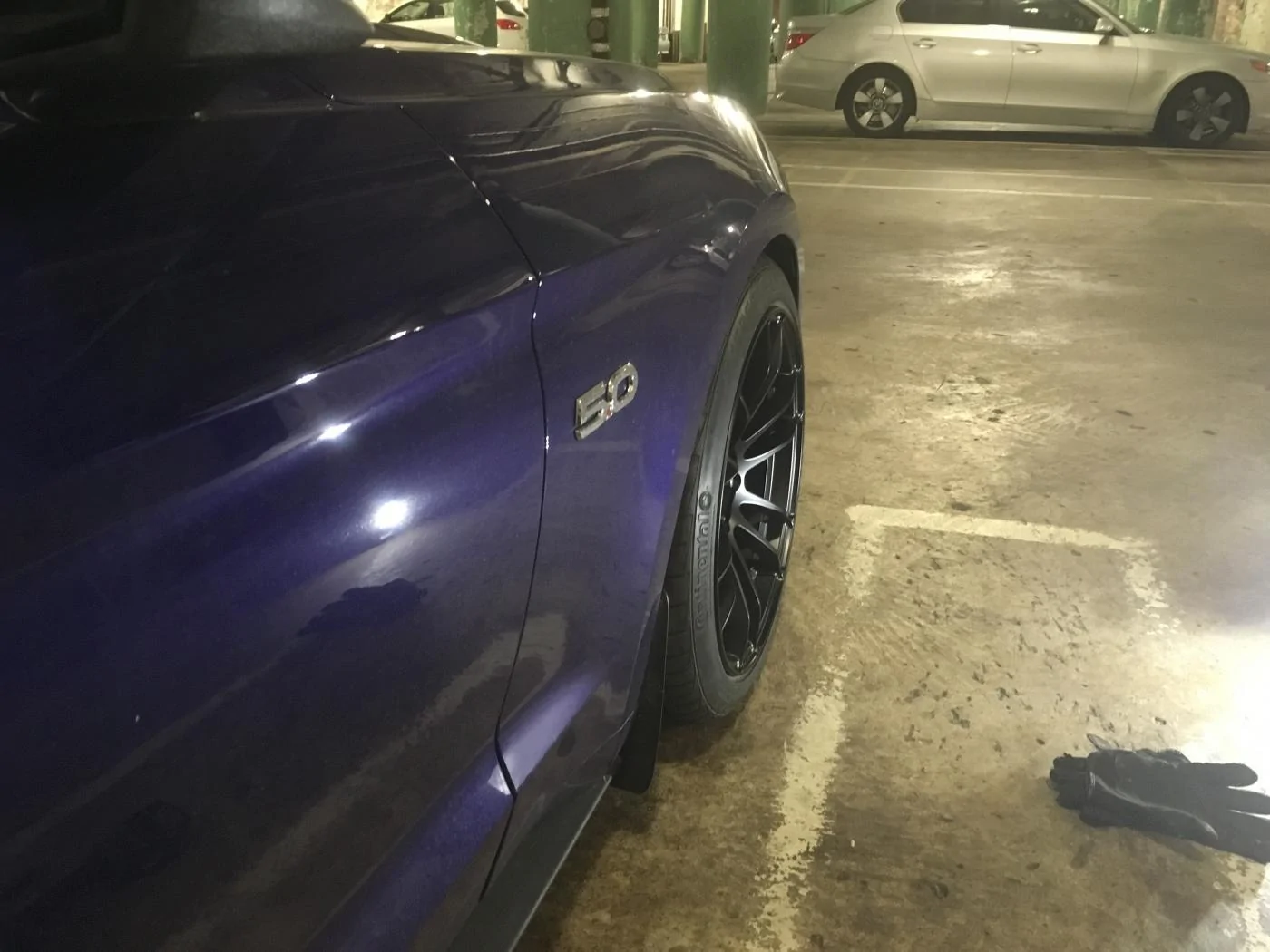

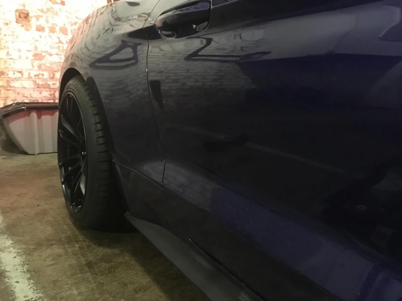

Did some test fitting of my true square track setup:
Wheel: RAYS Gram Light 57xtreme
Sizing: 19x10.5" ET35
Tires: Continental DW - 285/35-19 (will do Bridgestone RE-11s in same size when these die)
Spacers: none required
Front clearance: 4-5mm from nearest point on front strut. A small spacer could be used to get to 295 and 305 tires up front, if I opt to do so in the future (probably not).
Rear clearance: space for days!
I don't have the means to weigh them but they are, by the arm scale, lighter than the stock GTPP wheels by a mile and noticeably lighter than my Project 6GR wheels, too.
Note: photos are with stock camber (they'll be tucked more with the track alignment) and I didn't let the rear of the car settle before taking that picture (sorry) so the wheel gap and tire look goofy. It settles some after moving the car.

So quick review on the Steeda shock mounts. You'd think they are just a stronger unit and that's it. But the slight bounciness I got after installing LCA bearings (common, doesn't matter the brand) is next to gone! I don't know, but maybe the fact there's a spherical bearing in there instead of a sloppy bushing stopped some bounciness? I mean... it's a big difference. Happy with that!

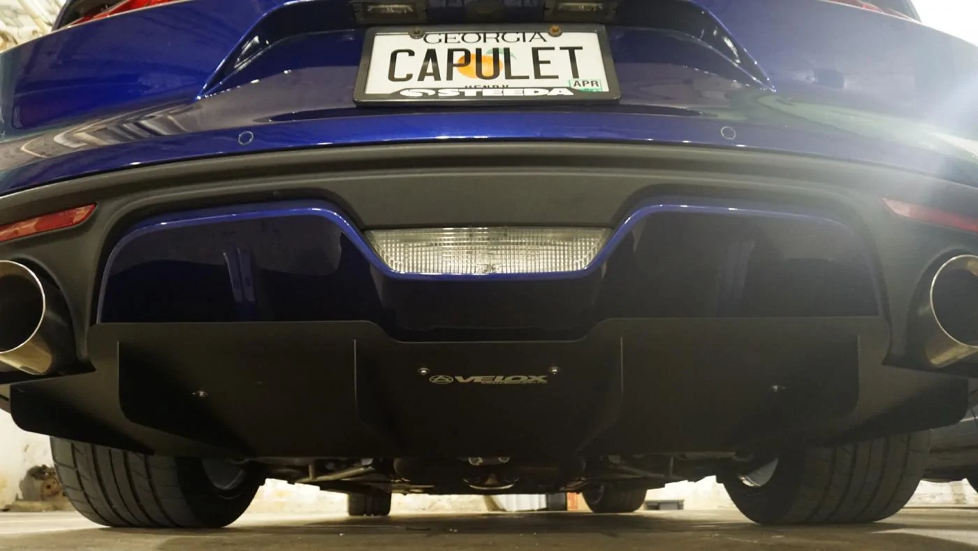

A little sneaky sneak peak at my first aero piece! Very excited. Love it!
Okay, more details:
It's from Velox Motorsports. It's functional... not some show piece. :clap2:
Going to do a photo shoot, write up, so on, so forth. Really, though, this is one piece of kit... it is beautiful IMO.
A trained eye may also notice my Project 6GR wheel's tires (Cooper Zeons) are... on their last breath. Shhhheeeeeeet.
And is that a rusty license plate bolt? DUHFUQ?! Warranty NOW!
