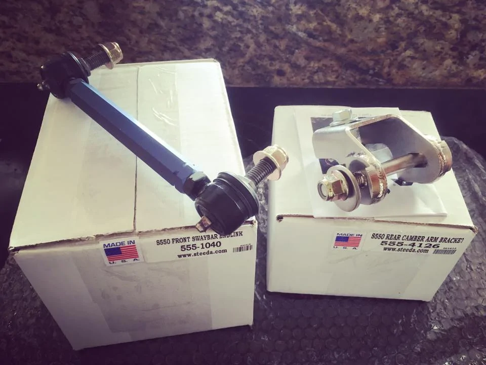

Got a few goodies today in the mail. Steeda's new front adjustable end links (I'll pair in the rear ones as funds permit). Also their new rear camber bracket, which is a pretty trick piece of equipment. Both are extremely beefy!
I'll install the end links this weekend I think. And then at some point I'll get the rears installed and do a sort of corner balance with the end links before I hit a track. For now I'll just eyeball it against the OEM end links thereabouts. Despite track work, I haven't managed to bend my OEM end links. But these Steeda links are vastly more beefy looking... like... vastly. :eyebulge:

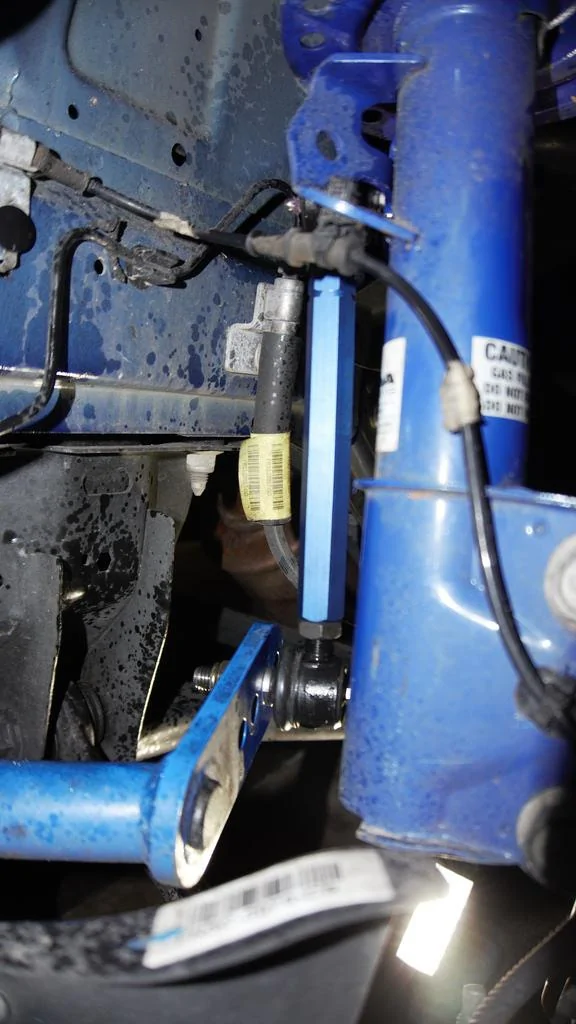

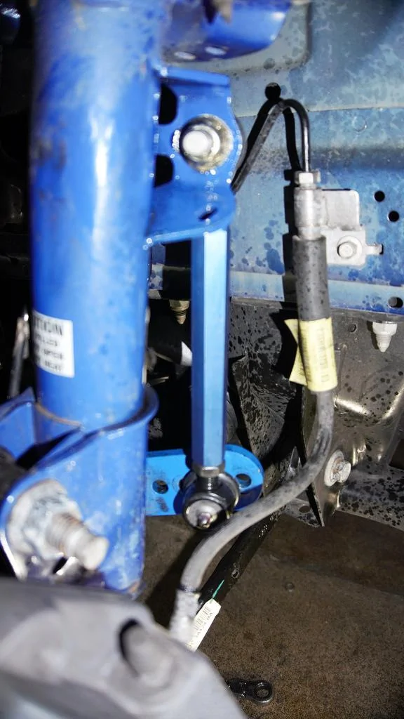

Just installed my Steeda front sway bar end links. For now I just made them the same length as the stock sway bar end links. I'll install the rear ones later - cold outside and people kept wanting to "chat" while I worked on my car... I f'ing hate that. "Leave me aloooone, I'm workin' heeeeerre!" (That or fetch me a beer!)
I'll let the alignment shop fiddle with the adjustments with weight on the car and me in it such that the sway bar is oriented properly and isn't pre-loaded or anything goofy.
The only hard part of installation is removing the nuts that hold the stock sway bar end links on. GAAAAHHHHDDDDD do I hate doing that - takes forever, plus such awkward position to loosen a pretty damn tight nut... PITA! Haha.
Oh, the spots you see are from me spraying some penetrating oil. I'm sure it made no difference in getting the sway bar end link nuts off, but... I say it's good practice.
One more thing... if you're thinking about getting these, please do. But also have a torque wrench that'll get to 76 ft lbs and is relative short since you're working in the wheel well. Please don't hand tighten these nuts and think you got it, then complain about noises. Every time I use a torque wrench on sway bar end links and set torque to spec - no sway bar end link noise. Funny how that works! :)
