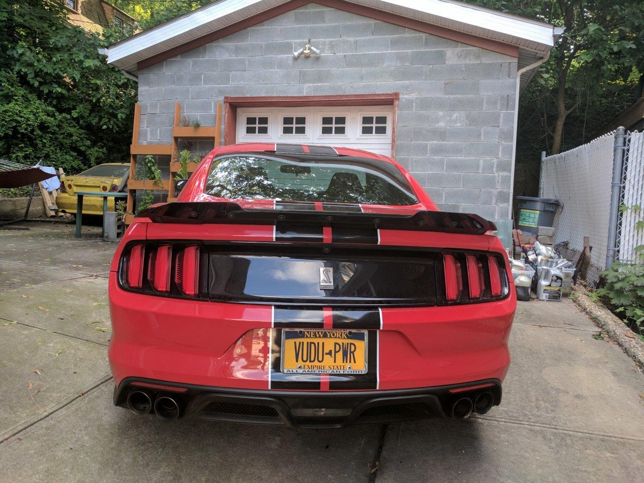

wicker bill for GT350 track pack

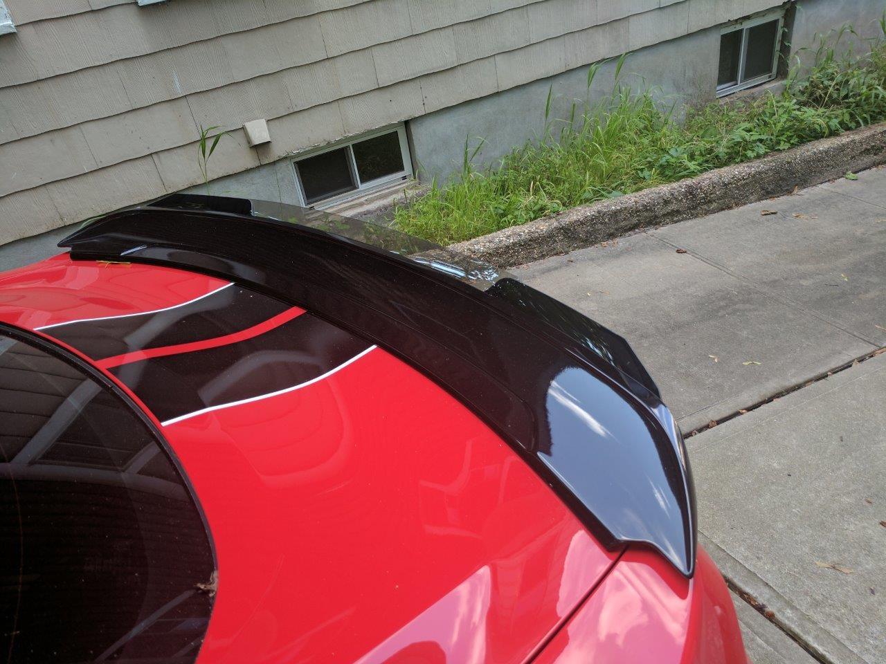

A wicker bill aka gurney flap has been proven to add down force as long as it's minimal. Add too much and it only adds drag.
The oem spoiler is not vertical, it's at a 45 degrees maybe less. So when this piece is added on the change in aero is less than a gurney flap on a flat surface with a more severe angle.

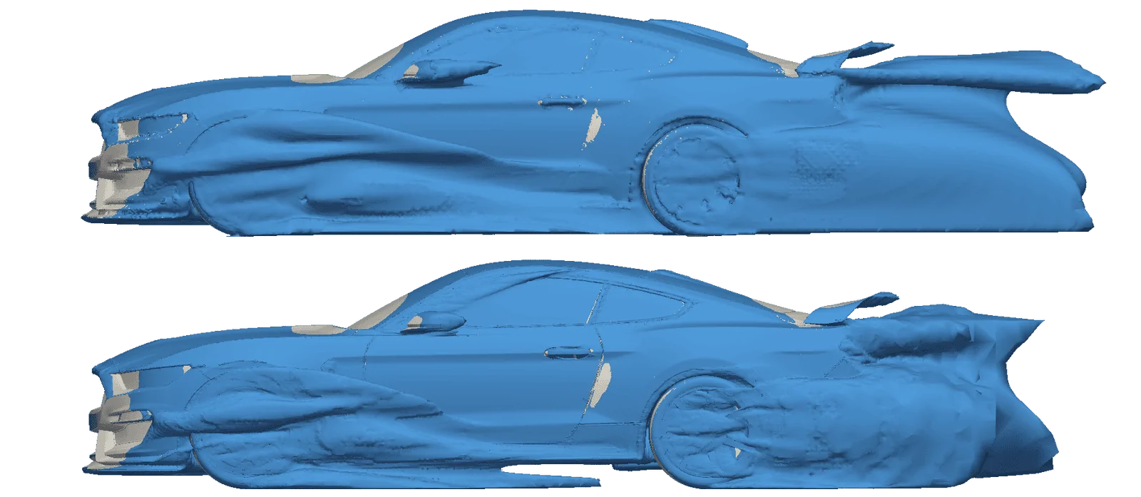

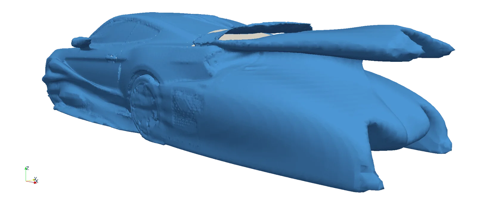

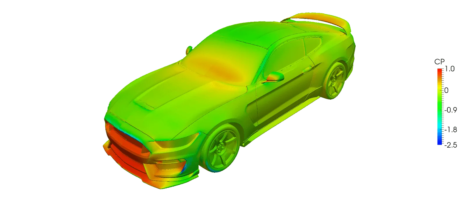

You can see in the link below (at the 4:28 mark) how the airflow is a bit higher than the lip on the decklid at what would be near the extreme top of the Track Pack spoiler.
[ame]
Without any wing vs Track Pack...
R wing...
Another that shows how the R wing is just tall enough to catch the air stream as it flows over the roof ...
[ame]

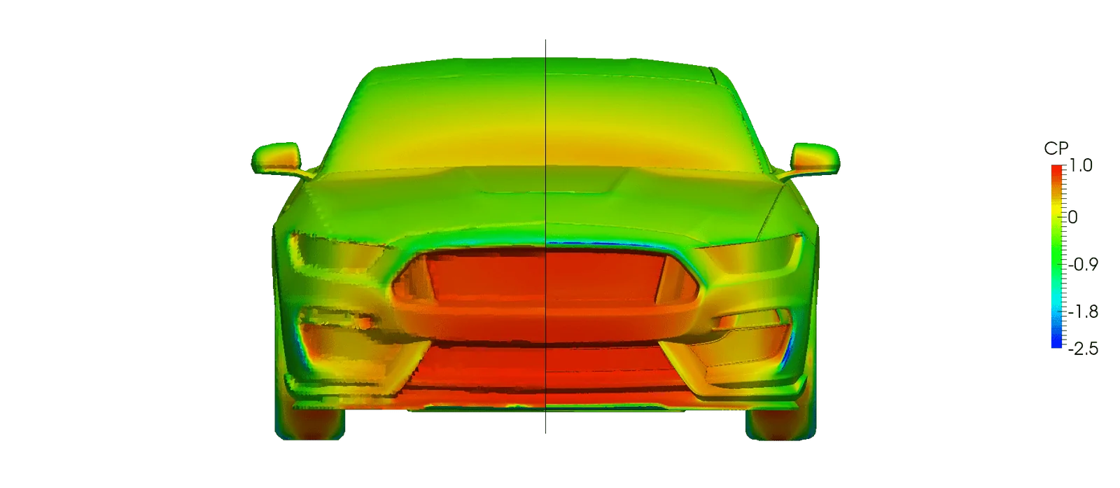

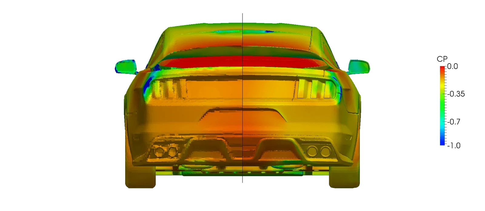

Total pressure shown on an R model simulation
Pressure distribution...
