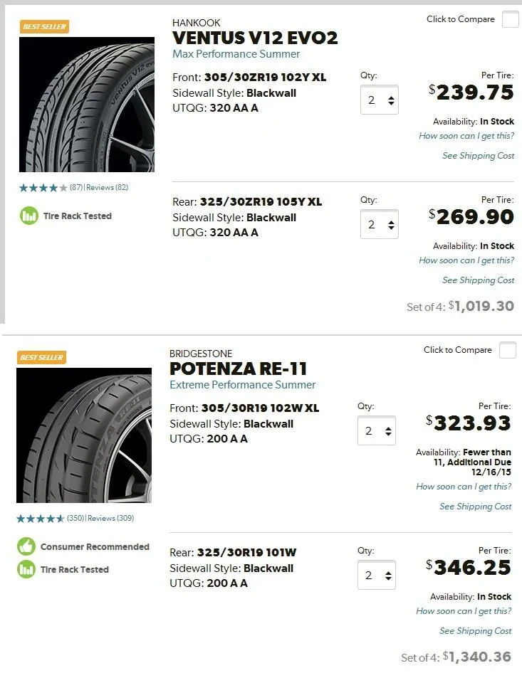

For those of you that have tried the EVO2 hankooks, yes they are worse than the pilot super sports, but would they be better than the OEM pirelli crap that is on the normal GT's with PP?
nastang87xx
Jun 5, 2015
94
6,550
4,170
San Diego, CA
2016 GT350 Track Pack
No.
PZeros are not exactly a bad tire. They're just not worth the $350 - 400 you generally pay per tire. They actually stick rather well but can be finicky at the limit and let go abruptly.
