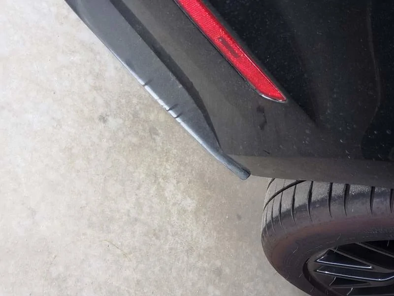

I drive a 2018 Mustang GT PP. I do not go to the track, or have any mods, per se'.
Albeit, I am curious, what is causing these white marks on the skirting of my car.
I did not have this issue on my 2017. Weird...

Likely wax residue. Sticks out really bad on the plastics.

Try some 303 Aerospace Protectant on it?

This explains it! I had my car waxed a few months ago, and that is when I noticed this.
Seems I need to get a wax cleaner of sorts for it.
Great...

If it's the white residue from wax, a great way to remove it from plastic trim is is one of those brown gum erasers... the type sold in school supply section, then top it off with 303.

Thanks all! I have ordered some 303 all purpose cleaner.
Later today, I will grab an eraser. Here’s hoping I can miss all the kids getting school supplies...!?!

Right all, the erasers worked. Then I washed the car, and all looks much better.
