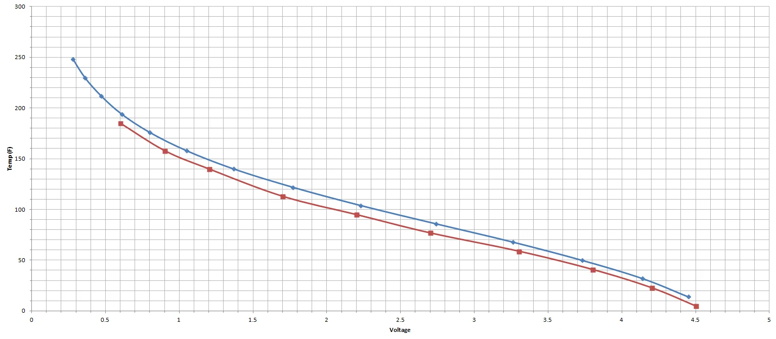

You mind sharing that data in excel or are you just using that picture?
Strangely enough the Whipple tune itself has different values for the voltage conversion.

Here's an excel sheet I just threw together with the data I found. I had to zip it up since the forum doesn't accept excel files. I got the data from the HP Tuners forum in a post about the GT500 temp sensor. If you can see what whipple uses, it might be interesting to compare.
There was something posted in the HP Tuners forum about the whipple values, but from what I understand, those numbers were used as a calculation to determine IAT2 temp from the IAT1 sensor that is pre-intercooler.

Youre good with either one, they are about 5-8* from each other, only really gets massively different at the 250*F + range. I believe the differences have to do with expected heat soak of the sensor in the GT500 versus the 2.9L whipple on the s550.
Ok, well I graphed both and revised my excel file above. Here's a graph of the differences.
I'm hoping the Whipple MCT data is the more accurate one because it would mean my temps are a bit lower than I thought. It's over a 10 degree delta in some areas.

i would use Whipple data, thats my plan.
Still havent figured out how to get this into a formula format to log directly, need to play with the regression formulas

These are the MCT values in my tune, which if I apply a 6 order polynomial, this would be the conversion of volts to temp, its almost spot on (within a few degrees of the entire curve):
y = 0.5715x^6 - 11.332x^5 + 86.098x^4 - 321.58x^3 + 620.13x^2 - 613.95x + 379.24
V °F
0.144999996 302
0.206 275
0.382999986 230
0.497000009 180
0.845000029 152
1.5 126
1.899999976 111
2.5 93
3.799999952 50
4.179999828 32
4.570000172 5
4.900000095 -40

6th order seems way too crazy. Also, your range of temps is way outside what you will see in real world conditions. I think you should concentrate on maximum accuracy in the 50-150F range or so. I took your data and trimmed off the temps above 180 and below 32.
The 3rd order equation I get is:
y = -3.672x^3 + 27.842x^2 - 97.343x + 220.09
With a R² = 0.9988, so it should be pretty accurate in that range.
So, since I got my Whipple data from your HPTuners thread, where did that data come from? Why is your tune different? They are all really close, but your latest curve is way more non-linear than the previous two curves.
