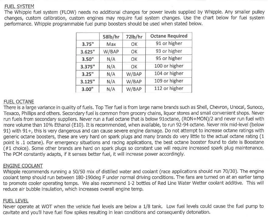

Running stage 2 on Whipple tune -3.75 pulley
Would like to go down a size, maybe 2. Can Whipple tune work with that? How big of an issue will run into running this on 91+boostane to make 93 octane.

In the instructions whipple sends, it says the smallest they recommend on 93 octane with 72lb injectors is the 3.625" Pulley
But to answer your question yes the whipple tune will work for smaller pulleys.

I've used Torco, Boostane, and Octanium to raise octane. They all seem to work about the same which is to say well.
I'd be surprised to find out Boostane is much different from an ingredient perspective.
