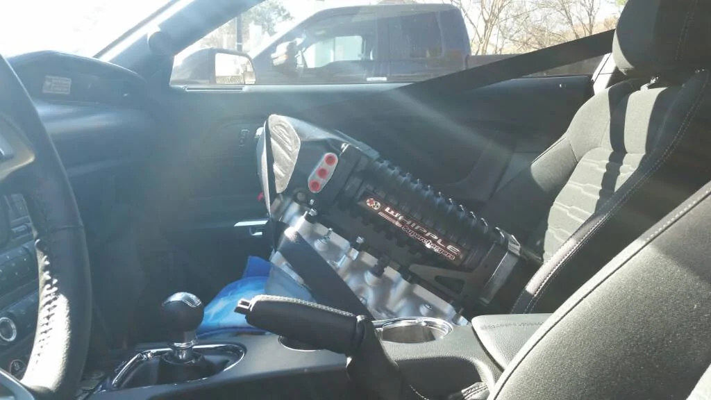

All strapped in and ready to go.....

I told my wife I thought she was in the car with me. She caught the joke. Good thing I'm working all night and staying at my buddy's house!

Now get wrenching Rob. LOL...love that whiney Biach strapped in next to you.
