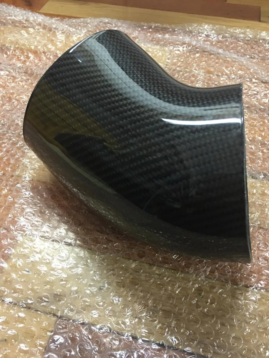

Got some goodies today :0
I will be starting a new build over the next few weeks on my other baby, my 2015 F150. Today I received my Whipple 2.9 F150 Supercharger kit. I am so excited as I will be doing the install at home myself and with the help of my 20 y/o son :) He finished his automotive training at New England Tech earlier this year and has been working at a local Toyota dealer for the past few months. He helped me 5 years ago install a Whipple on my 2005 Mustang GT and I am looking forward to some quality time with him again.
Although I do not regret getting to know the guys at Tasca I honestly regret not installing the Whipple on my car. This will make me feel better lol.
Also received my handheld for the mustang, carbon fiber jack shaft cover, carbon fiber intake tube and fan/pump retrofit harness. Got the harness 90% installed today and sent off my info for calibration. Hope to have it done and off the lift in the next few days and then I'll update everyone :)
