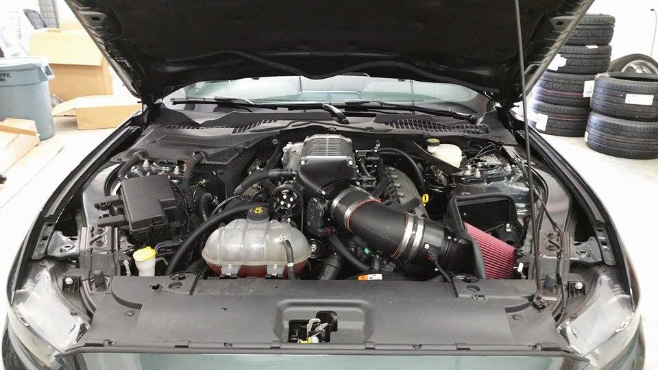

I think my kit shipped yesterday!

Ready for Turrizm to pick up:)

beautiful! any numbers yet?
